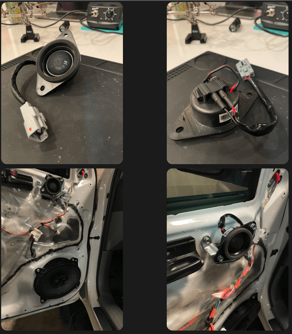

    y'all should man up and learn to solder :)
    subaru kicker tweeters w/ soldered tacoma harness going to female spades (red/black +/- line up as indicated just fine)
    kicker KS 6x9's w/ solder spliced metra harness and metra adapter plate. i did this because the KS series comes with an external crossover that has bare wire leads. open box special $100 from my local best buy lol
    stock harness connections, stock mount points, stock electrical tape, stock everything on the truck. no modifications.
    sounds awesome w/ the stock entune head unit and bluetooth from my phone. everything is much clearer and louder, cymbals and bass and drums are actually distinct and audible individually now instead of being one giant mush of treble and bass. also... am i crazy or did entune previously only go to 50 volume level? mine goes to 60 now...
