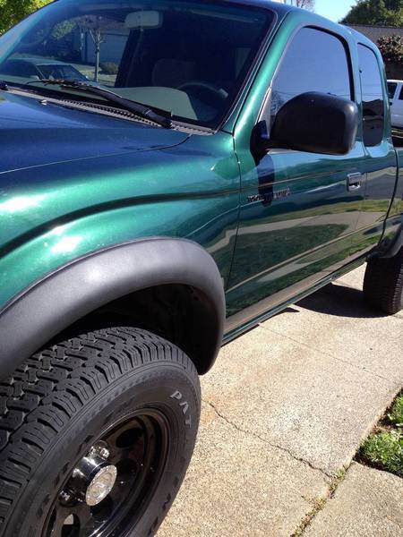

    Random pic the other day, was lookin good in the sun :)
    Need to paint those flares.... Any suggestions?

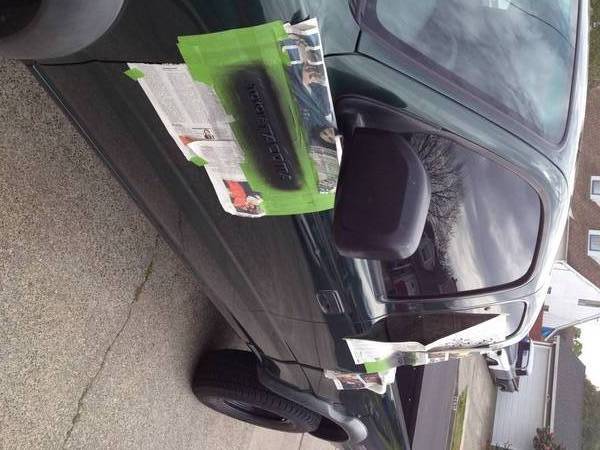

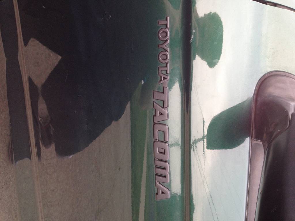

    Painted emblems the other day, or rather I "Plasti-Dipped" them. Worked well on the Tacoma emblem, not on the Trd though. It didn't peel off around the letters like it did with the Tacoma emblem. I'm going to re-do them alittle later and just use a razor around the edges before i peel it off.

    Just orders the 5100/AAL lift. 15x8 wheels and 33x12.50 tires...
    Are those 31x10.50 tires? No lift? Truck looks awesome man. I have the same color first gen. Love the green!

    31s, and no lift! Stock suspension will stay until it needs to be replaced, can't complain with the stock ride. The forest green is the best color on this truck imo

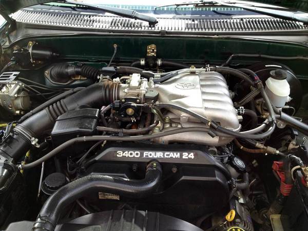

    Haven't posted on the build thread for awhile, so i thought it was time to update it. A clean engine compartment, can't complain about that!

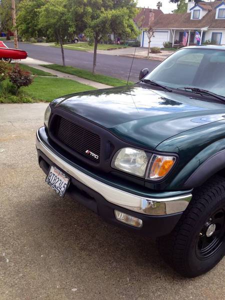

    I also got tired of my grill and the chrome surrounding, so I ordered/installed a powdercoated black billet grill and covered the chrome with the Bedliner in a can.

    Still trying to get rid of most of the chrome.

    Where did u get the TRD logo for your billet grille. Looks good!

    Got the TRD badge from ebay. I searched Amazon and comparable websites, and ebay ended up having the best deal. It was like $11.00 with shipping.

    Looks super clean with that TRD badge, you planning on blacking out the chrome front bumper at all? I did my chrome sections of the front bumper last weekend and it came out really good. I just sanded them 100 grit, primered then painted with Duplicolor flat black, I was skeptical b/c I had never painted over chrome before but it came out pretty good.
