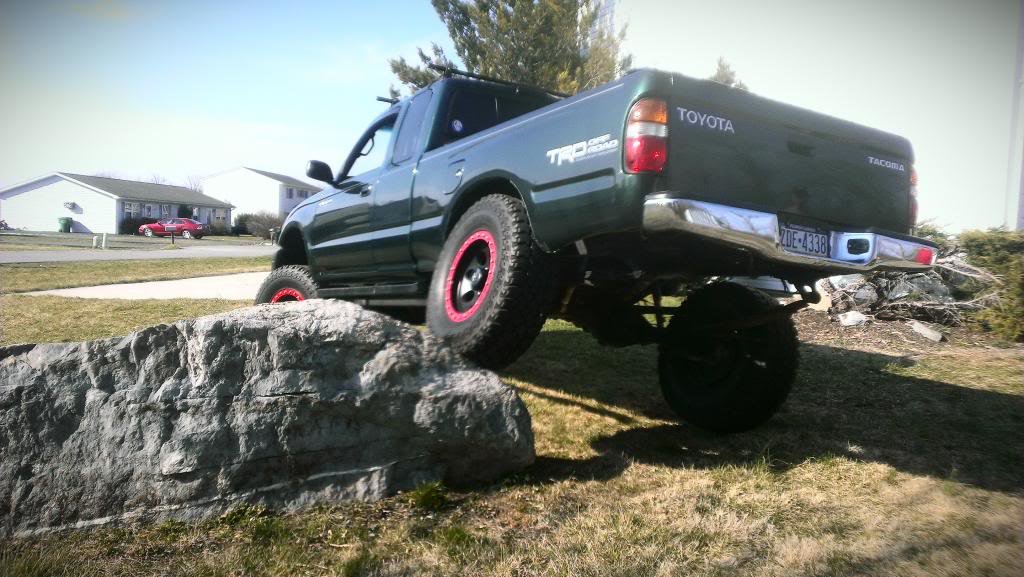

    Did some hauling for my first time today! Truck handled very well with the trailer attatched actually, and had plenty of power. Starting to forget this thing has 167,000 miles on it. But I'm still saying f*$k it and doing the deckplate mod and muffler swap soon! Heads up everyone

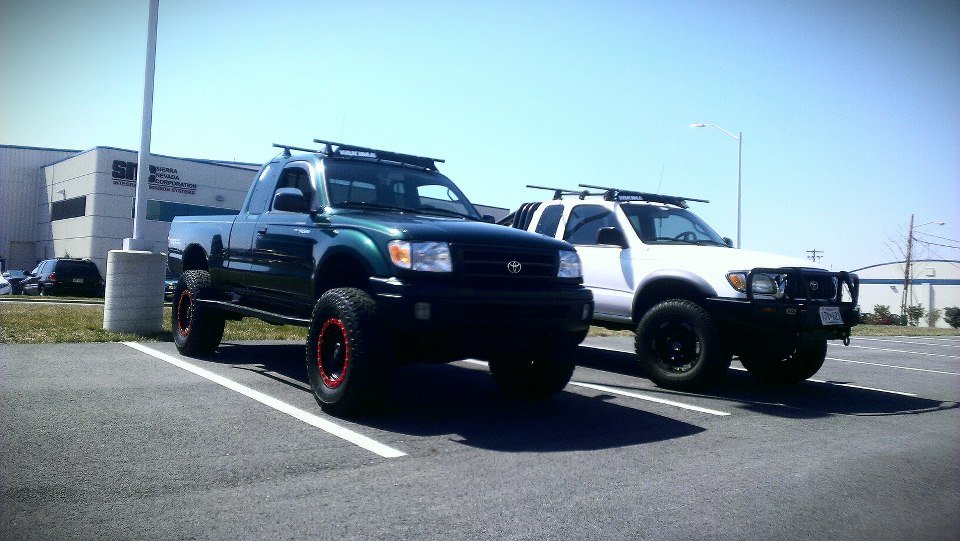

    Love the color, I have it aswell the sun really makes it change one_3fb69e0e9d62308ce41a35f95d55d5be0360609d.jpghref

    AGREED. Green looks way stealth on these trucks

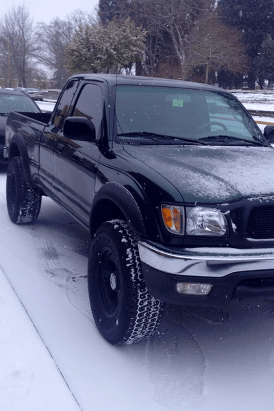

    Took the snowcat out for a little prowl in the snow.

    Where did you get your grill?

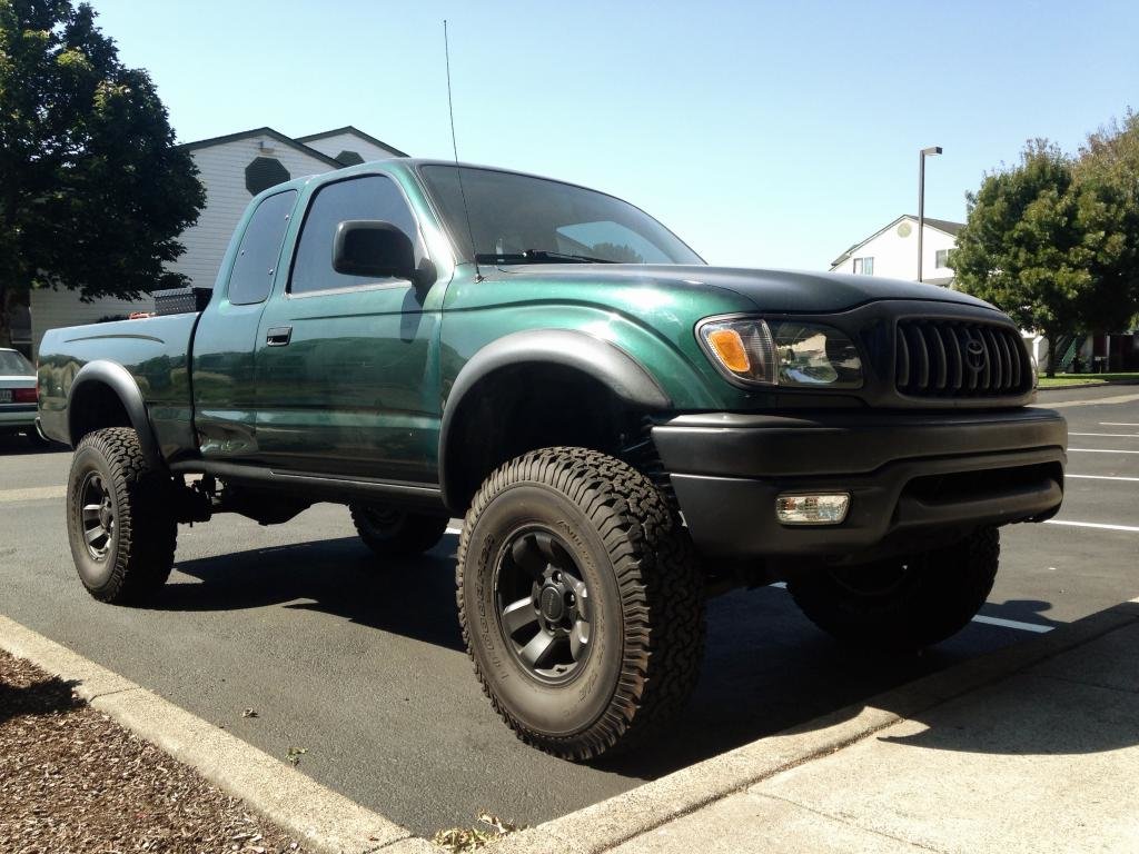

    Haven't updated anything in a loooong time! Thought I've completed enough mods by now to have a few things to update with, so I'll just throw some pictures up let me know what ya'll think!
    Somebody hit my passenger side while I was at work, so Insurance cleaned it up for me! Actually worked for my benefit considering I had a bunch of scratches on that side to begin with! Here is after I got it out of the shop, looks pretty good in my opinion.

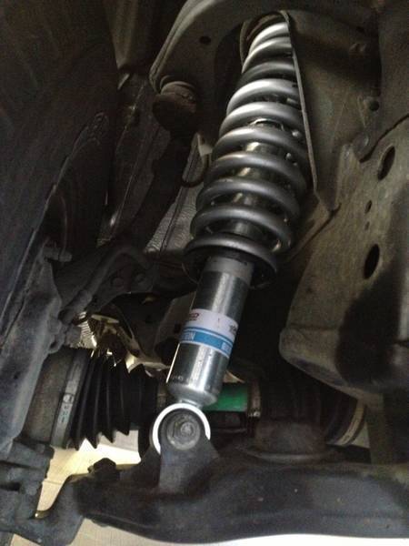

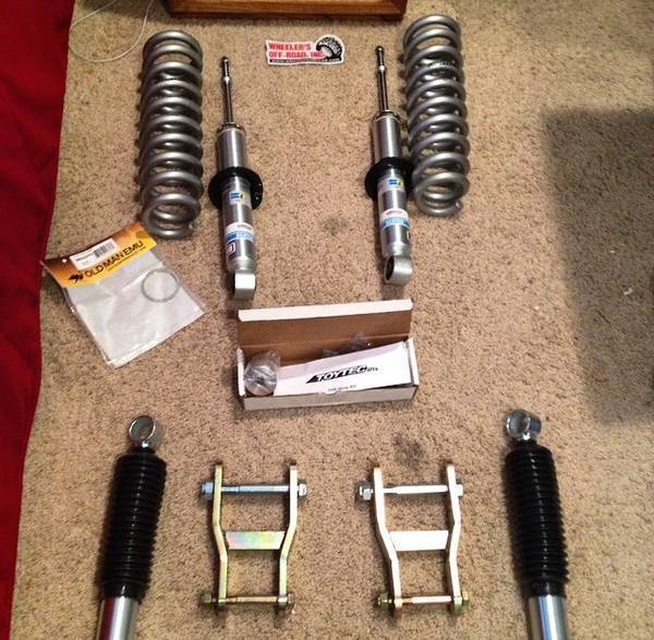

    This is what I ordered from Wheeler's Offroad! 3 inch lift, including ride-height adjustable Bilstein 5100s in the front and back, and Eibach coils up front as well. Adjustable shackles in the back, set at 1.5, finish off the lift. (Also has the differential drop installed, cv axles are at a fine angle in my judgement.)

    Sick truck, I'm in Eugene with nearly the same one haha
    Jealous of your grill...

    Thanks man i appreciate it! I dig your truck too, theyre like long lost twins. You don't like the way your setup rides tho?

    It isn't bad, just rides like a lifted truck. What bothers me more is the taco lean because I didn't add the trim packer...but rather than taking it all apart just to level it I'm gonna wait until I get some co's. It rides way better than stock, and the dakars are nice

    Yeah it definitely rides like a lifted truck, but like you said, it's way better than stock. My taco lean isn't very noticeable to me, maybe because my new suspension doesn't have many miles on it yet. But isn't the setup you're running already a coilover?(i.e co's)

    The 5100/Eibach combo is technically a strut with 3 height settings IIRC. By coilovers I mean something with fully adjustable threading (King/Fox/Icon/etc)
    Same lift in front as you, tires are 33x10.5x15 and 1.25" spidertrax all around. The only trimming needed was at the back of front fender wells a bit.
    The Dakars gave me like 2.25" of lift in back, not sure how much the AAL provides but you'll probably be rocking a very slight bro lean. A lot of guys run that combo on here, I'm sure you'll be able to find some pics. Looks good IMO
