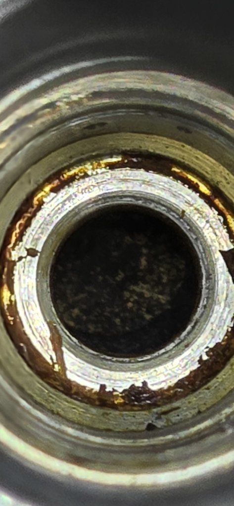

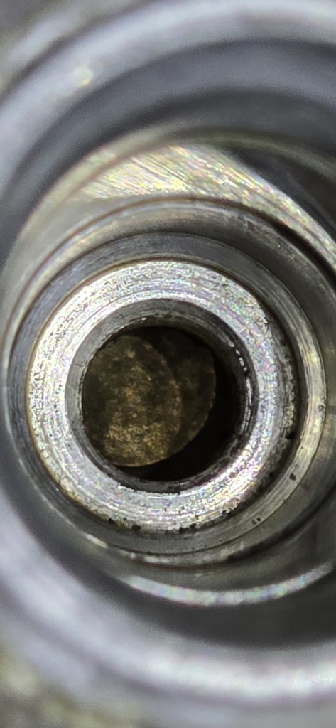

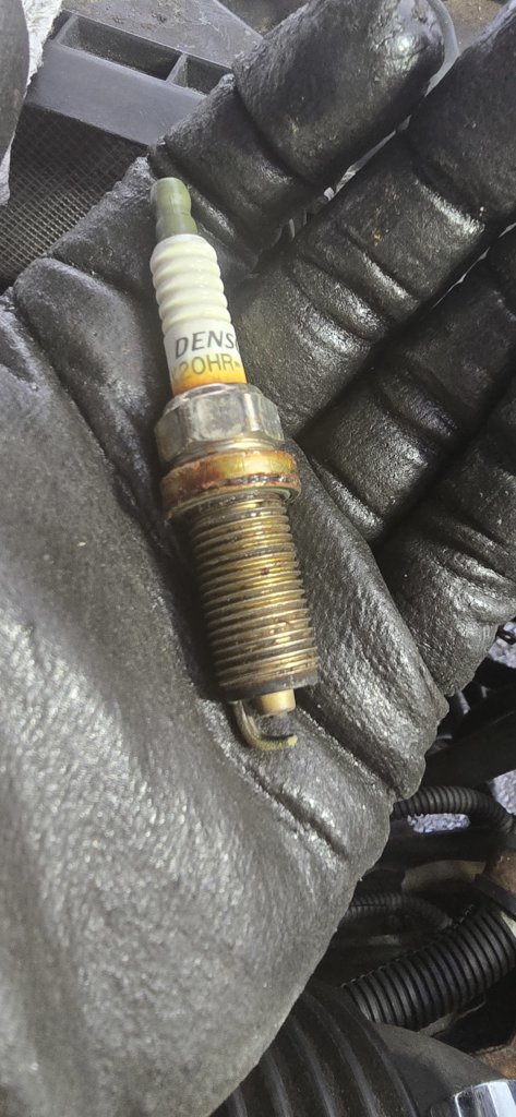

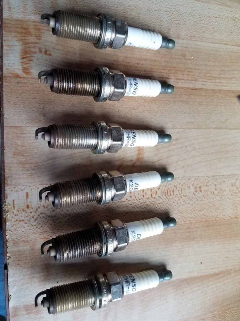

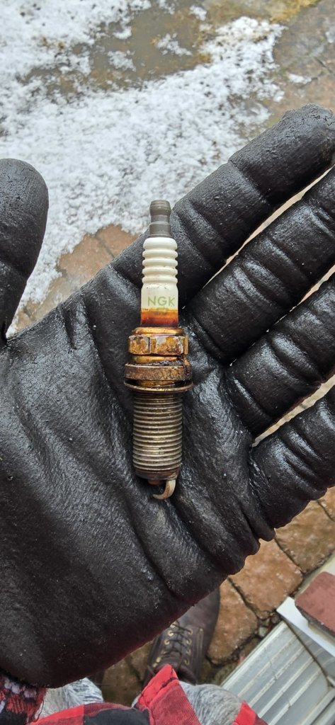

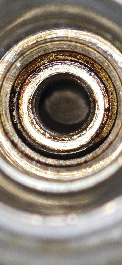

    20250305_123029.jpg 20250305_123942.jpg 20250305_132441.jpg 20250305_132025.jpg 20250305_124240.jpg Hi. I recently got my first truck/Taco and I've been doing all the DIY maintenance to make sure she's up to date on everything and today I changed the spark plugs.
    From what I've gathered, for some obscure reason, Toyota puts three NGKs and three Densos in their V6s at the factory which leads me to believe that the previous owner never changed them. The first one I pulled out was all gunked up with what I believe is oil? Im relatively new to car maintenance beyond a basic oil change so I dont know if this is harmless or indicative of an issue. Two of the SPs were gunked up but the rest were fine. Any feedback would be greatly appreciated.
    Also, there seems to be a fair amount of carbon built up on the cylinder heads but again, Im not experienced enough to know for sure

    For 181k miles the Denso looks like what I'd expect. On the NGK, it's hard to tell if that is rust or dried oil on the plugs' hex and shoulder, otherwise, it looks normal for the age. There is a seal in the valve cover in that area and it may be leaking. Did they come out easy? With aluminum heads, if there's any resistance upon removal I spray a penetrating oil down the hole and work the plug out slowly turning in and out until it loosens up.

    The Denso yes. Barely harder than the other 4 clean ones. The NGK was very hard to break loose though

    Then I assume you have all the new plugs installed and you didn't strip the threads in the head on the NGK one. In the future, remember aluminum heads are easy to strip the threads. Spraying penetrating oil down the hole and letting it set for a bit, then working the plug in and out loosens up the carbon buildup on the plug threads minimizing the threads in the head from striping. So far it hasn't failed me.

    For the mileage and time they've been in there, they really don't look too bad, even the oil.
    Put the new ones in and drive it. If you're not getting any misfires, you're fine.
    I've seen them wetter.

    No, don't gap and go. The electrode is too far eroded for that. At this mileage the valve cover gasket hardens and is likely the cause of the wetter plugs. Most folks know to get an oil change. Many have little clue as to other services; they address them as things break.

    It is a common "feature" and AFAIK ran through, and to the end of, the entire 2nd gen 4.0L V6 production in 2015. When I pulled my plugs at around 120,000 they were all Denso plugs (K20HR-U11) which turned out to have been in there for about 115,000 miles according to service records. see pic:
