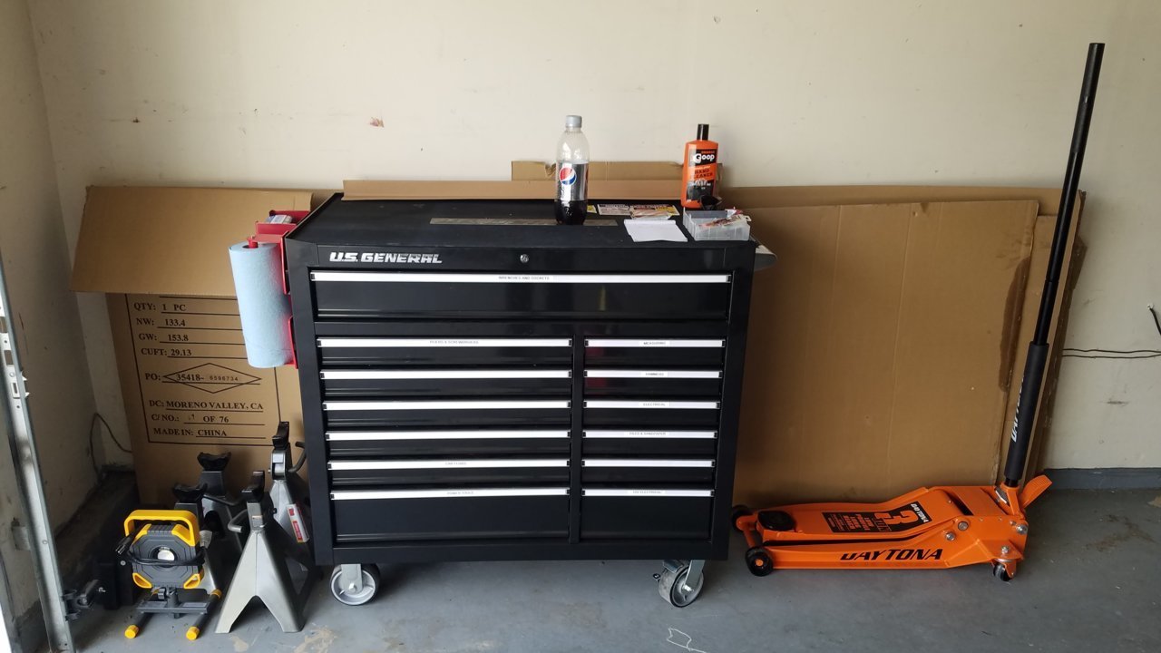

    Hey that's the sawzall I have too!
    I've got a pair of Craftsman jack stands you're welcome to use. Unless you need the excuse to buy yourself some jack stands, in which case I'll tell you you can't use mine.
    Gunshot-6A[OP] likes this.

    Considering everything is sold out, I'll take you up on that jackstand offer.
    I do need new ones anyway but this will help solve the immediate problem. Desert race last weekend knocked my alignment even farther out on the pax side.

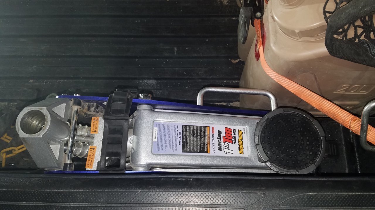

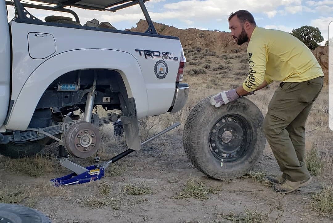

    reading back through this little write up you did. Curious what jack you used and how you mount it in the rig, want to do this myself. Any more info would be killer :headbang:

    1.5 ton race jack from HF. Should be like 55-60 bucks.
    For mounting I used a quick fist around the front roller wheel thing, and then a quickfist XL that wraps around the body right by the swing arm pivot.
    Handle halves, I mounted a pair of quickfists to some aluminum and mounted them off the passenger side bed track.

    Are the quick fists for the jack mounted directly to the bedside fenderwell? How’s it hold up off road? Any play or rattling?

    yeah, 1/4 inch hardware with a nylock and large fender washer in the wheel well above the splashguard. That was the hardest part of the install since you have to jam your hand in this really tight area :rolleyes: and that plastic liner is razor sharp.
    Been on for 2 years now and hasn't given me a single issue. It does wobble a little side to side if I really force it, but solid on the daily. It can make some noise as it hits the bedside, but thats why i moved the side handle to the inboard side.

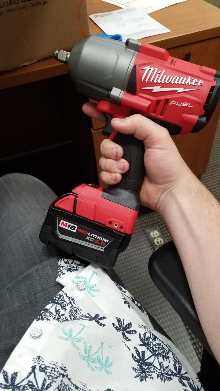

    Its so handy to have in the back. Add an impact gun in the cab and you can do tire changes in no time flat.

    For home duty, I have the HF 3 ton low profile long reach. Thing is a beast!
