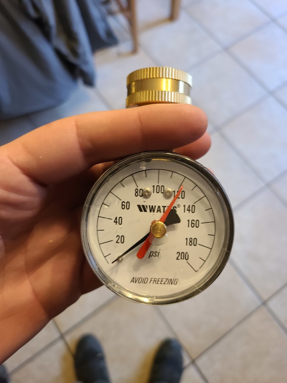

    Well...no wonder the pipes knock

    TIme for a prv valve. Should be under 80lbs max.

    It has a PRV valve. Looks like the diaphram went out on it since no matter how far in either direction I screw the adjuster, it doesnt change.
    Ugh... :spending:

    I’m on my 4th PRV valve in almost 15 years. Last one was on Memorial Day. That sucked.

    I have a feelijg this has been bad for a while based on symptoms. I just have the data to back it up now. Calling a plumber on Monday and Ill get it sorted.
    Who'd you have do yours? I have no idea what it'll cost to replace either and Im kinda afraid to know.

    The first two times was a plumber that did it as a side job. The third time was the water softener tech, this one wasn’t cool. The last time I will have to look up. It was Memorial Day, so options were limited. I’ll check Quicken tomorrow and report back.

    I had do mine a couple years ago, they did a great job - I’ll try to dig up the info on who did it. I had them install a ball valve for the shutoff while they were in there.

    Beehive Plumbing is who used. It took plumber all of the guy all of 10 to 15 minutes. They made a killing of this installation. I’m thinking about starting a company that does nothing but PRV valves and water heaters.
    He had a Milwaukee tubing cutter and some type of a (I think) Milwaukee compression tool that crushed the copper fitting onto the copper pipe. Apparently, soldering is a thing is the past.

    Back in action! Plumber friend of a friend came by and got me squared away for a fair price, esp on a Sunday.
    Turns out when your water pressure is correct, all the noise in the pipes goes away!

    Where the hell did he get a PRV on a Sunday? :notsure:

    You can get em at home depot.

    Yeah, its a watts model, so a reputable plumbing supply brand

    I will bet it will need to be replaced with in 3 to 5 years. I have come to believe company's will not make anything that lasts longer, if it does you got lucky or don't use it regularly. Every fixture I have replaced with a home depot part, electrical or plumbing has all failed with in that window.
