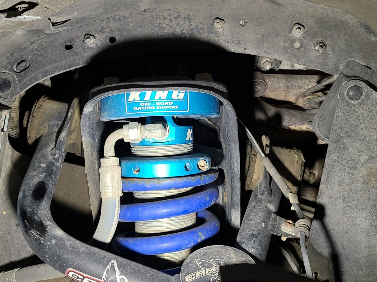

    So even after fixing the skid plate, theres been a front end clunk thats been driving me crazy.
    Turns out, if your driver side UCA nut backs off 2 full turns, it makes a noise :eek:
