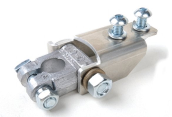

    Well, after replacing it on Sunday, it appears the intermittent non-start issue was some sort of developing defect in the battery. Cranks strong as ever, every time, now. My suspicion (that I've read is a possibility) is the terminal becomes separated from the battery plate internally. Makes sense then that twisting the terminal a little bit would often solve the issue.
    :fingerscrossed: *now that I've said that out loud.

    Swapping terminals next since if I just wiggle the positive, it fixes the issue.

    Bad positive terminal connection? pftsh. that's such a niche.

    Yeah, it's a slee mount (old style) so it has a few connection points. I have the terminal piece that touches the battery but the secondary shoe piece is no longer in production so I'm hoping just swapping terminal and hardware fixes the issue.
