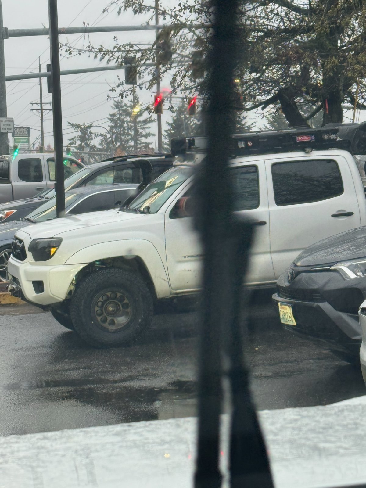

    New shoes put on today! Went with Falken Wildpeak AT3Ws this time. Stuck with 265/75R16 E rated cuz I hate saving gas money here in WA for some reason. 103.8K miles on the clock for reference.

    Half ass pic cuz Im not standing out in that atmospheric river of bullshit rain.

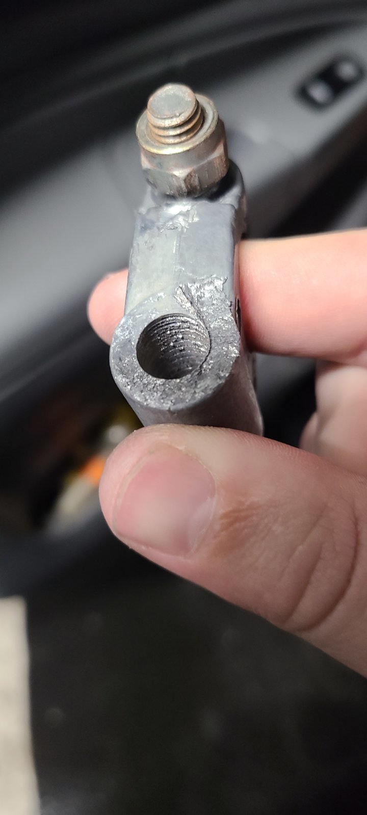

    Had another occurence of my no-start gremlin. Pulled the terminal and swapped in a new one and found this where it met the extension. Looks like the small amount of arc caused the eventual erosion of the terminal causing more resistance and a poorer connection.
    I'll check it when I go to work in the AM but just at idle, scanguage already showed a 0.4v drop (13.6 vs 14.0)

    damn gremlins. just when you thought you had it figured out.

    Its worked great the last few months since the new battery. First time Ive had an issue in months.
