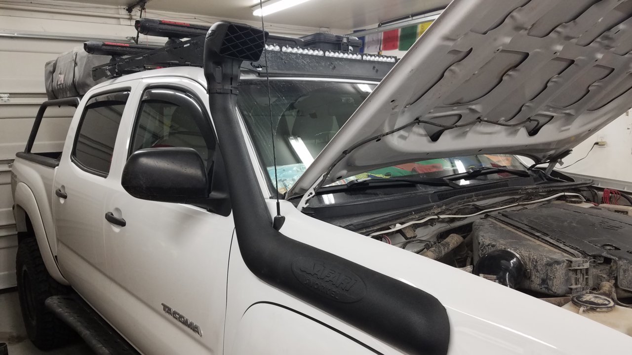

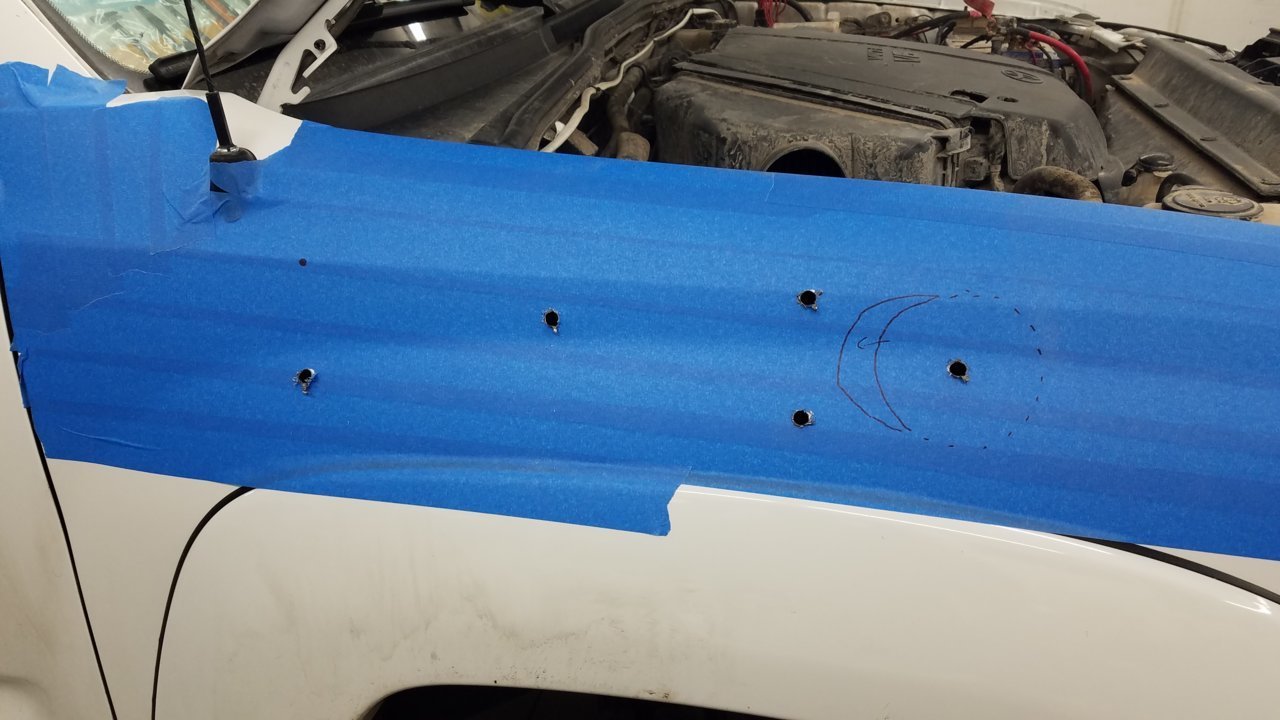

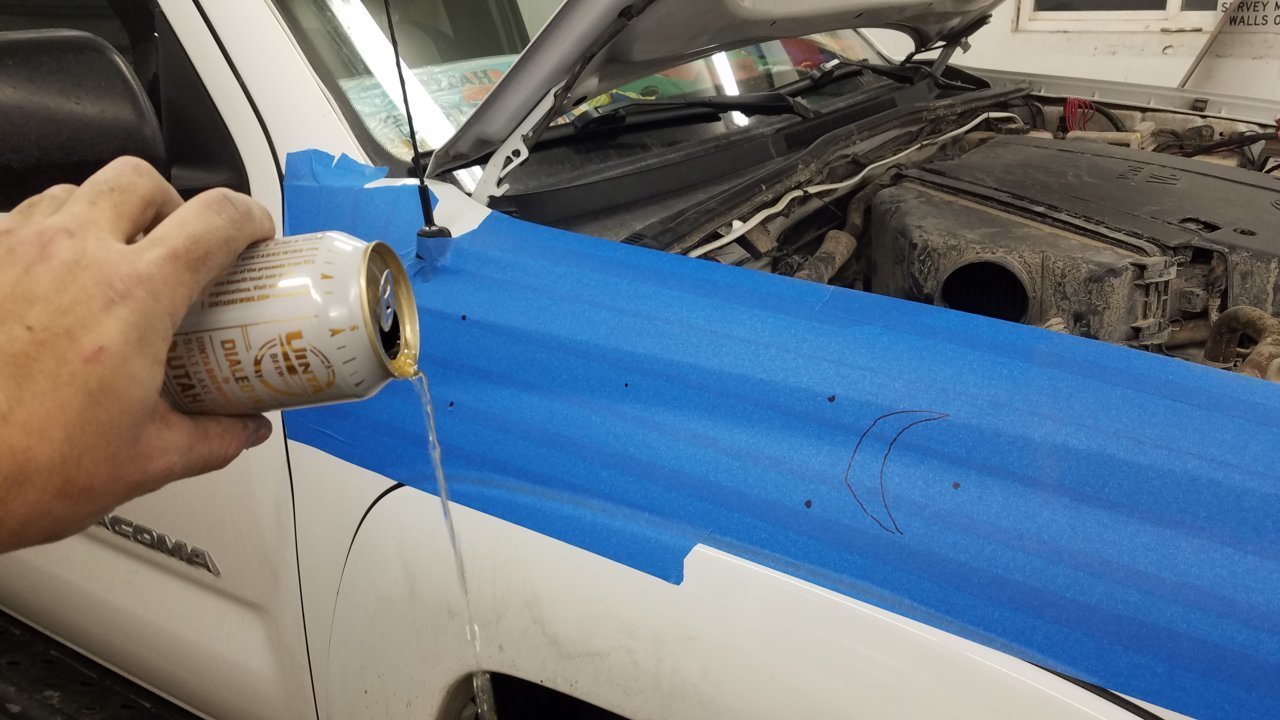

    Installed the hilux snorkel kit adapted for the tacoma from Cruiser Outfitters last night. What an ordeal both physically and emotionally.
    Definitely get a buddy for this project. Makes a few of the tasks just a little easier. Helps to have him drill your life altering hole in the fender too. I did not have a buddy this go around.
    The instructions say install time of 4-6 hours. I laughed. :laughing: I started at 5pm and was done at 1230am :bananadead:
    When you drill all the holes and go to install it, keep in mind it was not meant for this vehicle. It will not cleanly sit on the fender, you will doubt yourself. Then when you bolt it up, it all kind of sucks in and looks good. You def breathe a sigh of relief when its over.
    Shoutout to @Nimble9 , @geekhouse23 , and @GARSHA91 for giving some sound advice pre-install and a little extra motivation. :cheers:
