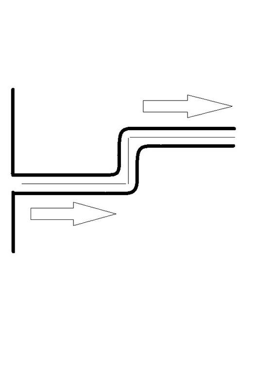

    On a semi related topic, there is a sharp curve in the road that I live on and when I have my heat on and I go around that curve, it gets cold in my truck...its very weird, is this something that has ever happened to you when going around a sharp curve? The curve is drawn out below and it only happens when I am going the direction of the stated arrows. Don't hate my Paint skills!

    Just had this EXACT same thing happen on my 2006 4.0. The water pump went bad. It had a leak, and made this exact same noise. It Is from having air in the coolant system. Mine was because my coolant had leaked out of the pump, therefore air took its place in the system. The reason the sound goes away after it warms up is because the pressure/coolant expands with heat forcing the air out and is pressurized with hot coolant.
    Also, you get a "puff" of cold air when turning because the hot coolant goes to one side and it blows the coolness (lack of hot coolant) through rather than the heat.
