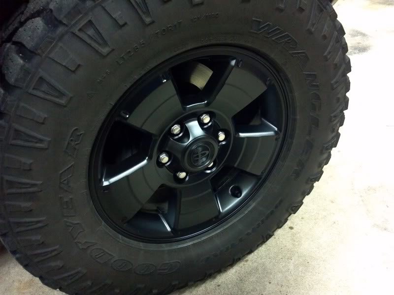

    Hey man how did you paint the rims. thats a good way to keep your rims without buying blacks xd's?

    Hey Danny...just scuffed them real good, cleaned them up, and sprayed them with Rustoleum Satin Black. It's all about the prep! Take your time and they'll come out great.
    Do some peeking around here...there are lots of detailed write-ups on painting stock wheels.

    Today was wheel touch-up day. A little time masking and a quick spray and they were back looking like new again. They didn't look "bad" but had a few scrapes and chips.
