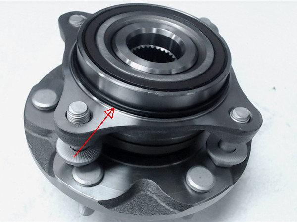

    New black "grease cap" on the hub as it's 50/50 you'll mangle the existing one chiseling it off the first time doing the job :laughing:
    New cotter pin for the axle nut (dealer or local auto parts / tractor supply store).
    There's a rubber O-ring between the bearing housing and the knuckle. It's easy to replace. A new O-ring is often included with the hub/bearing assembly:
    There's a seal on the back side of the knuckle interfacing with a mating seal on the CV joint. These are dynamic seals. Replacing either of these seals increases the job time by a factor of 2-3, requiring you to pull the knuckle away from the CV axle. Installing the seals are also a pain because they are large-diameter and thin section, so easy to mangle. I would visually inspect the seals and leave them in unless you find tears or chunks missing. Put some grease on the rubber mating surfaces, to reduce wear as the CV axle turns.

    My bearing (~$60) came with a new O-ring.
    I re-used the CV dust seals still on the truck because I felt like quickly replacing the worn bearing, and not turning the job into an all day affair
