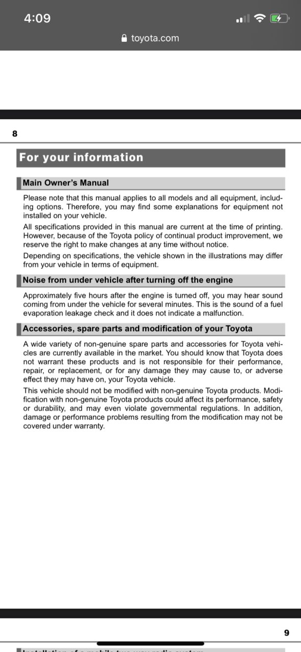

    Hey guys,
    So every now and then my truck (2018 trd sport 4dr) a humming sound in the gas tank area on underside of the truck. Ive only noticed it when it’s completely silent. This has only been noticed when I’m in the garage working. It just starts up and runs for...I don’t know, it’s been on for about 5 min now and still is. The truck is completely off. No key even near it. It sounds like the fuel pump circulating the fuel. What’s going on here?

    No worries, it’s normal. Even says so in the owners manual.

    It’s a fuel Evap leak test the truck performs.

    Depending on when certain criteria are met, (ambient air, time since engine off, etc) the truck will pull a vacuum on the gas tank to detect any EVAP leaks. The humming u hear is the little vacuum pump by the tank.
