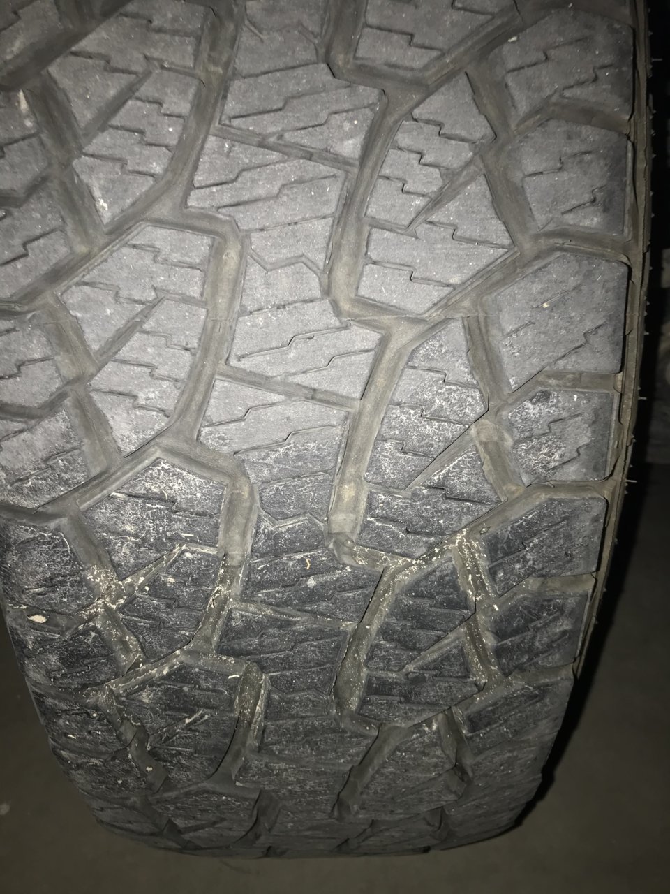

    I dont know man. The duratracs were made with a pretty soft rubber compound too, my previous truck sat the same way at work's parking lot. The rubber looked amazing. My buddys KO2s look perfect and he drives it on weekends only.
    Also, why would BFG buy back the tires? They would be the first ones to tell me to go fk myself if thats perfectly normal.
    My duratracs after 1.5 years, look brand new.

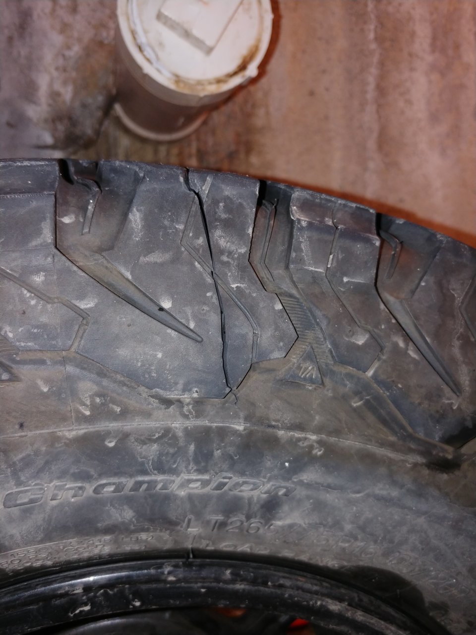

    I have never seen this on any of my tires before. If these tires were 3-4 years old, maybe. But imo, this is not right.

    I've seen cracks like that on tires that were 5-6 years old. Never on anything 2-3 years old. That said I don't think it is a problem. It is when they start showing cracks on the sidewall that they become dangerous. Check the date code. They may have been 3-4 years old when you bought them.
    Junkhead[OP] likes this.

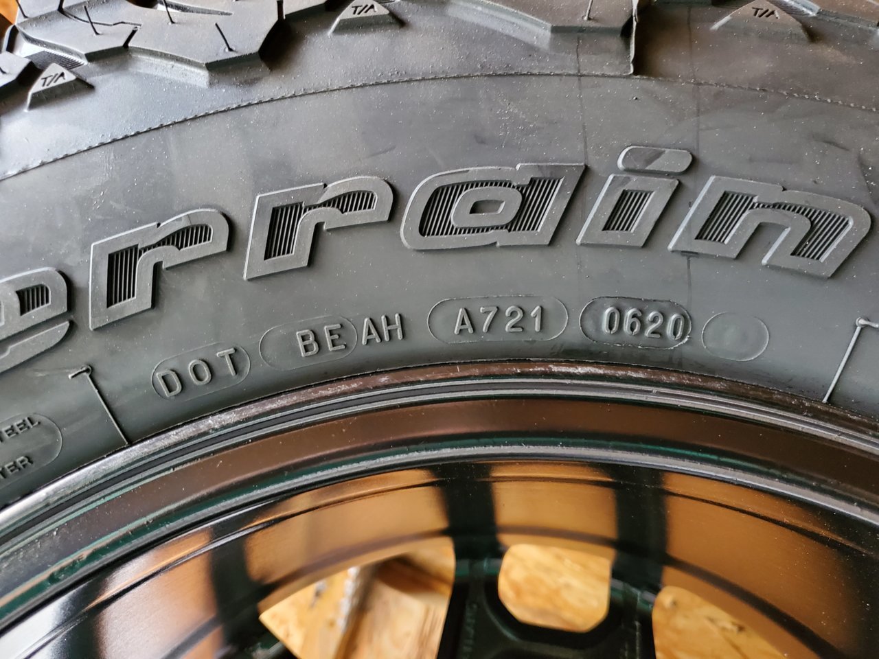

    I just purchased a KO2 for my spare, size 265/70R17 C load. The first seller would not provide the DOT code. Second seller I purchased from was willing. The full DOT code is only on one side.20200715_091215.jpg
    I was happy to get a new, never mounted C load KO2 to go with the 4 I purchased in June.
