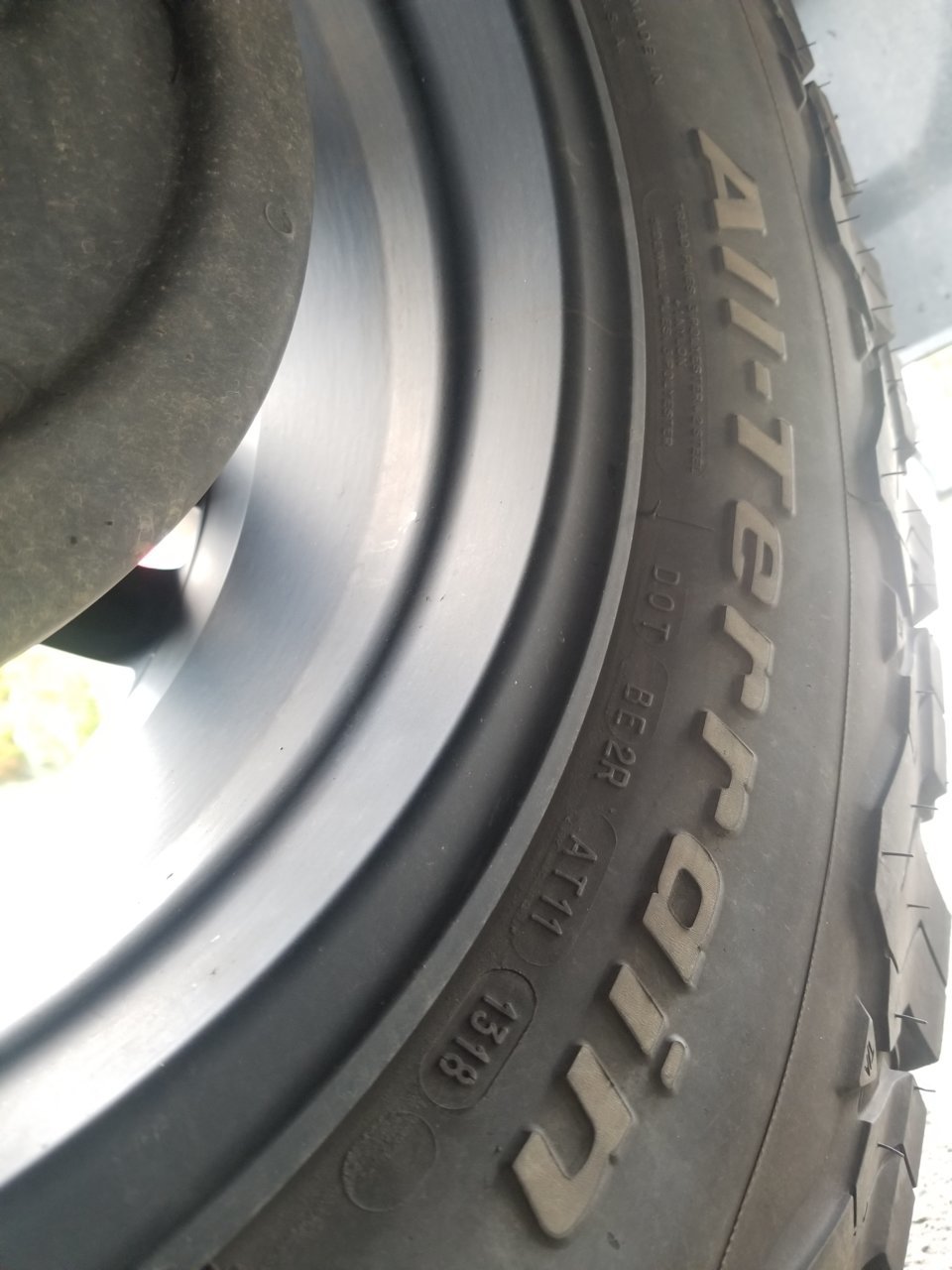

    So just checked this morning. It says 1318, so they were made in 2018.
    SmileyGuy and CaptainBart45 like this.
  12. Jul 31, 2020 at 11:08 AM
    #72
    SmileyGuy
    SmileyGuy Well-Known Member
    Nov 21, 2019
    #311305
    499
    Darrin
    Nova Scotia
    20 Tacoma Off Road Voodoo Blue DC SB TRD Premium CAN
    Yeah date code arrived! Last week of March 2018. 28 Months old, 6 Year prorated warranty= (72 months - 28 months) / 72 = 61%
    24 months use gives 66.7% so they were 4 months old when installed.

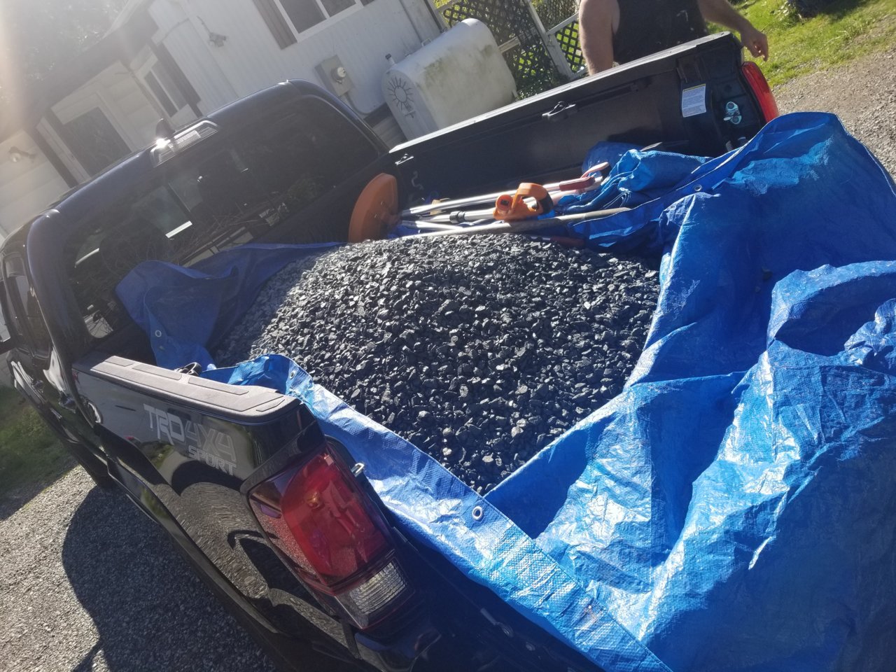

    Not sure what that stuff is but a yard of A gravel is 3000 lbs. I did that once in my '91 pick up. It sat on the axle but a drove it home. lol
    Junkhead[QUOTED][OP] likes this.

    I asked the guy twice if that was a yard, he said yes. I paid for the yard too. He loaded half a yard first and i told him to keep loading. I have never transported a yard before so i have never seen how it looks like in a 5ft box. I might have got screwed for all i know. The truck definetily felt very heavy when braking, the engine seemed to not care at all.
  18. Jul 31, 2020 at 1:31 PM
    #78
    Junkhead
    Junkhead [OP] TRDude
    Feb 27, 2019
    #284671
    15,685
    Serge
    Prince George, BC
    Black 4x4 Sport MT 2018
    Some Serious Tires
    Im sure i would "see" more if i measured, i was just surprised that the sidewall didnt even bulge. I drove on curvy mountain highway for about 45 with the load and it drove excellent. Back felt good.
