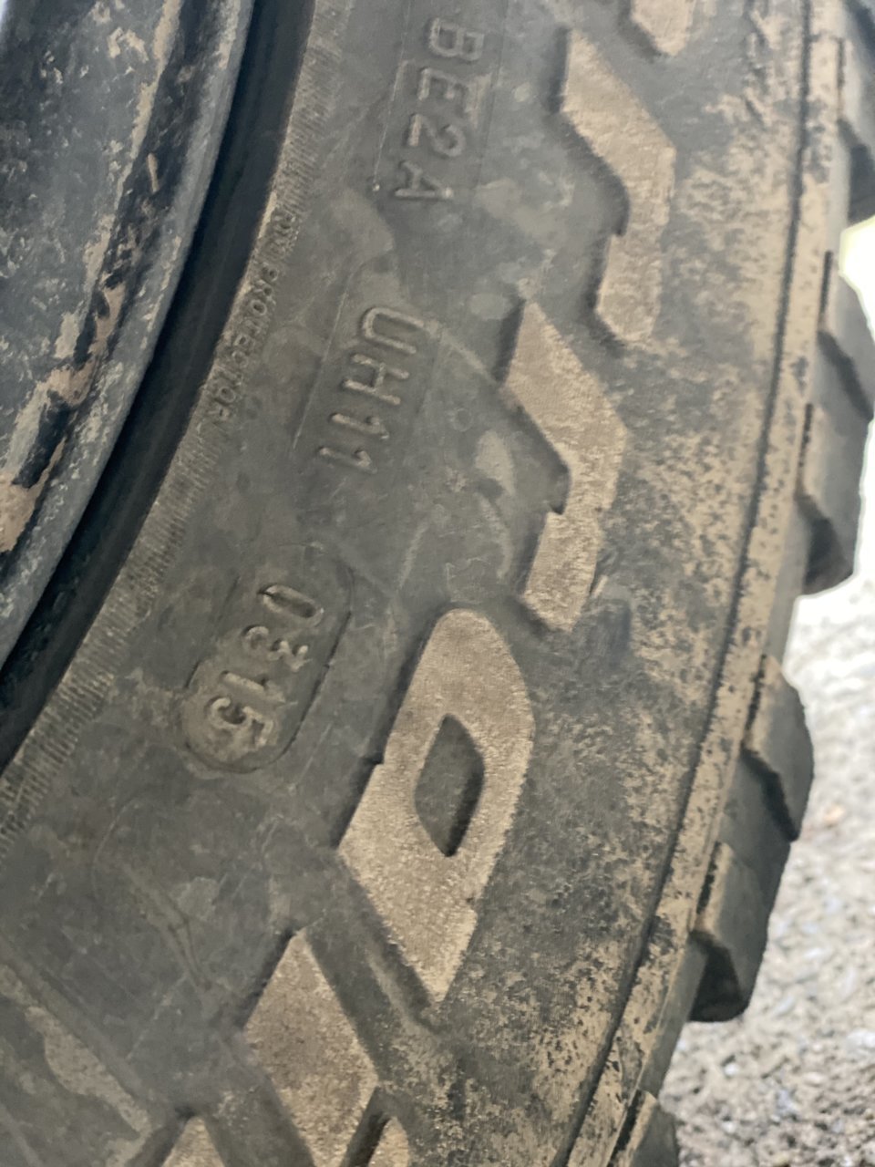

    Based on this photo can anyone identify when these tires were manufactured? I know they’re really old and have been considering replacing them but they’ve got a lot of tread left and no cracking what so ever.
    Junkhead[OP] likes this.

    1969?? Haha i doubt it though. Check the DOT on the other side of the tire.

    I took a picture of another tire and the 6 is actually an 8. The vehicle is a 1993 so I don’t know if it’s feasible the tires from 1989 got put on it. I don’t see any date coding on the inside/ white letter side of the tire.
