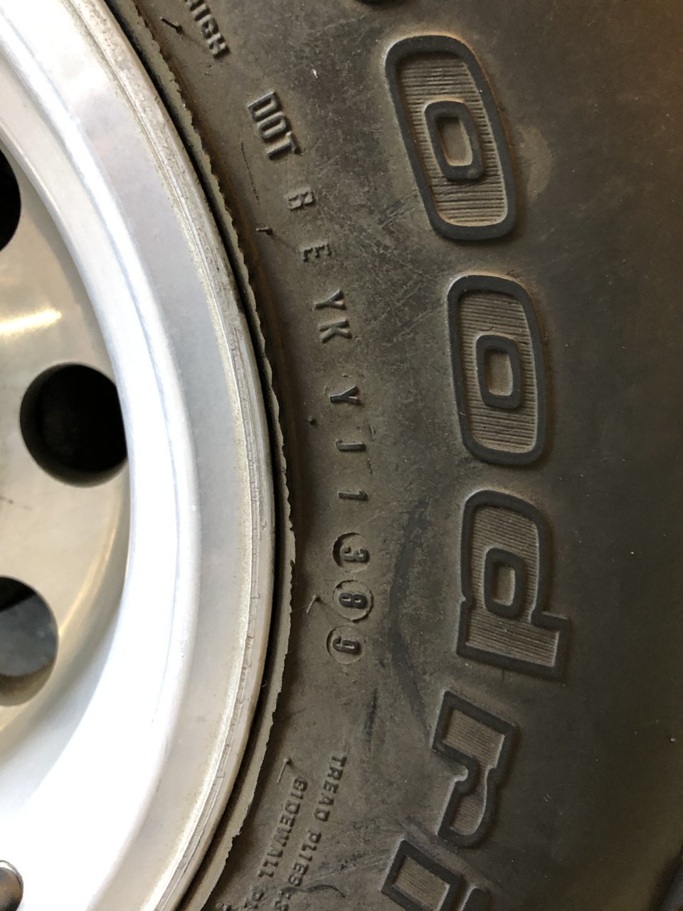

    Hm interesting. I think you gotta look on the other side of the tire. The actual date is only on 1 side.

    Nothing on the other side at all that has any indication of date or date coding. I honestly believe these to be from 89. They ride and sound like shit so I wouldn’t be surprised.

    Strange. Yeah could be 89, never know how long they sit on the shelf. My tires have DOT on both sides but only 1 side has the date after the DOT.

    They’re actually in pretty darn good condition but I don’t know if I’m flirting with disaster. I don’t want to push my luck. I had been thinking about going to 33” anyway (these are 32”).

    Older tires had a different method for telling the year of manufacturing. Can’t remember what it was though.

    Pre 2000 it was a 3 digit code; first two being the week of year, the last being the last number of the year.
    So the tire in question was built 38th week of '89.

    That makes sense as 1 tire says 369 and another is 389 so they were made 2 weeks apart. Thanks for the info guys

    I was just wondering but what would differentiate the date coding between 1989 and 1999? It seems more realistic that these are from 1999 but 1989 is always possible too. Sorry OP don’t mean for this to be a thread jack

    Good point...
    The owner says it's off a '93.
    I assumed he's had ownership of both the tires and vehicle since '93.
    Either way, seems the old code wanted tires changed at 10 years and they're at least 20 years old...

    I just got it from my uncle this past fall and he got it somewhere in the early 2000’s I’m guessing. I can’t remember if it had the wheels and tires on it when he got it but they’ve been on it for as long as I can remember. And that’s not saying a lot. . I’m going to get some prices on tires this week so I’ll ask the tire guy if he’s got an idea just to satisfy my curiosity.
