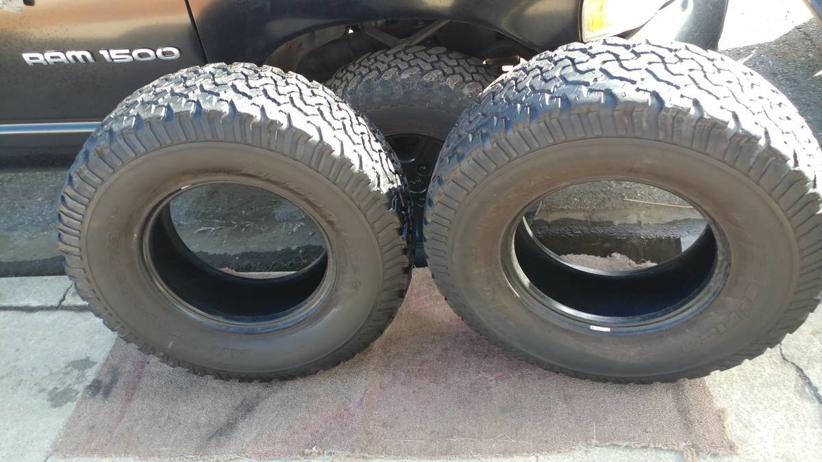

    What's this? A wild set of 285/75R16 BFG A/Ts appeared!
    With the exception of a bit of one side wear, these tires are in as good of shape as any of the tires I have found used. The guy at pep boys dunked them to check for leaks after mounting them on my rims.
    BEHOLD, THE BEAST
    So of course, I took it out for a drive. I took it on the same path I did where I had rub before, with ups and downs and dips and bumps. The verdict: They fit great. I couldn't do anything to make them rub. THANK GOODNESS.
    I then took it the freeway. Yolo. Took it up to 65 mph. I chose a stretch that has a huge two to three lane wide emergency lane just in case I needed to pull over. But I didn't, it was smooth sailing. I drove my baby up the hill for some glamour shots right after the sun had set.
    Hooray!
