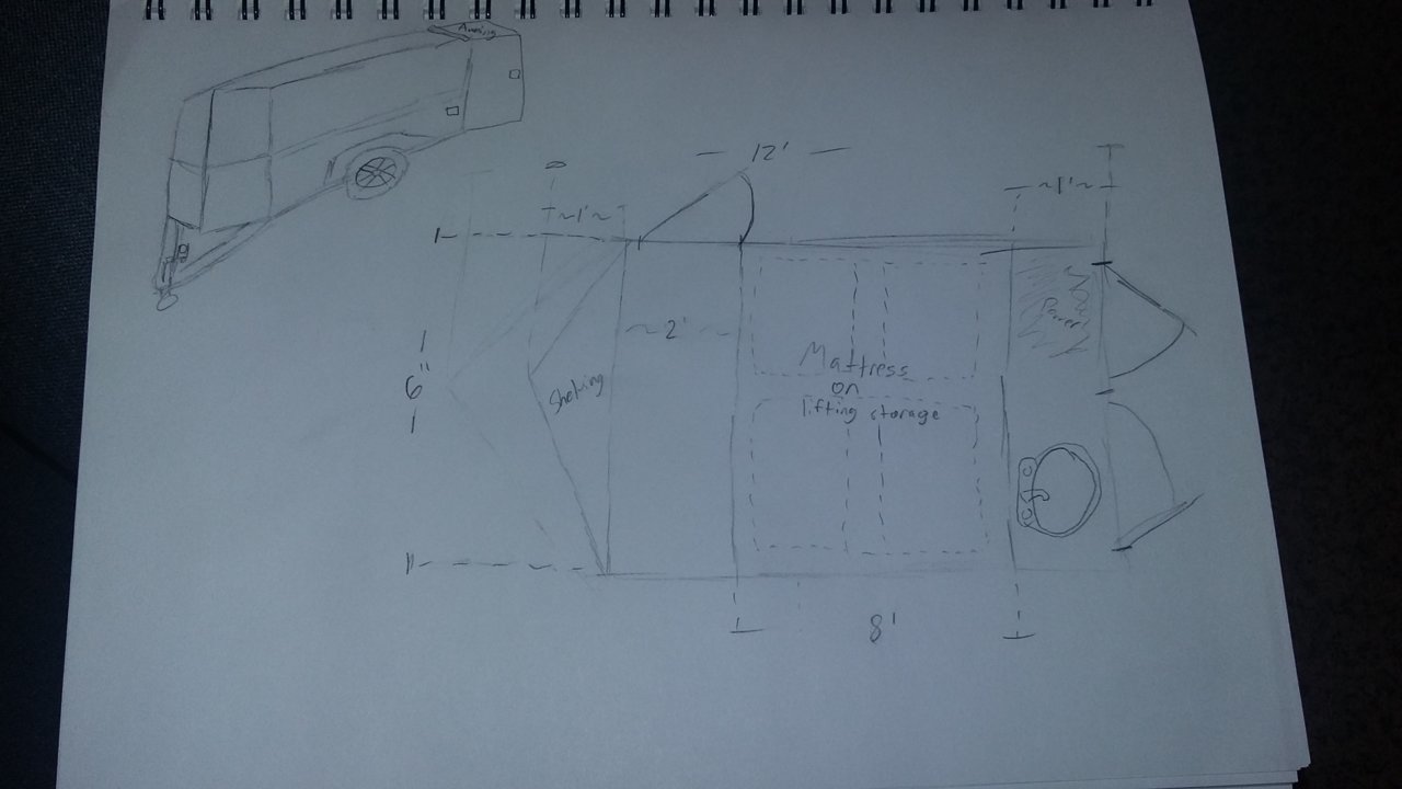

    I have a design sketched up for a 6x12. Its just 'Top Down' so you just get the basic layout and not all the storage I plan for. I'll try to remember to upload it tonight when I get home.

    Finally remembered to upload my plan for the 6x12. Freehand rough sketch, Im no artist.
    gwolff[OP] likes this.

    I would try to give yourself close to 16" for the rear counter.. just to make it easier to fit a sink and store water. But depending on your mattress and door location you may not be able to. I will be super excited to follow your build if and when you start. How do you want to build the frame to work from a mechanical standpoint?
    Slashaar[QUOTED] likes this.

    You mean reinforce the trailer frame? I haven't put much thought into it.
    When I was originally designing it I planned for a full size mattress and to just have it on a flip up platform with gas struts with storage underneath, like some campers have. However looking at that $73 futon matress, I may do your design and that would give me enough wiggle room where the matress being in front of the door when extended not a problem.
    I was thinking either a ramp style or barn door style rear. Ramp would bring me closer to the utilities for ease of use should things get too high. But barn doors I was thinking I could put an awning off the back and essentially have an enclosed kitchen area/bathroom with linoleum on the doors and a tarp wall off the back. Then have a nice shower head in that area as well. I'd have to seal up the battery compartment really well if so.
    Really I think I'll go in with a basic plan and then kinda sort things out as they go. Probably start with the back and build something very similar to what you have and then take it from there.

    I meant like what mechanism would the bed use to raise/lower, which you covered.
    I think barn doors are nice because you can use the walls for storage/functionality. You also need less room to open your trailer. This is particularly nice when storing your trailer. I also liked tucking things underneath the rear of the trailer, which would be harder to access with a dropped ramp.

    Yeah. I figure, I could always make a step that would slide over the top of the counter when all packed up if need be.
