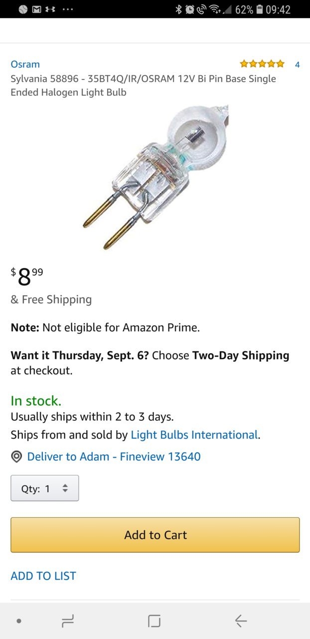

    Inevitably, I have arrived here as well. The OSRAMs for 8.99 through a company vs the Phillips at over 2 X the price from who knows.. well.. I've ordered 3 of the :Screenshot_20180901-094221_Chrome.jpg
    Just in case something goes sideways.

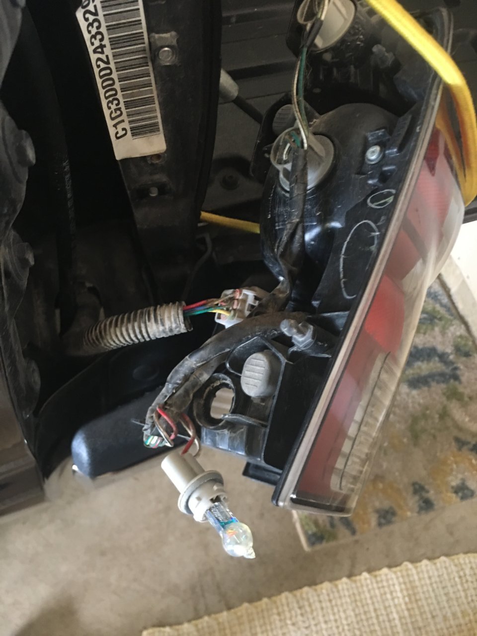

    I installed mine over the weekend. This mod is awesome, so much brighter than stock!! I went through the trouble of finding the Phillips 18161. It was the first time I had ordered anything that came directly from Slovenia, but the only real complaint was the 2-3 weeks it took to get here. Well worth the wait. Thanks again @crashnburn80 !!
    I ordered 4 to be safe, but no more than I use reverse; They shouldn't ever go out. I did a hybrid prong bend/socket adjustment with a pick for the install.

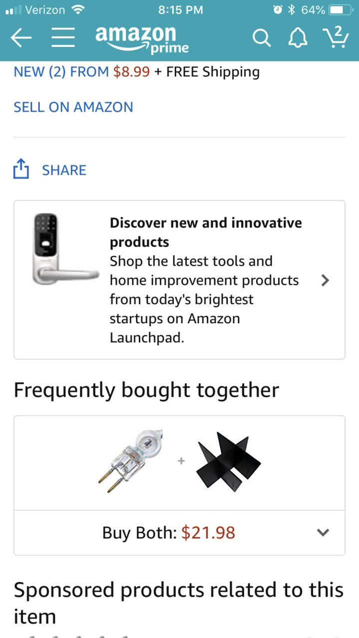

    Apparently TW is such a large consumer of these bulbs, that Amazon says the Tacoma console storage divider is one of the items frequently bought with this bulb.
