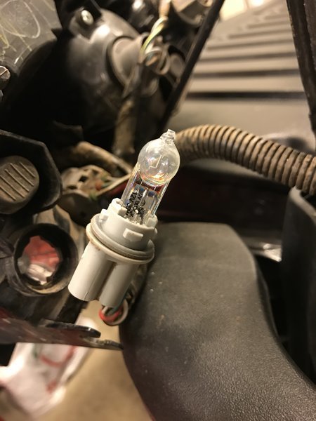

    Did you bend them in an arc shape? Or try pinching the clamp tighter in the socket? Mine lock firmly into place.

    I tried bending into an arc shape. It seemed like the prongs were too long because the base of the bulb never came close to the socket. Should any part of the bulb base seat into the socket?

    Those are what I used. Dont bend the pins on the bulb because you will risk snapping them off as someone in this thread already said. Take a very small flat head and bend the "prongs" of the bulb socket closer together. Get them as tight as possible then put the bulbs in. And yes they do go into the socket quite a ways.
    *Edit you already bent the pins, so dont bother trying to straighten them at this point. That will only risk breaking them more

    As mentioned try the clips in the socket closer together with a small screwdriver to hold it tighter. If that doesn’t work make sure the apex of your arc bend is a little wider than the slot the bulb goes into so that the tops of the arc are pressing on either side of the socket.
    The bulb should look like this when in:
    I’ve done several off road trips since doing this and never had an issue with the bulb falling out.

    Ok I'll try that. I ordered a new set of bulbs just to start fresh. I definitely didn't the bulb as far in as your picture so I'll aim for that. Thanks!
