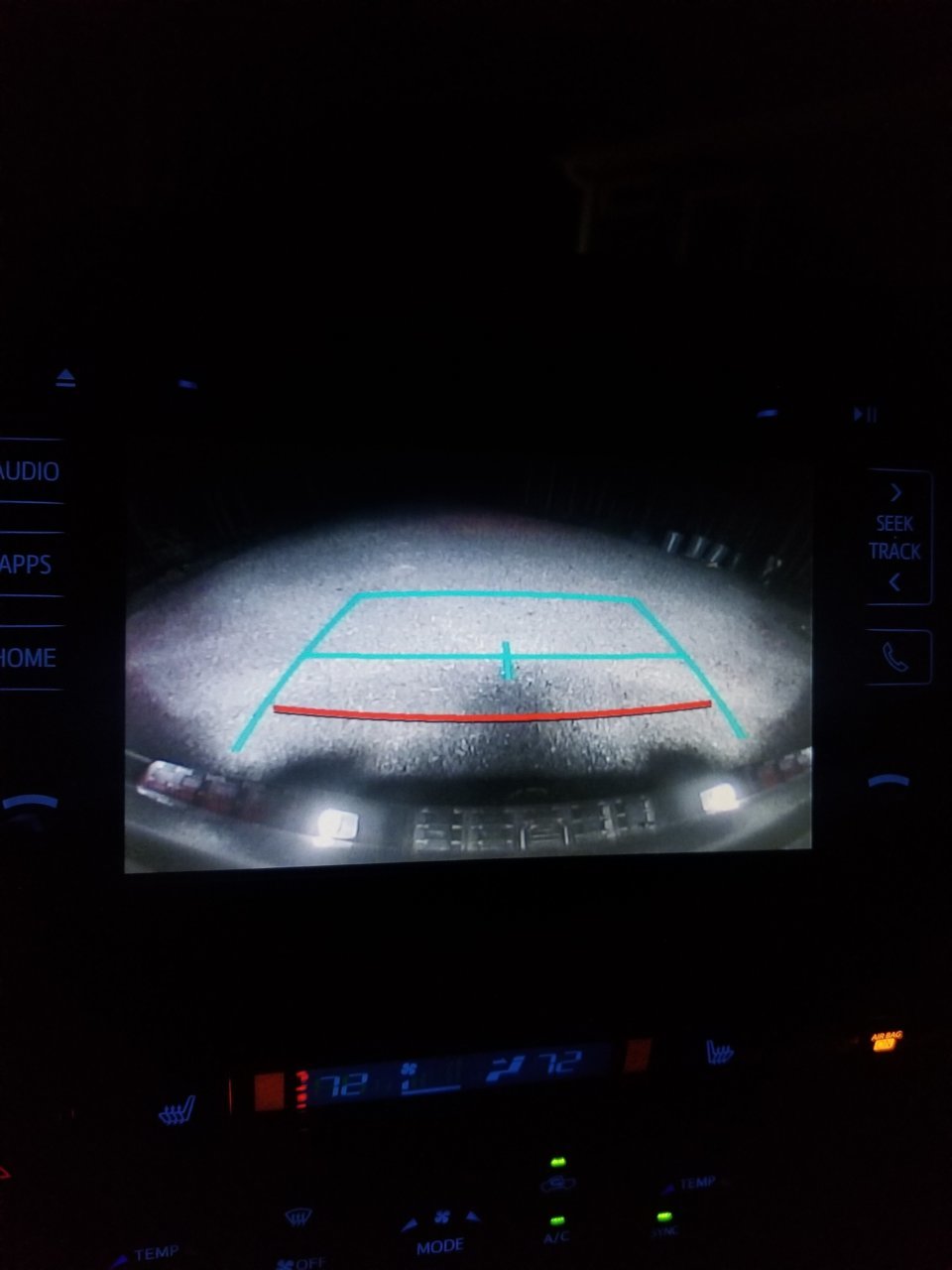

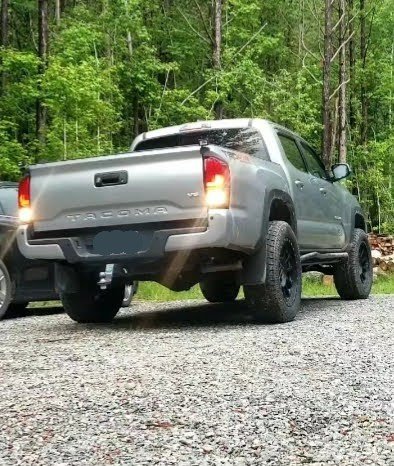

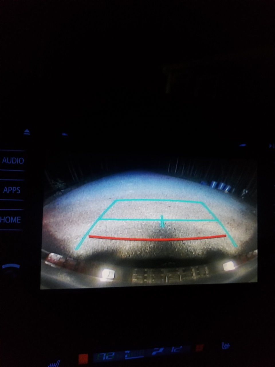

    Pulled the trigger on this mod late last month...It is truly night and day!
    Here is the reverse camera without my supplemental KC C2 flood pods.HIR reverse backup cam.jpg
    Here is the same backupcam photo, but with the C2 floods (on tailgate pods)w_KC floods.jpg
    IronPeak, crashnburn80[OP] and SR-71A like this.
