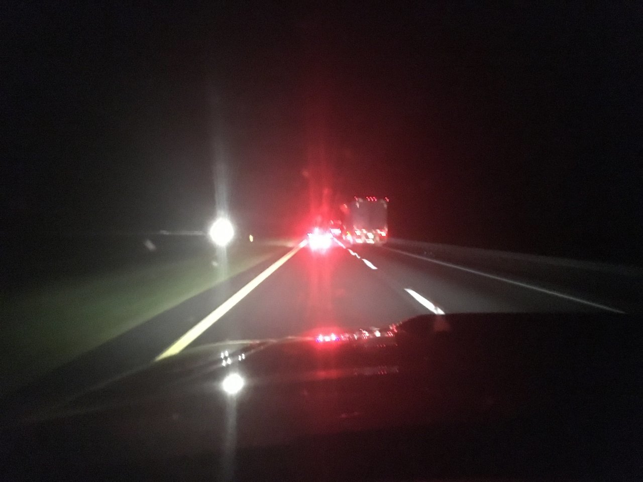

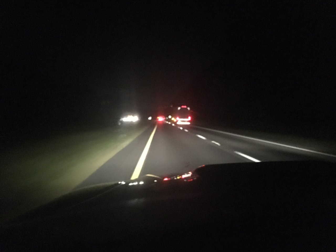

    If you're blinding them, they're too close.

    Yeah, no. These LED companies that try to make brake light output similar to headlights, and then sell it as a ‘safety upgrade’ are idiots.

    I haven't seen them that bright yet. I do find the flashing 'safety' brake lights annoying though.

    I was being a bit facetious with the headlight comment. But as I quoted above, some companies are already making them dangerously bright, blinding the trailing drivers. You want the person following you to actually be able to see at night.
