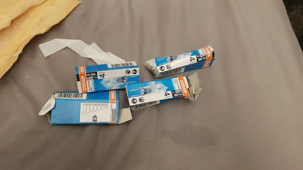

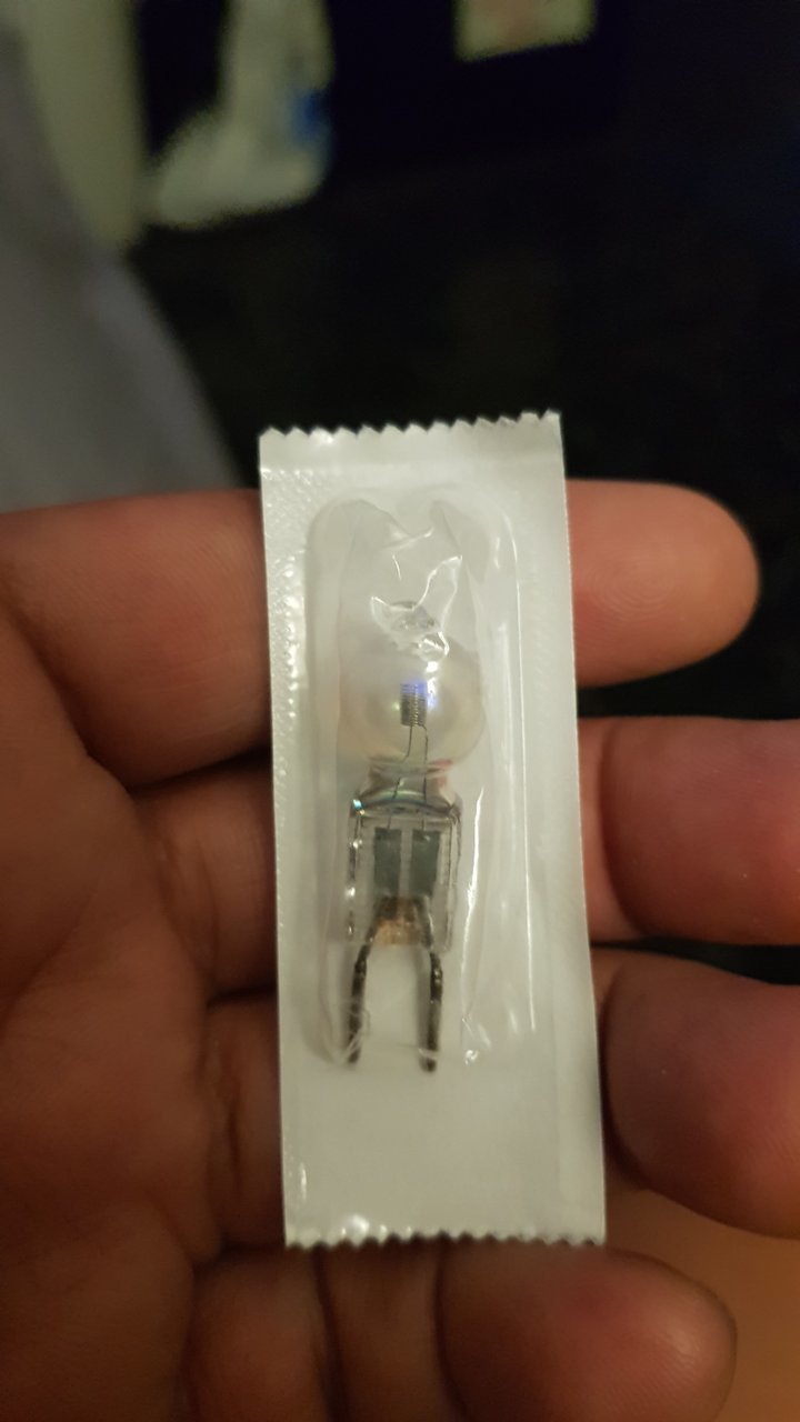

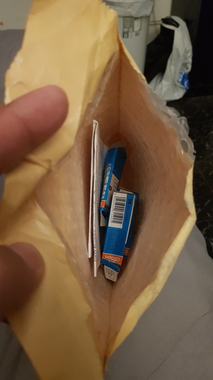

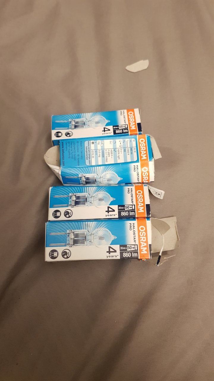

  20. Oct 20, 2019 at 7:53 PM
    #300
    Tmaloy
    Tmaloy Well-Known Member
    Oct 3, 2019
    #306953
    344
    Troy
    2019 SR DC LB
    Went out to the kitchen and found a padded envelope my step son brought in from the mail. Dependable Trading needs to upgrade their packaging.
    Loose packed, no bubble wrap, to secure the bulbs, a cheap box would have been better. Checked all the prongs and they seem to be fine, none of the inner plastic sealed bags opened. Glad I ordered 4 of them, just in case. Word of caution if you do order from them. Order was placed on Oct. 3rd. Will install them soon and see how they turn out.
