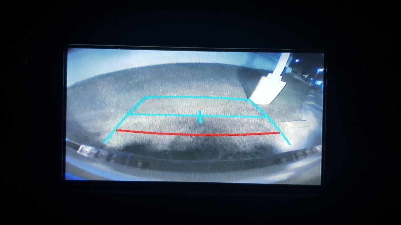

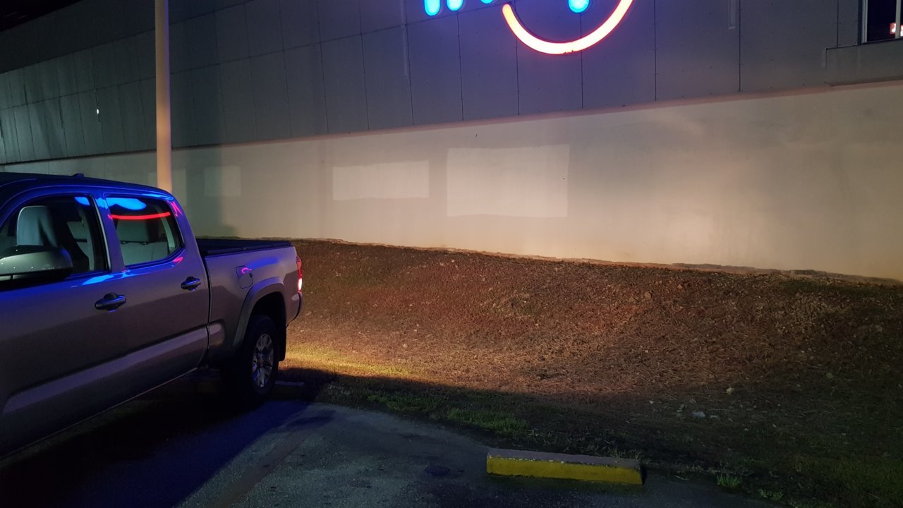

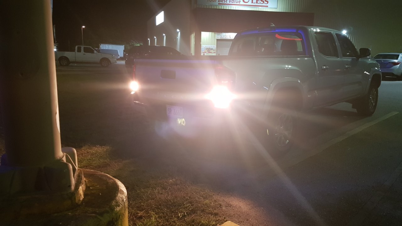

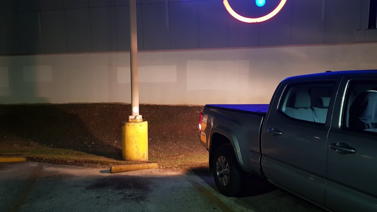

  5. Oct 22, 2019 at 12:20 PM
    #305
    Tmaloy
    Tmaloy Well-Known Member
    Oct 3, 2019
    #306953
    344
    Troy
    2019 SR DC LB
    In the parking lot at work and took a few pics.
    Left side facing the adjacent building and the right side. Side of the truck and rear camera view.
