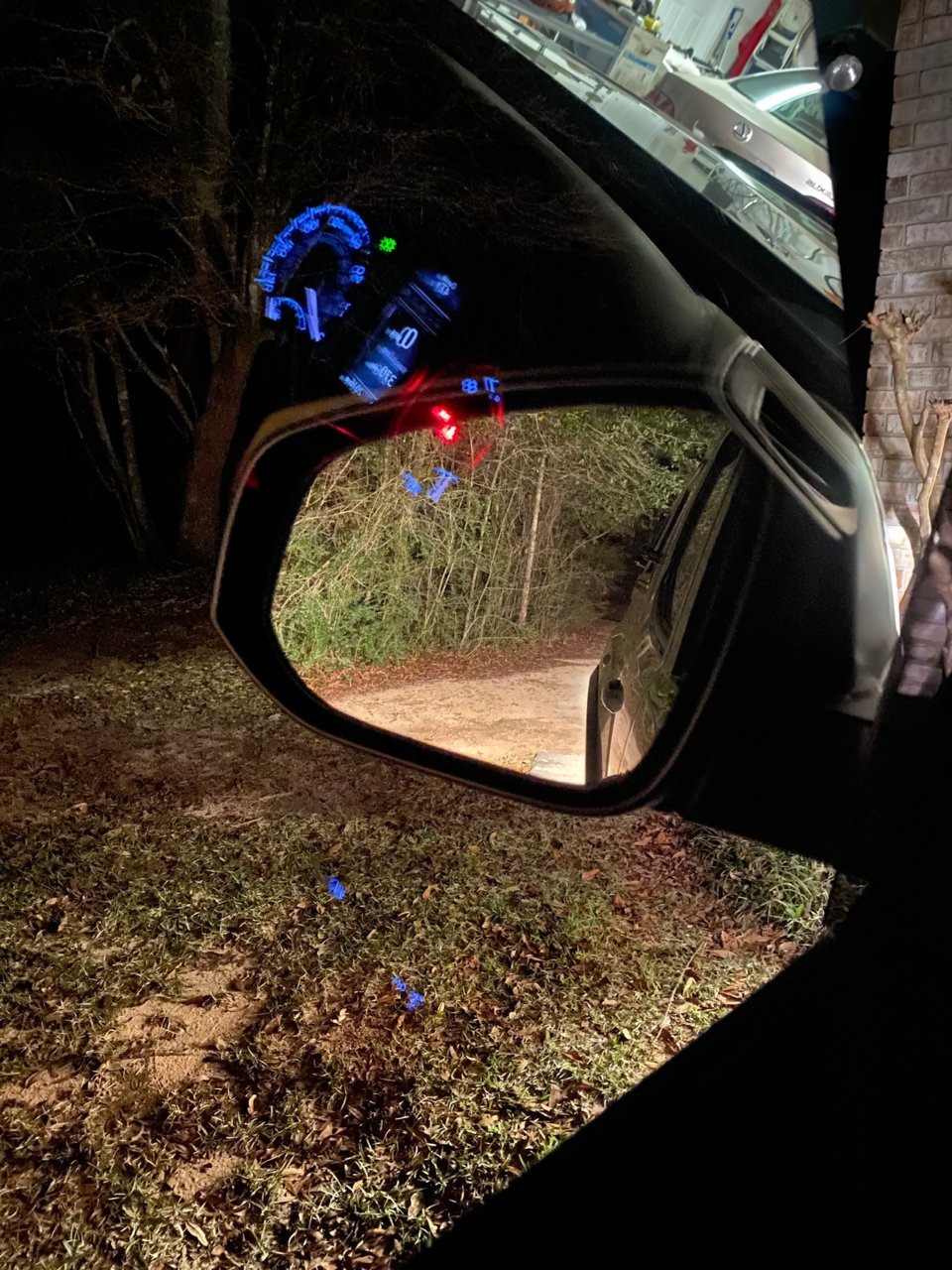

    Blevin
    Florida
    2019 Quicksand Tacoma OR DCLB
    ARE MX, mud flaps, radio knobs, floor mats
    I installed my Osram HIR bulbs yesterday. The amount of light they put out is amazing. While I can tell the difference in the backup camera, the view in the outside mirrors is unbelievable. Thanks to @crashnburn80 once again. E67314F8-BB35-41F0-AB20-1C9D7BC05A91.jpg
    GonzoQuick and crashnburn80[OP] like this.
