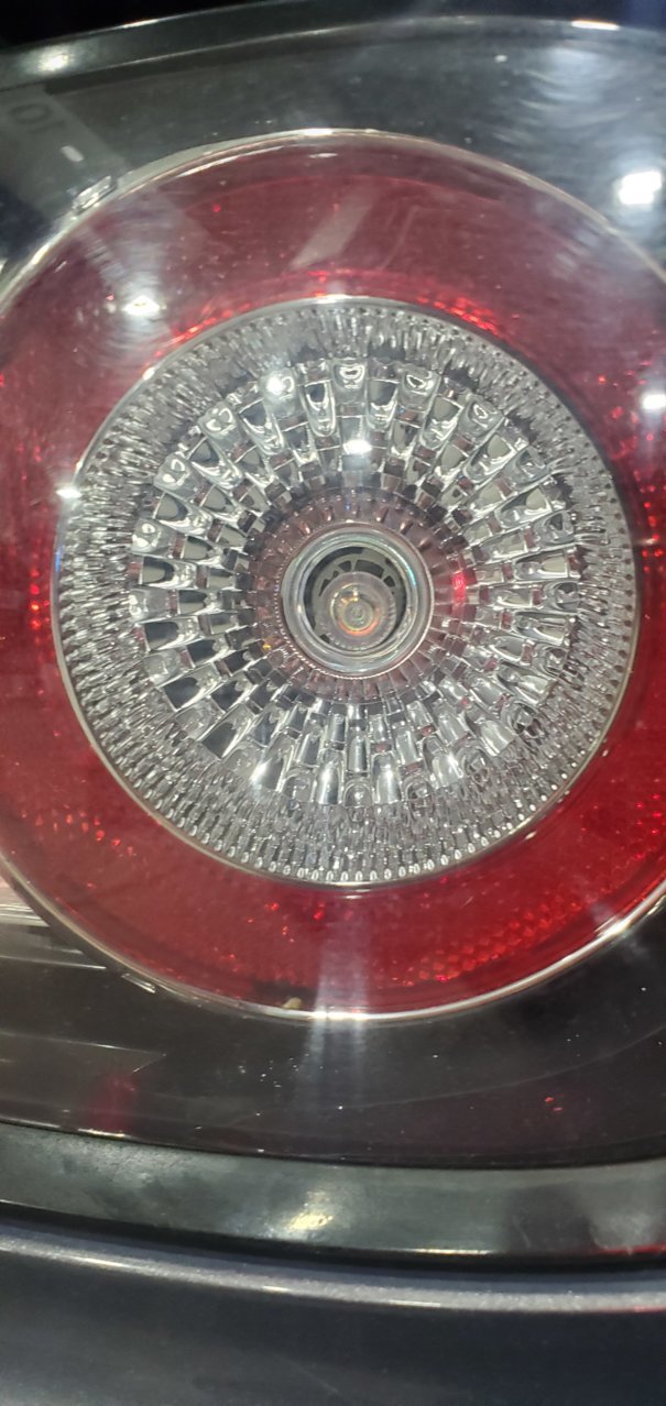

    I pinched the sockets and bent the prongs, the bulb holds snug-ish. There's the issue of the filament position not lining up correctly. While a hell of a lot brighter, most of the light output is down towards the ground because of this.

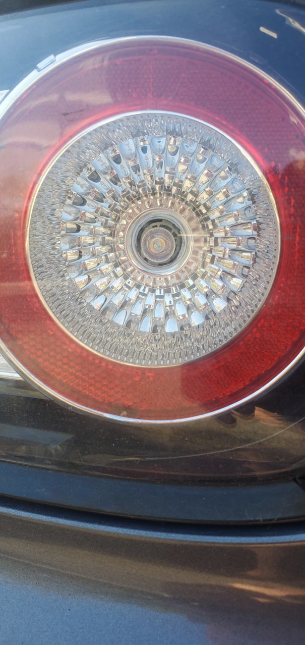

    For whatever reason the left side bulb didnt hold still and started pointing down:
    I fixed it by wadding some electrical tape in on both sides,
    Much better. The output should be better now too.

    What vehicle is that? It looks like electrical tape has a service temp upto 221 degrees, the bulb capsule itself will be hotter than that. What you don't want is the tape to smoke and coat the inside of your taillight with a film that would be impossible to clean without taking the lamp apart. If you need tape to secure it, you may look at getting some high temp tape instead.

    You're right, I may have to use the 921 bulb in the meantime while I find a better strat.
    But I'm backing up for 5 seconds usually -- do halogen IR bulbs heat up quickly enough to smoke the tape?

    The halogen cycle requires very high temperatures within the capsule to operate, starting around 500 degrees F. I don’t have data for how quickly the bulbs comes up to temp or what the temperature will be at the base of the bulb after 5 seconds, but it seems likely it would exceed 220 degrees F. If I had a Flir and a spare bulb on hand it would be an interesting experiment to measure.

    It's a Mazda Miata btw. 921 reverse bulbs are common in cars, so your post is cited on headlight forums, like hidplanet.com, which is how I got here.
