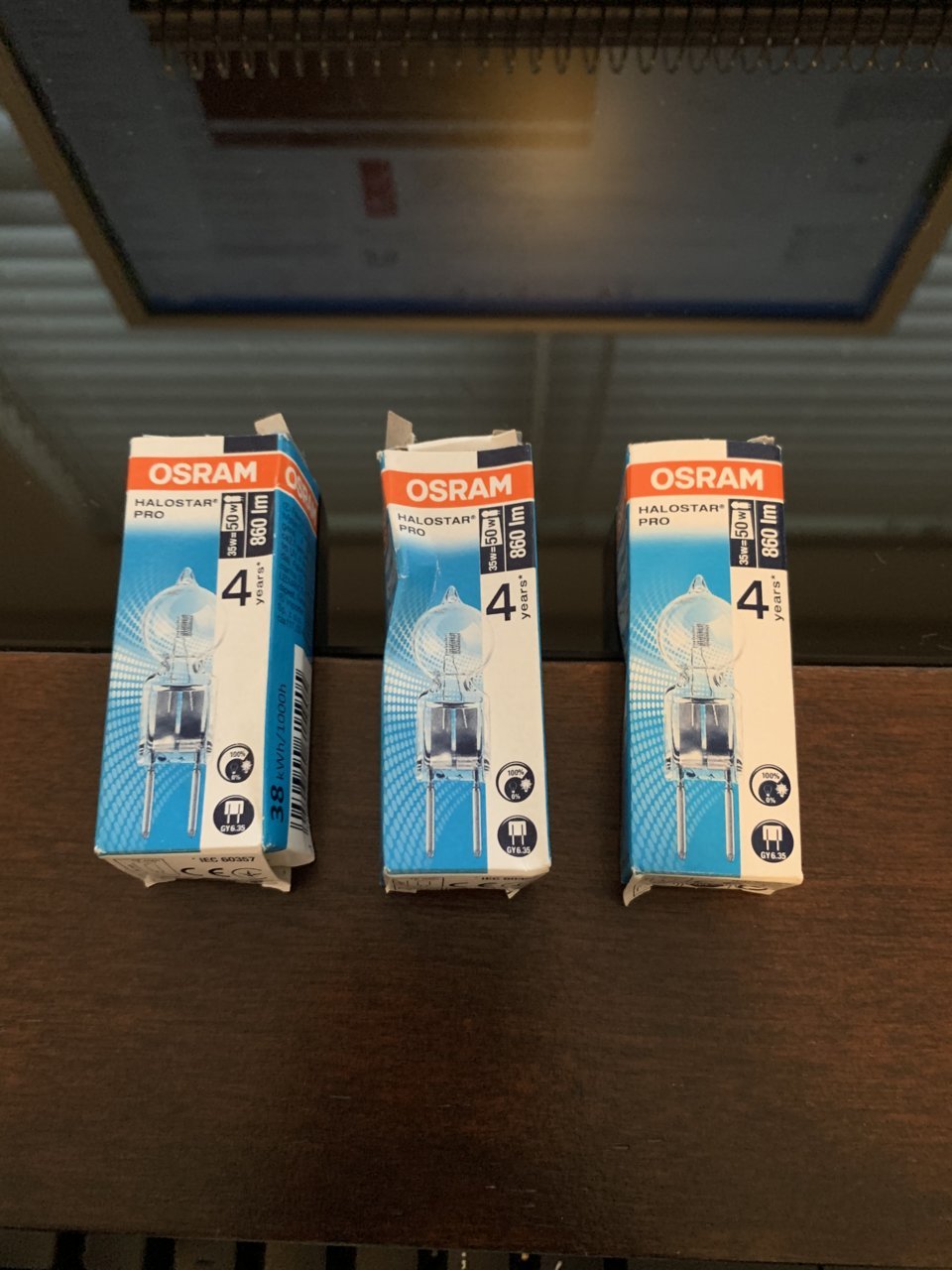

    Lights came today and boy do those little boxes take a beating. I'll get to install them this weekend though.

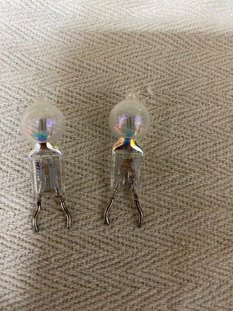

    Mine came today also, but my wife had plans to go to the store, hey got a 12 pack of Bud light out of the deal
    I have mine ready to install tomorrow.
    GRNT4R likes this.

    They look good!

    thanks, looks like the soft music worked. :rofl:it took a bit to get them bent the way I want.:cheers: add me to your traveling beer list. :bowdown:

    yes two sets of needle nose pliers works best, have one on one of the prongs coming off the glass then use the other pliers to bend, take your time. then move to the next prong. Have plenty of light. IMO

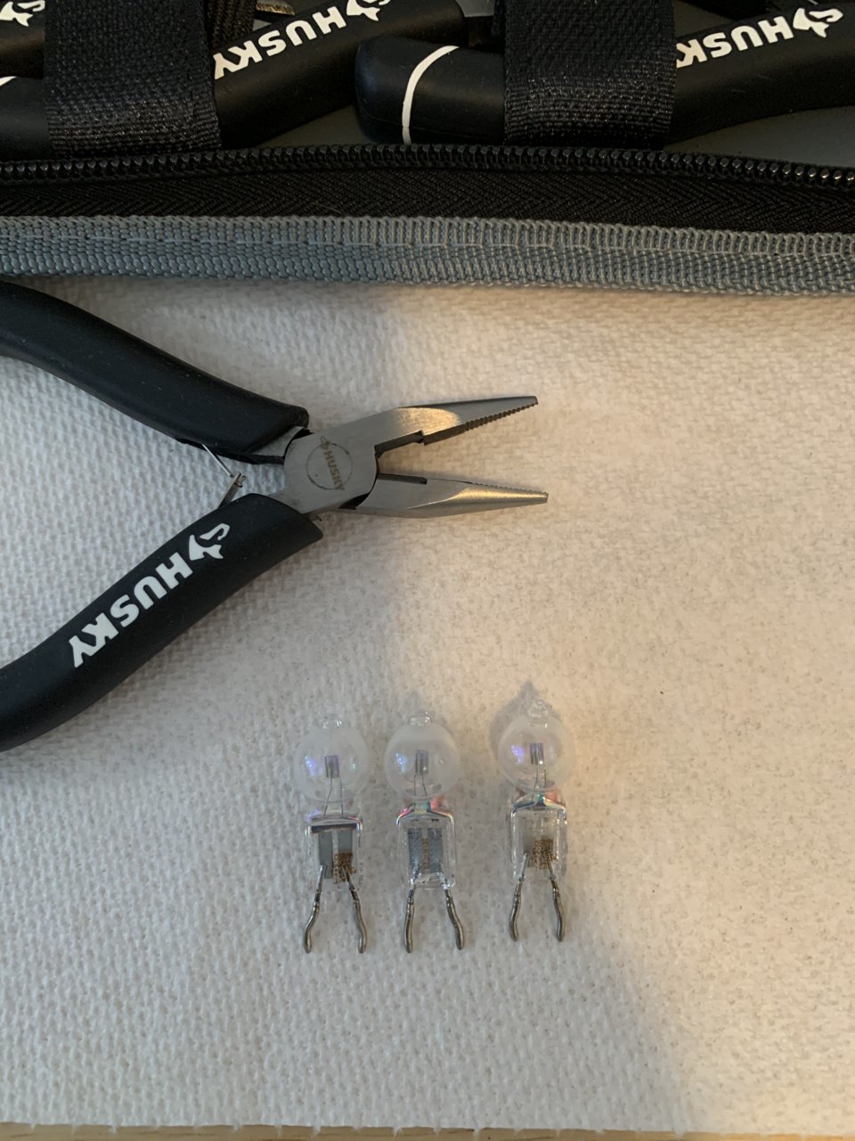

    Done. Not quite as good as yours but hopefully it’s enough.

    looks good to me, great job

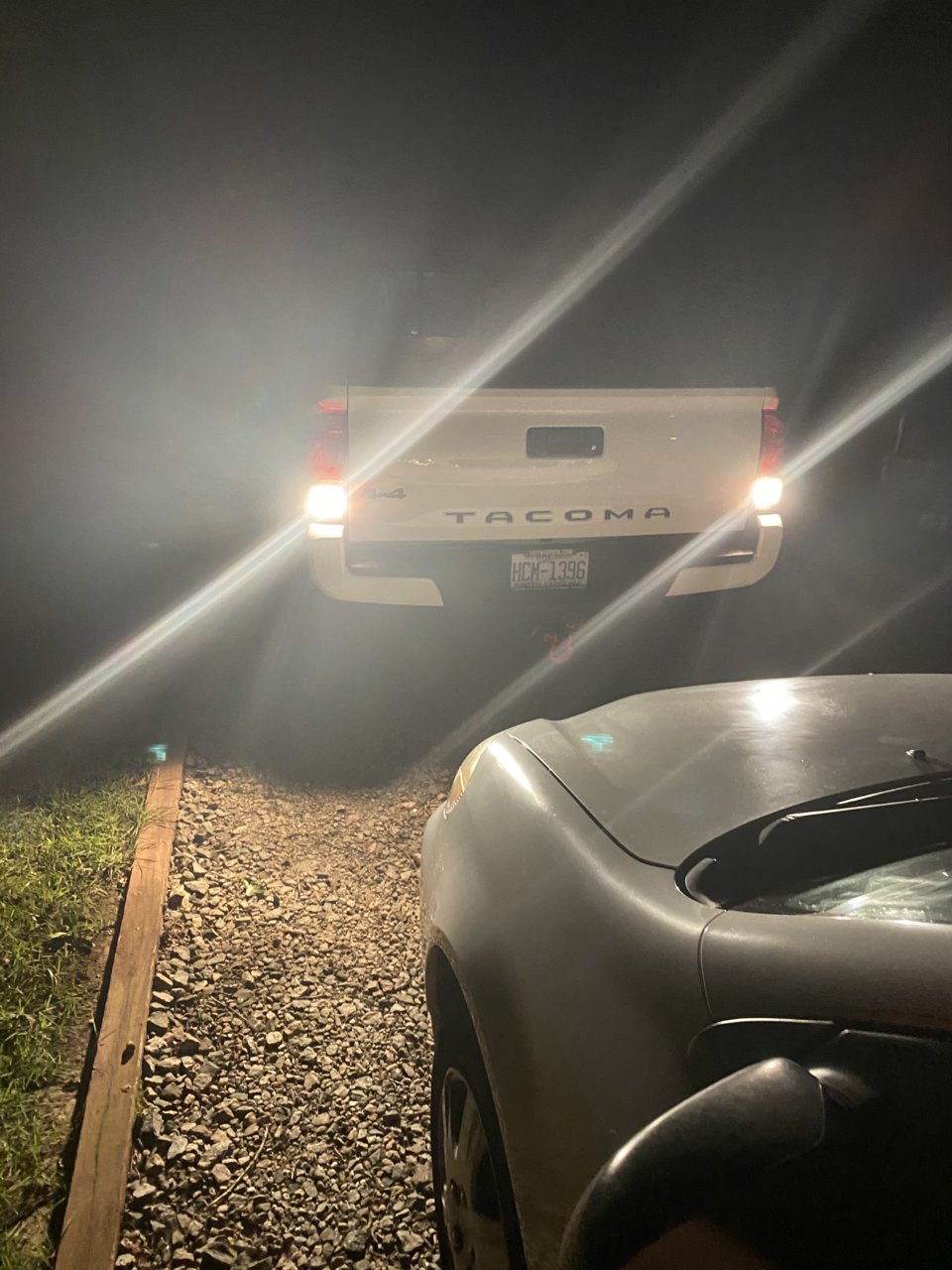

    Not a great picture but indeed a lot brighter, I also had to play around with the 921 socket to get bulb more secure
