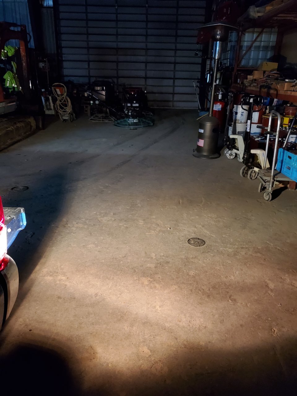

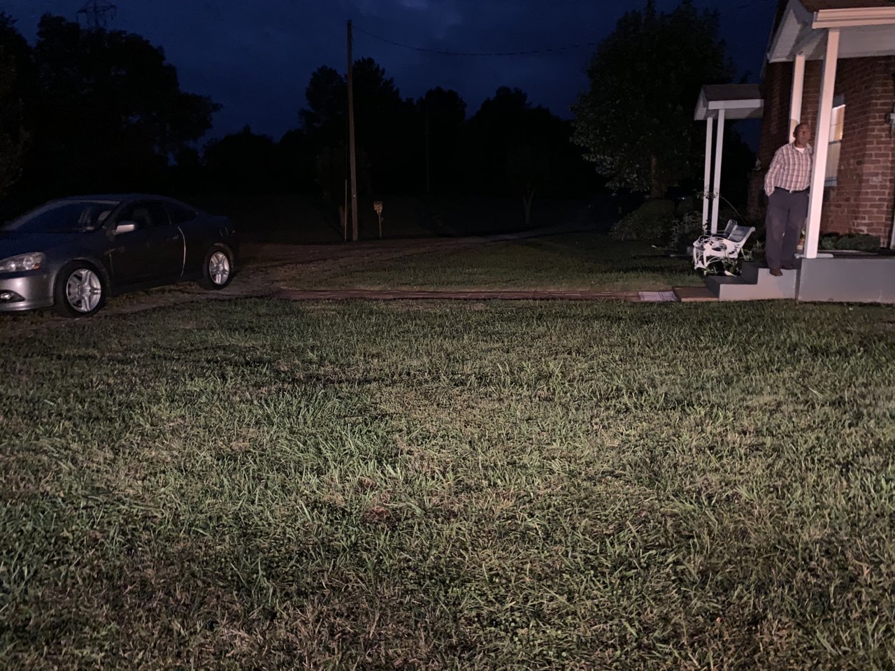

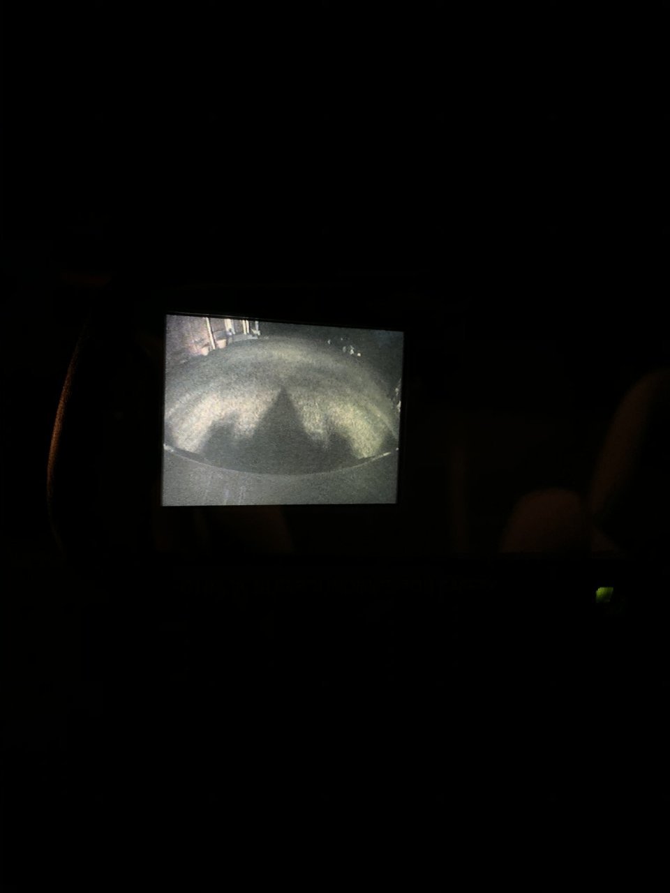

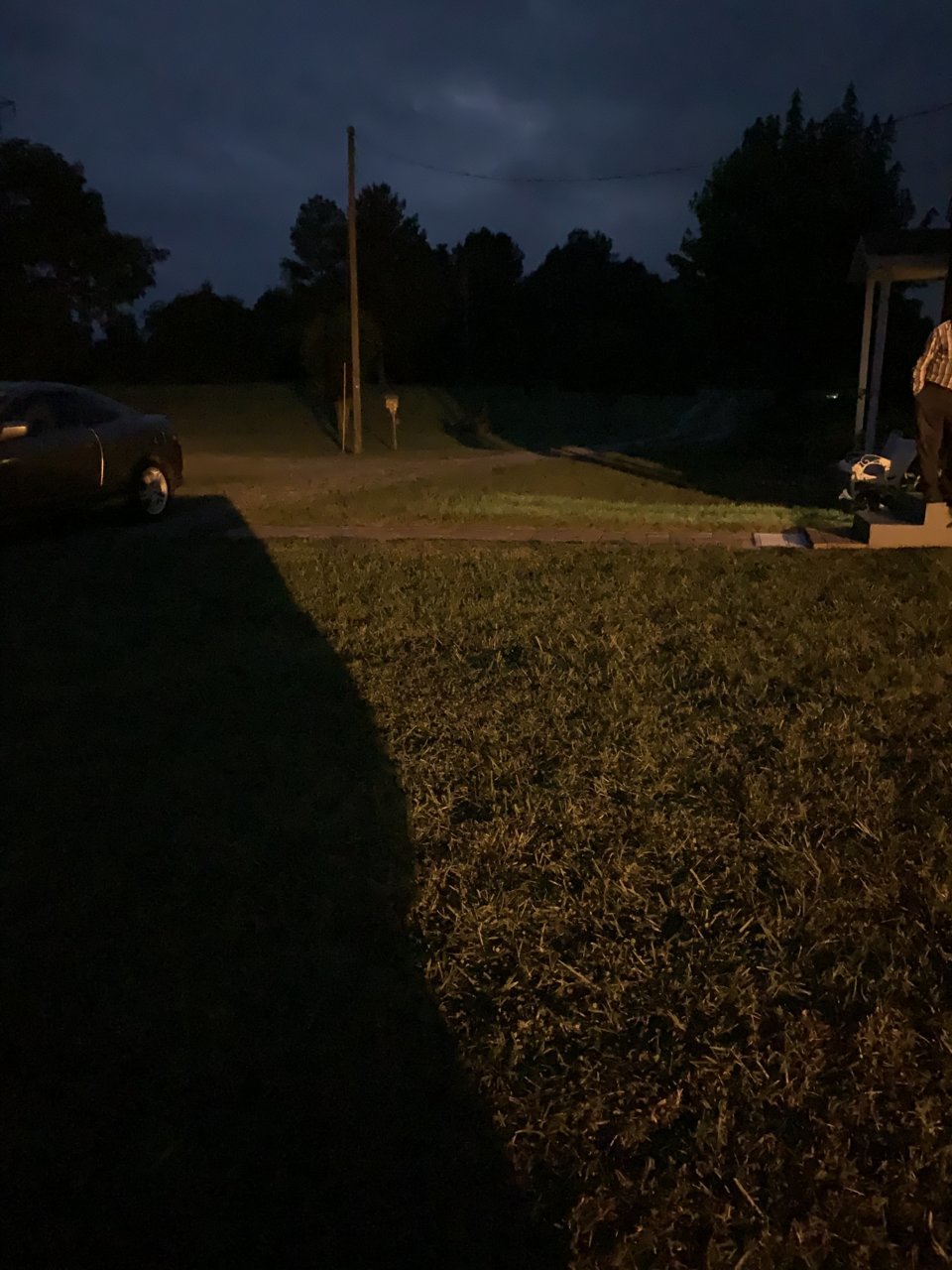

    Was able to get them in with a few pics. We have a dusk to Dawn light about 50yards away infront of the truck but still a huge diff. I did bend the prongs in the plug on each side ans mine seems to be pretty tight. Huge difference to me. Wish I could turn off that dusk to Dawn light but I’m pleased with them @Vzpatrick
    this is with me standing in front of the license plate directly against the truck
    this is with the lights on standing in the same spot

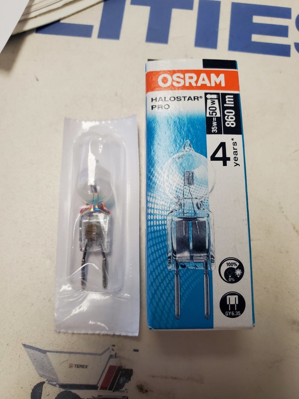

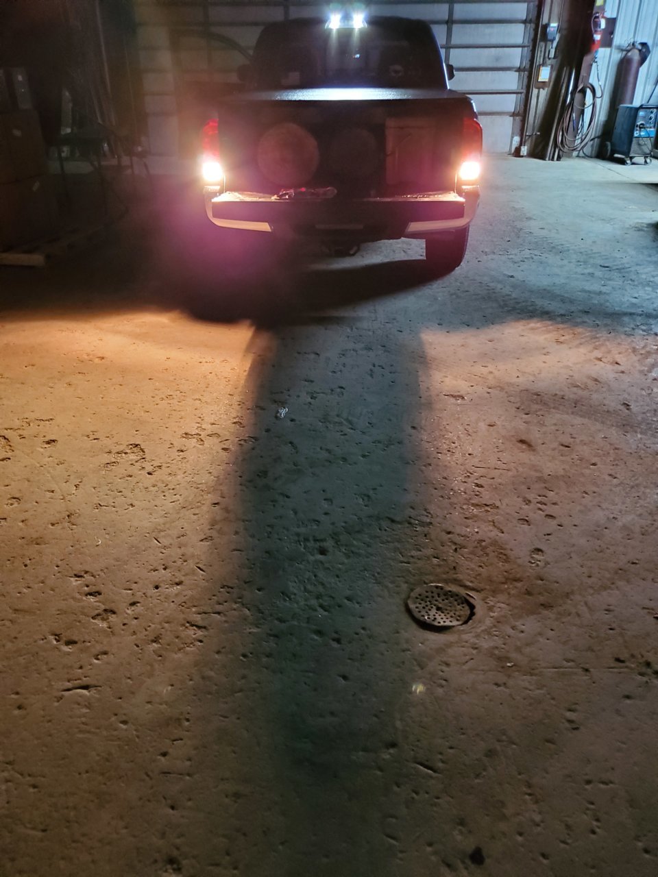

    Installed Osram. Used emery cloth to create grip on pins, squeezed pins tight with a small steel pick. Slid in tight, and easy. No other modification to pins. 15 minute upgrade.
    Awesome view.
    You can see which side was done.20201204_084137.jpg 20201204_084114.jpg 20201204_171617.jpg 20201204_171548.jpg
