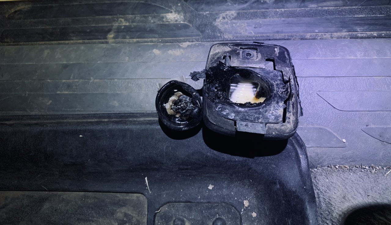

    Well, the 50 watt GY6.35’s do not function as license plate lights. Caught this on the test drive after installing tonight:

    yea. i can only imagine that little thing was never meant for anything more than a 194 bulb. lol
    not to mention the wiring surely was not happy feeding that power.

    Wow. you put a 50w bulb in for the license plate?!? I don't understand why people want to light their plates up that bright, but using a 50w bulb in the plate lights is obviously not recommended.

    i put white leds in.. just wish they were dimmer. i like the lower electrical load.. it saves my aging alternator i keep putting off replacing in the tundra.. lol

    Savings are pretty negligible. I'd recommend leaving the license plate lights stock.
