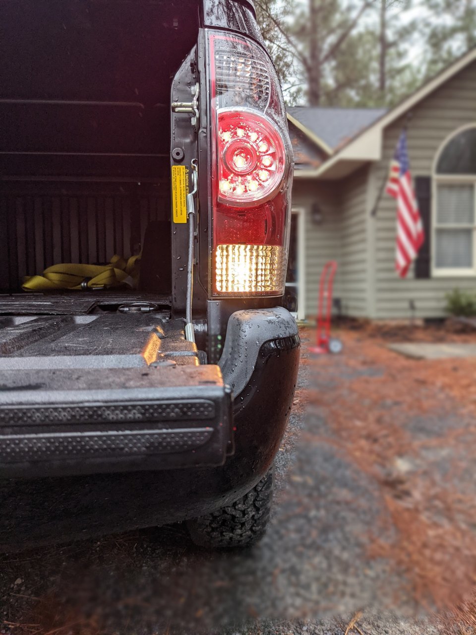

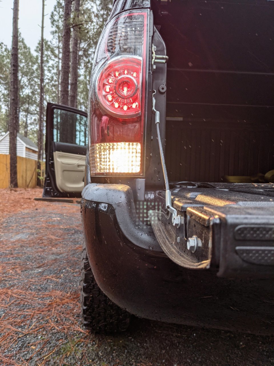

    Changed out the stock reverse light bulbs today to Osram 35w 860 lumen bulbs. Even though the difference is somewhat tough to see in the middle of the day, it is clearly brighter. I had to spread the prongs a little bit and also pinch the metal flanges on the inside of the plug in order to get the bulb to sit snug. I'll be anxious to see how these are at night. The pictures show the stock bulb on the passenger side and the Osram on the driver's side.
