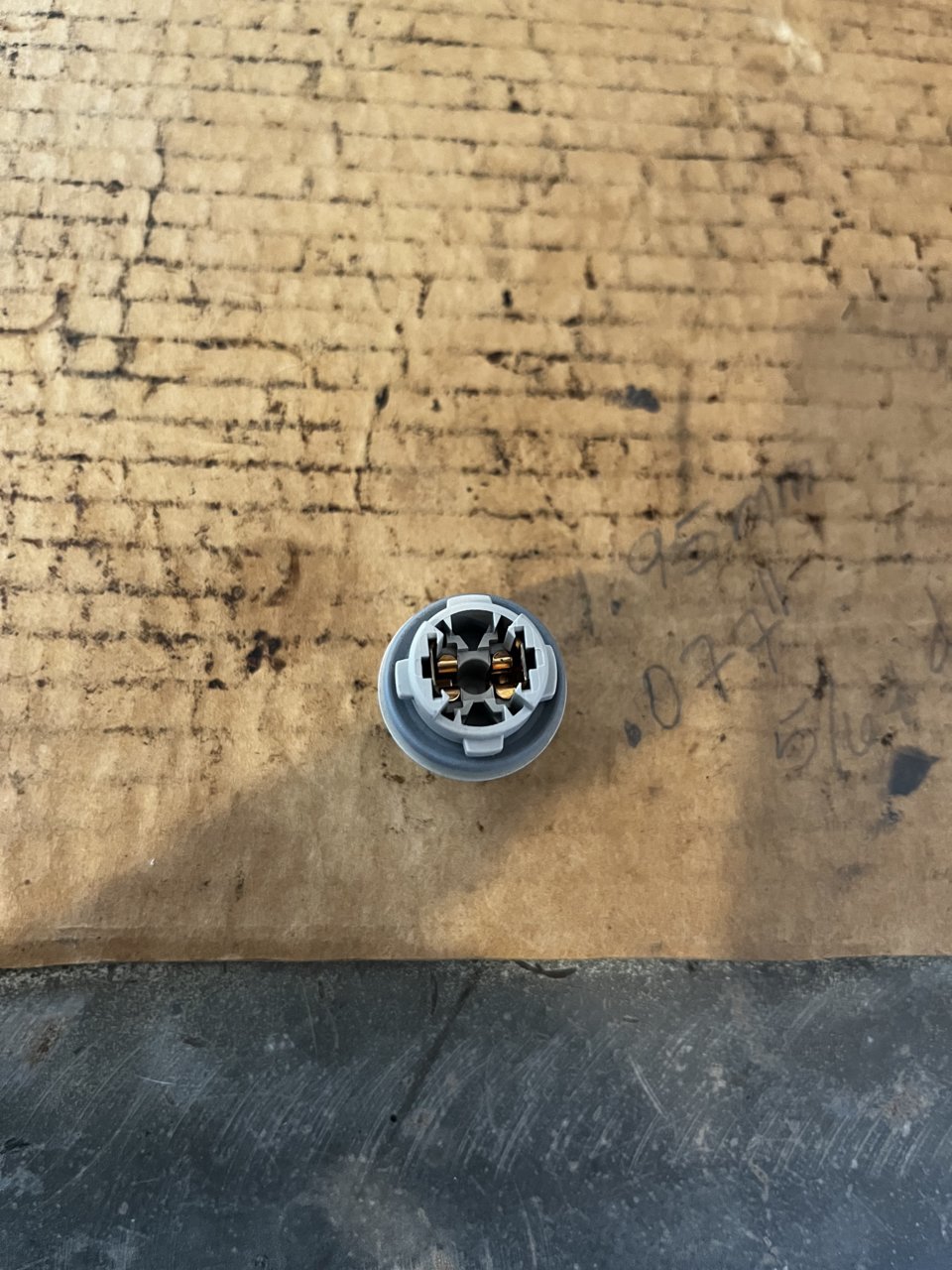

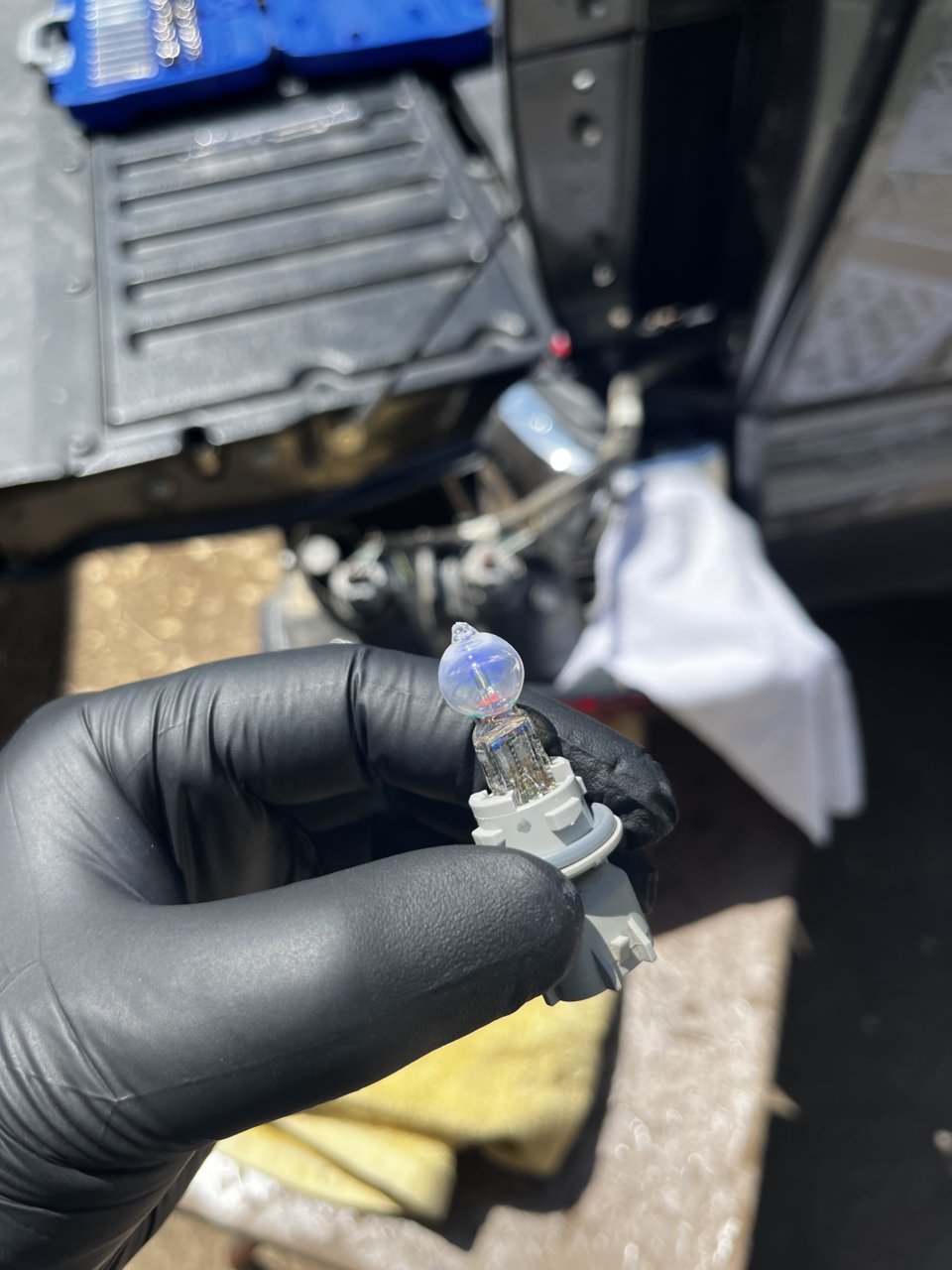

    Sorry, I haven't been online in a while. But yes, those are the bulbs and they are great. So much better than stock. I didn't bend the prongs on the bulbs at all. I just used a small screwdriver to slightly tighten up the tabs in the sockets. Slipped in with a firm grip.

    @crashnburn80 Received my bulbs today. Question: Are the prongs really brittle or somewhat pliable? Trying to avoid breaking a prong. Is nudging the female receiver tabs over preferred? TIA

    They are very sturdy in my opinion. I would use pliers though.

    Thanks. Sound fairly sturdy but bends with needle nose pliers. Perfect

    I think I did a little of both. Bend the prongs so there’s a curve and push the female connectors closer together.

    Ive probably done close to a 1000miles of forest roads and tons of those washboard roads your talking about. Havent had an issue. I also find that bending the metal tabs in the bulb socket to hold the bulb tighter to help alot.

    Many multi-day off road trips with that setup and zero issues. Bend the tabs to lock it in place and it will stay seated just like stock.

    I was on the fence like a lot of you. It’s not a bad as a job I thought it was. The prongs can handle the job needed to bend them. I was afraid of breaking one. No chance. Done.

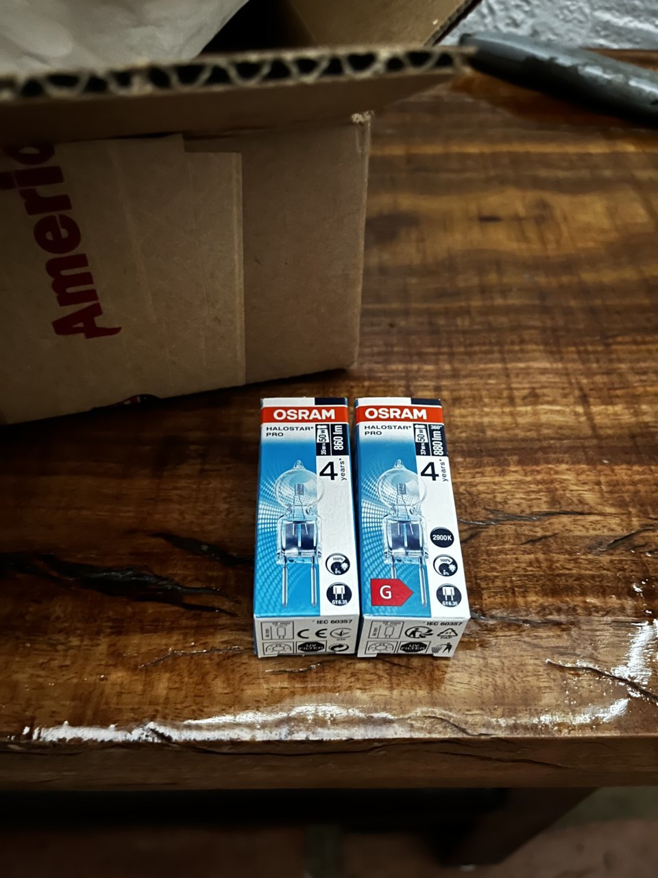

    These look like two different bulbs. One says 37W and 880lm; the other 35W and 860lm. I also received the 37W/880lm set from Amazon and there are mistakes and inconsistencies around the box. Is it possible these different ones are knockoffs?
    Product images on the manufacturer's website show the 35W box to be original.
