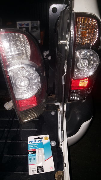

    Odd the specs seem the same as these (465 listed on the label) that I used but if the Philips site says 600 perhaps they figured out a way to squeeze some more lumens out with the same wattage.

    Nope, different part numbers. The 600 lumen is a T4, the 465 lumen is a T3. Both look the same and draw 35w, with the same dimensions. Still trying to determine the difference.
