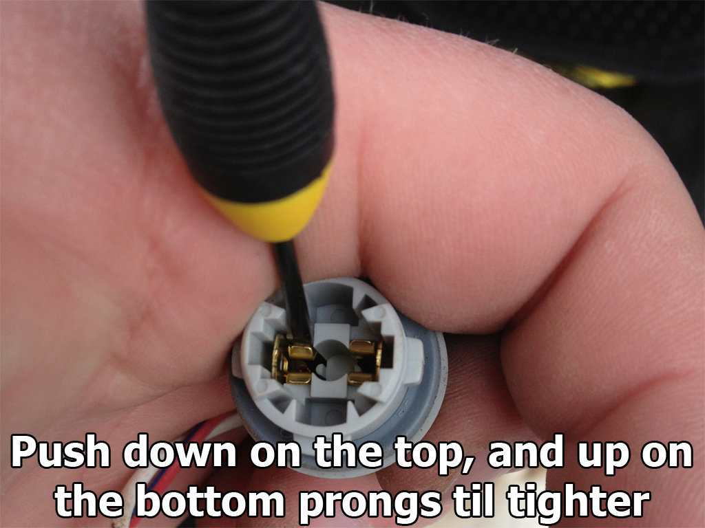

    Bend plug prongs not bulb prongs. No worry on breaking bulb then tighteningProngs_zps32cef947_a9ff4e1ac812a336aff67aedea9a3ac97367e231.jpg

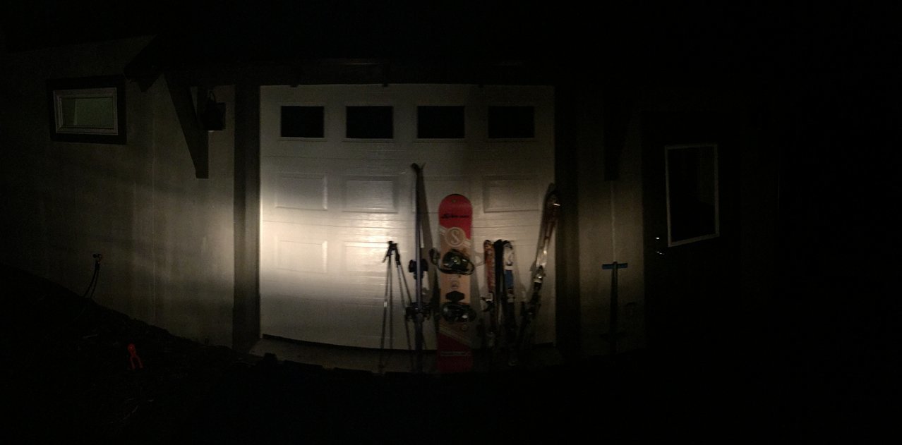

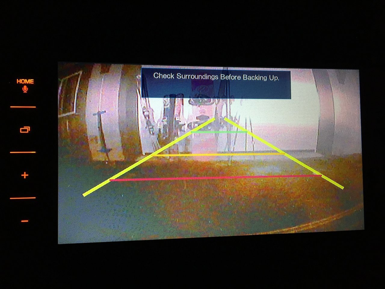

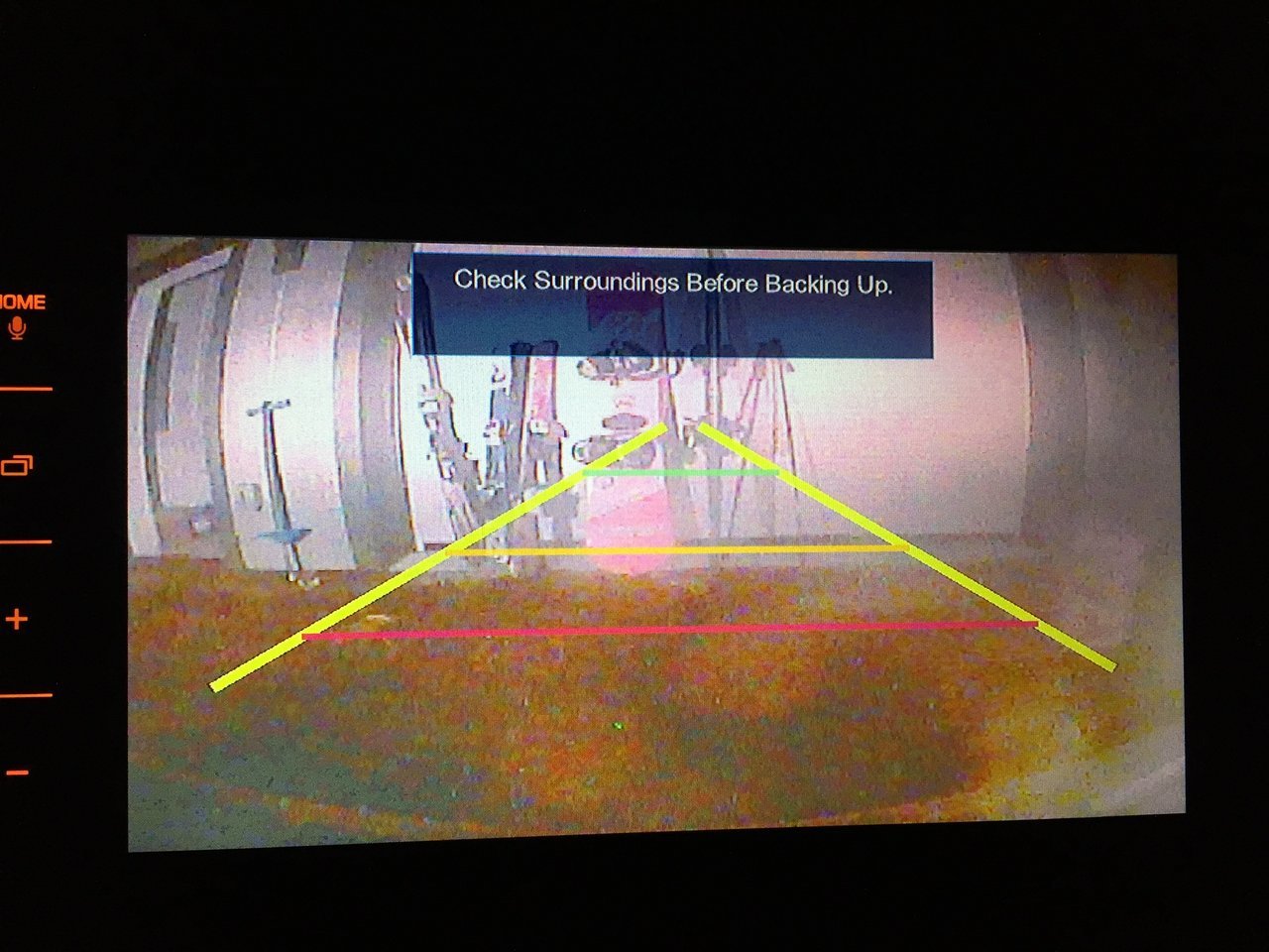

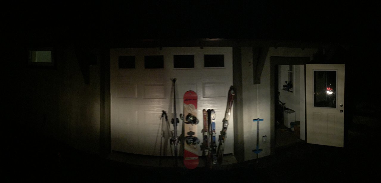

    I ordered them, bent prongs out, put them in, and brightness is MUCH better! It’s plug and play, just use link above to order. Can bend bulb prongs or plug prongs I guess.
    Pics attached show difference between OEM and the new bulb. Then I swapped to see difference again. Also took shots of backup camera - improvement there too!
