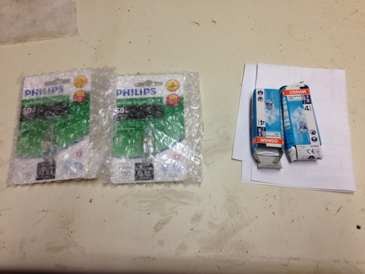

    About halfway done...
    Thanks, @crashnburn80
    I ended up getting the Osram 35w first then saw your new link to the Philips 30w. So I got those also mainly thinking less heat from the Philips would be better.
    The Osram35W arrived crushed in a soft envelope. Not ideal but bulbs where undamaged.
    The Philips30w arrived in a box. Then I installed. Definitely brighter but don't have a light meter to prove it.
    For install bending, the socket prong worked well, nice snug fit.
