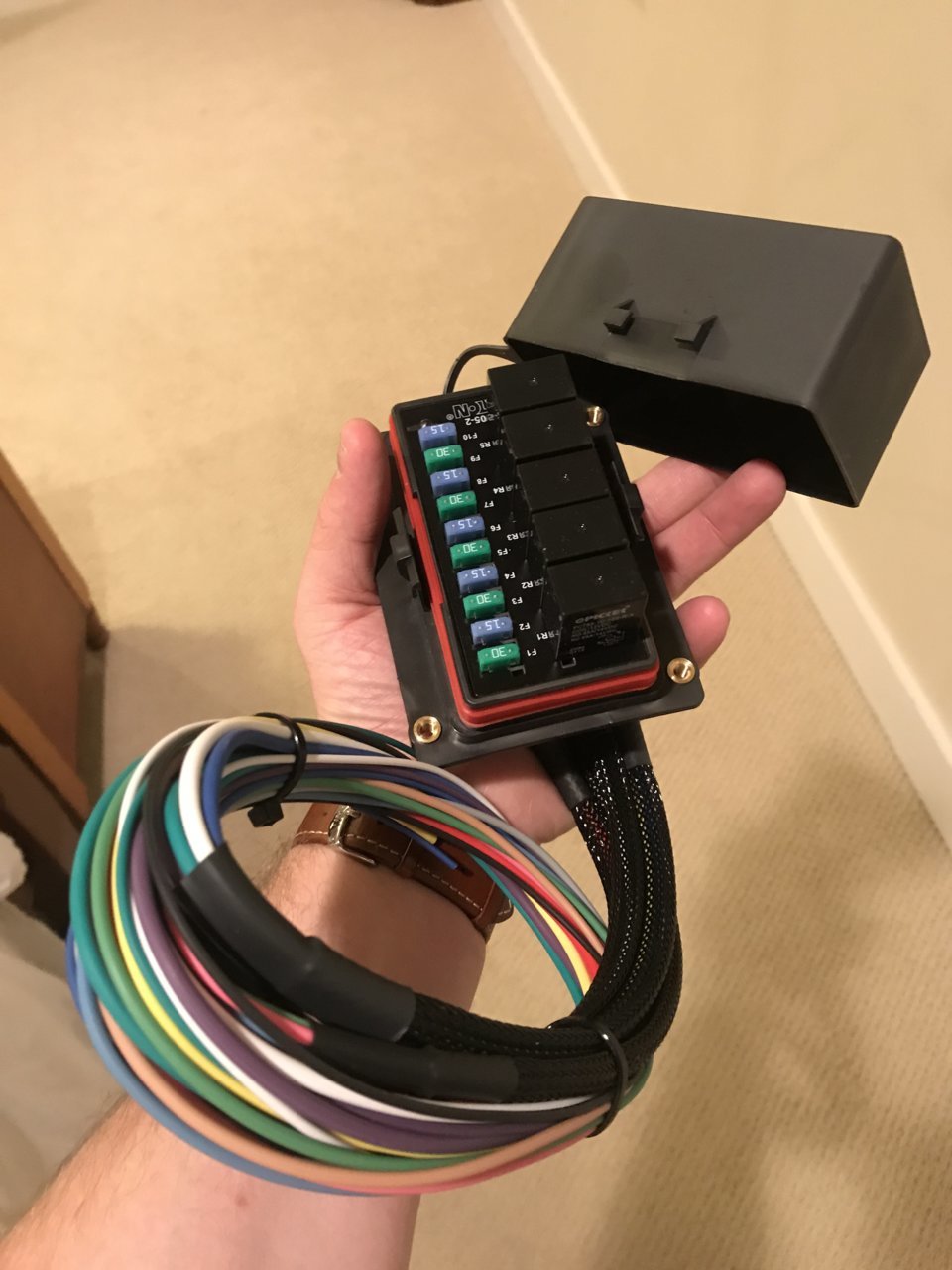

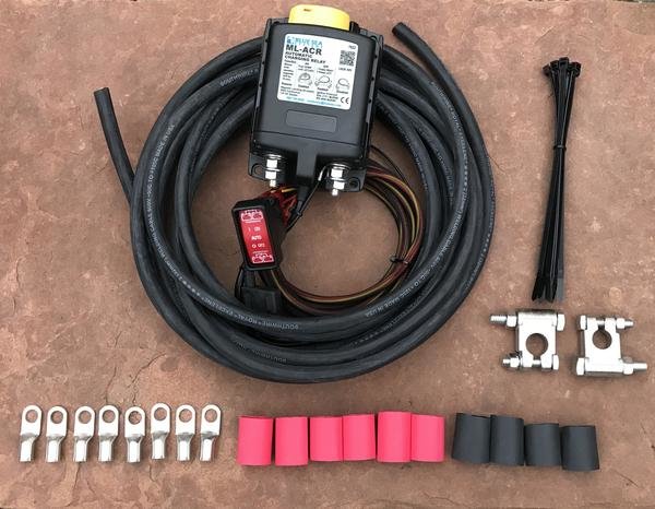

    Yep, that’s definitely getting done. This is all in preparation for my Bussman fusebox, my Blue Sea dual battery set up and a bunch of other components that are going on as soon as I get home from Brazil!

    Nice I went through all this last year. Got the same Bussmann, high output alt and big 3
