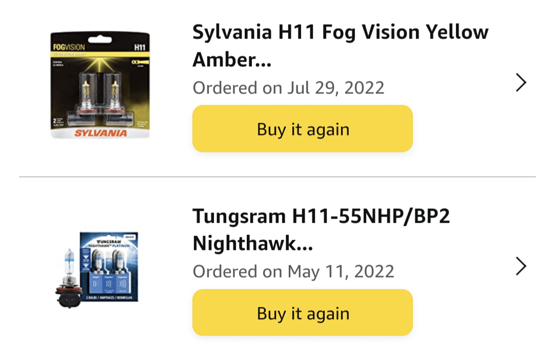

    No. Connector is fine. It’s trying to seat the 4 tabs. If I can get the H16 out, and take a pic. The two are identical. It’s bizarre. Just wondered if it was a bad pack of bulbs or not. Doubt it. But never know.

    Those are the exact H11 Yellows I have. Lol. I’m baffled. Seriously.
