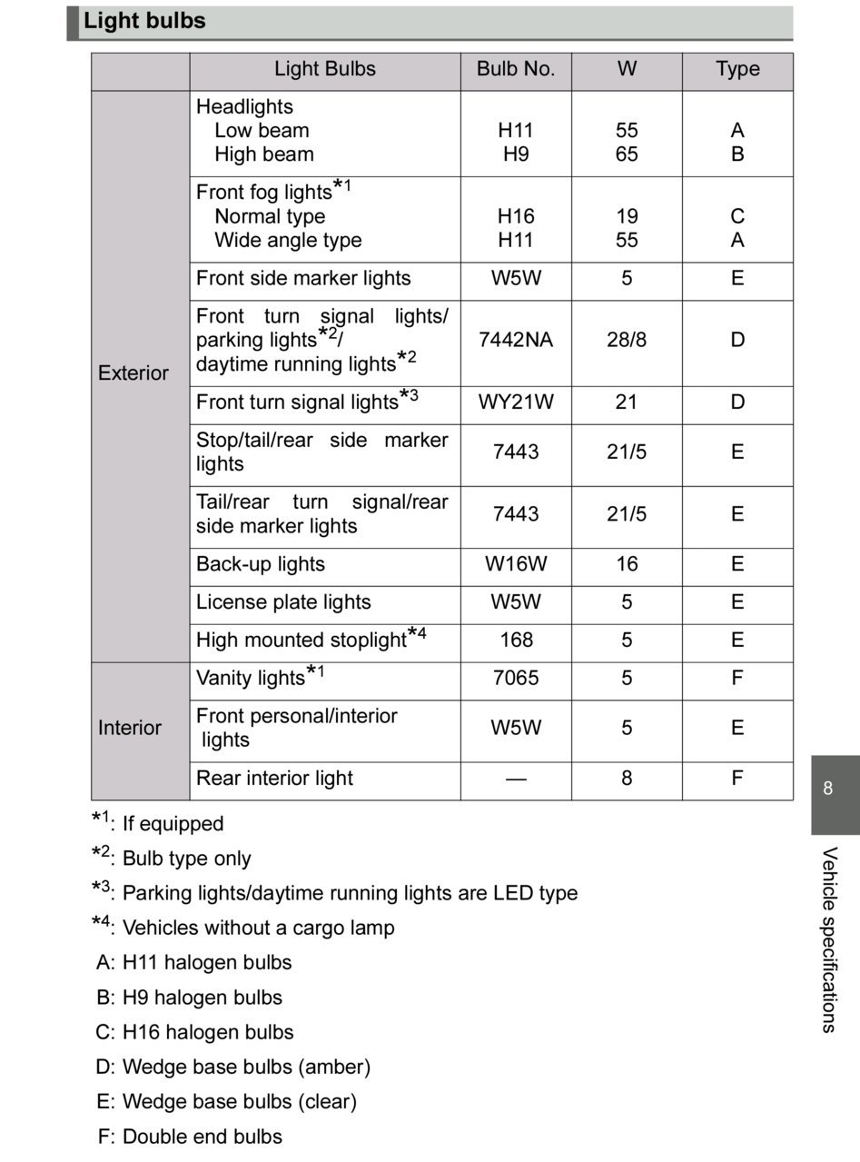

    Below is what my 2020 owner's manual says. This should squash any assumptions.

    Thanks to @crashnburn80 for the following info:
    The 2005-2011 take H10
    2012-2015 take H11
    2016+ SR5 take H10 - Edit: This should be H16
    2016+ TRD take H11
    OP, your 2018 TRD should fit the H11. For what ever the reason it doesn’t fit, that’s weird (Maybe during the assembly line the person grab a H16 only connector and/or light housing and put it in your truck? Or the bulb you got been mislabeled? I’m only guessing lol)

    Canadian 2016-2019 trucks didn’t get the H11 fog lamps, only H16.
    2020+ trucks with halogen fog lamps got H16 only as the “upgraded” lamps are OEM LED.

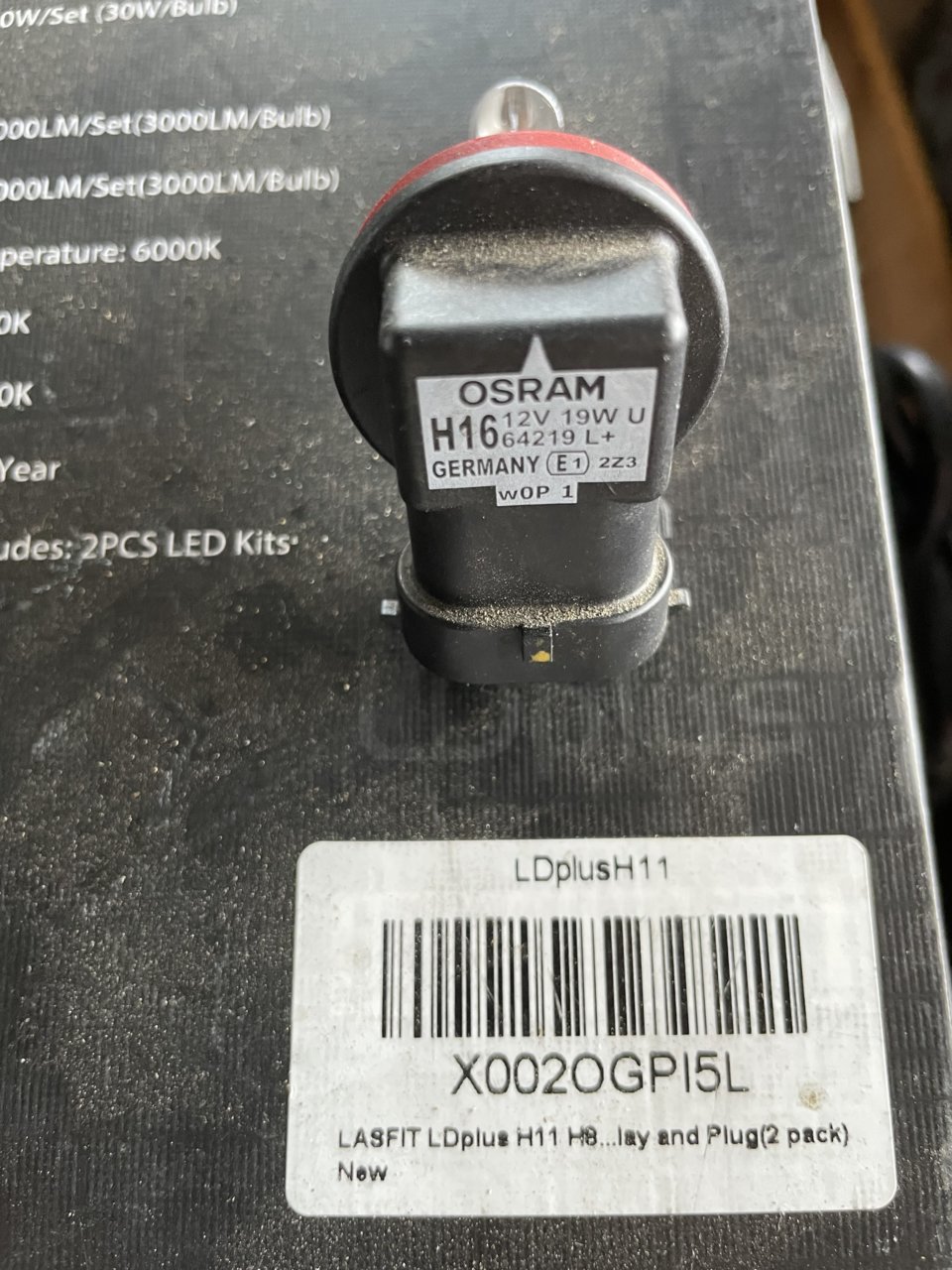

    Yeah, both of my bulb (fog & low beam) said H11 on the box. Even the manufacturer’s website said it fit for both H11 & H16. Man, there must be a mix up somewhere. Now I’m confused lol.

    The two bulb types share the same (or at least very similar) base dimensions. However the size of the glass envelope and the filament placement are not the same. An H11 should not be used in a lamp meant for an H16 bulb, and frankly the performance of an H16 lamp is so low there's no sense trying to chase for an upgrade bulb, when the OEM H11 fog fits the same, has a much wider, higher intensity pattern, and also has the ability to properly utilize any of a large variety of high performance bulbs.
    You should not use PnP LEDs in any halogen lamp assembly. There are seberal exhaustive and detailed test and compsrison threads authored by Crashnburn80 that show time and again they fail to perform as well as nearly any standard output halogen bulb of the same type.
