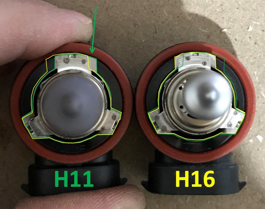

    Difference in bulb.
    Some housing the slots are cut different so that why they might fit. Easy fix with a small modification.

    Yea man!! Great illustration right here.
    I went through all of this last week lol H11 DEFINITELY does not fit on some of the non-TRD Tacos at the fog position

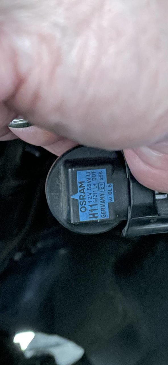

    Glad I read through this very confusing string of posts. I was about to order new H11 lights the fog lights in my 2017 TRD Sport, but now I have no idea what I have currently. I will remove a bulb this weekend to check to see what size is currently in there.

    I just went outside and removed a fog light bulb on my 2017 TRD Sport and it does have H11 bulbs in the fogs.
