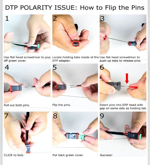

    CaliRaised sells them, you might have to take the connector apart and reverse the wires to correct for polarity. Been using mine for over a year with no problems.

    Are the Cali Raised and Rigid polarities reversed? That's the reason I need to swap the pins?

    LED polarity (I'm no electrician)? I bought the CaliRaised pods and they wouldn't work after plugging them up, reversed the wiring in the connector and they came on.
