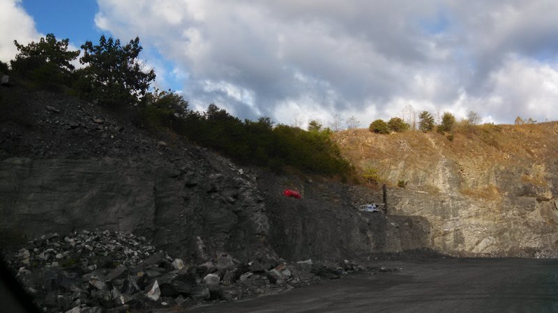

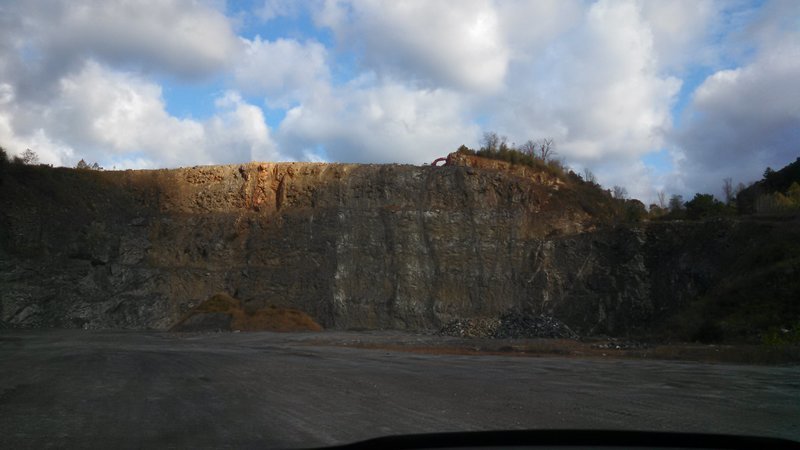

    HaHa used mined yesterday and most weekends going to quarry. Had to go to the top was at bottom getting 1 ton of rip rap.
