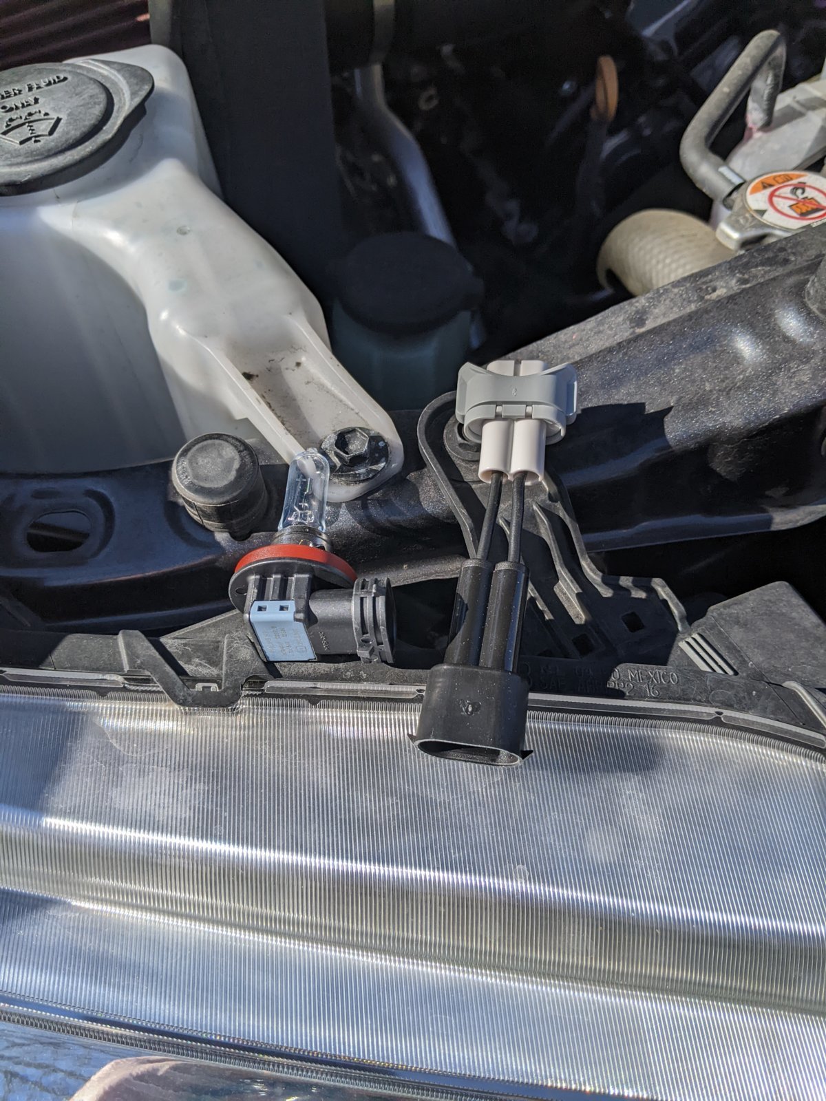

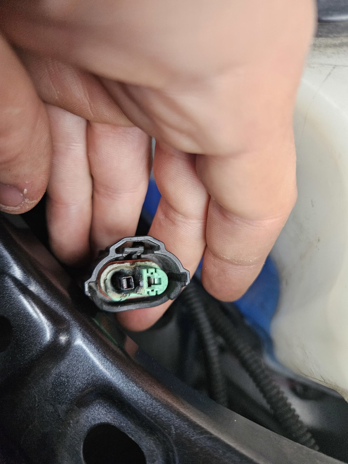

    Noticed last week after I put the new H9 bulbs in my low beams that it kept shutting off.
    I hit a bump and it would come back on and then it finally shut off.
    I checked it today and this is what I found.
    What would be the correct fix for this?

    that connector need to be replaced, those contacts are shot

    If there’s too much corrosion maybe best to cut and rewire a new connector.

    I currently am using a Phillips bulb. I know it's my fault that the connector failed. I looked at the bulb and noticed the tabbed wasn't completely shaved off. So it wasn't making a complete connection

    You should of pulled that green insert out of connector, instead of shaving tab. Plugs right with green insert removed.

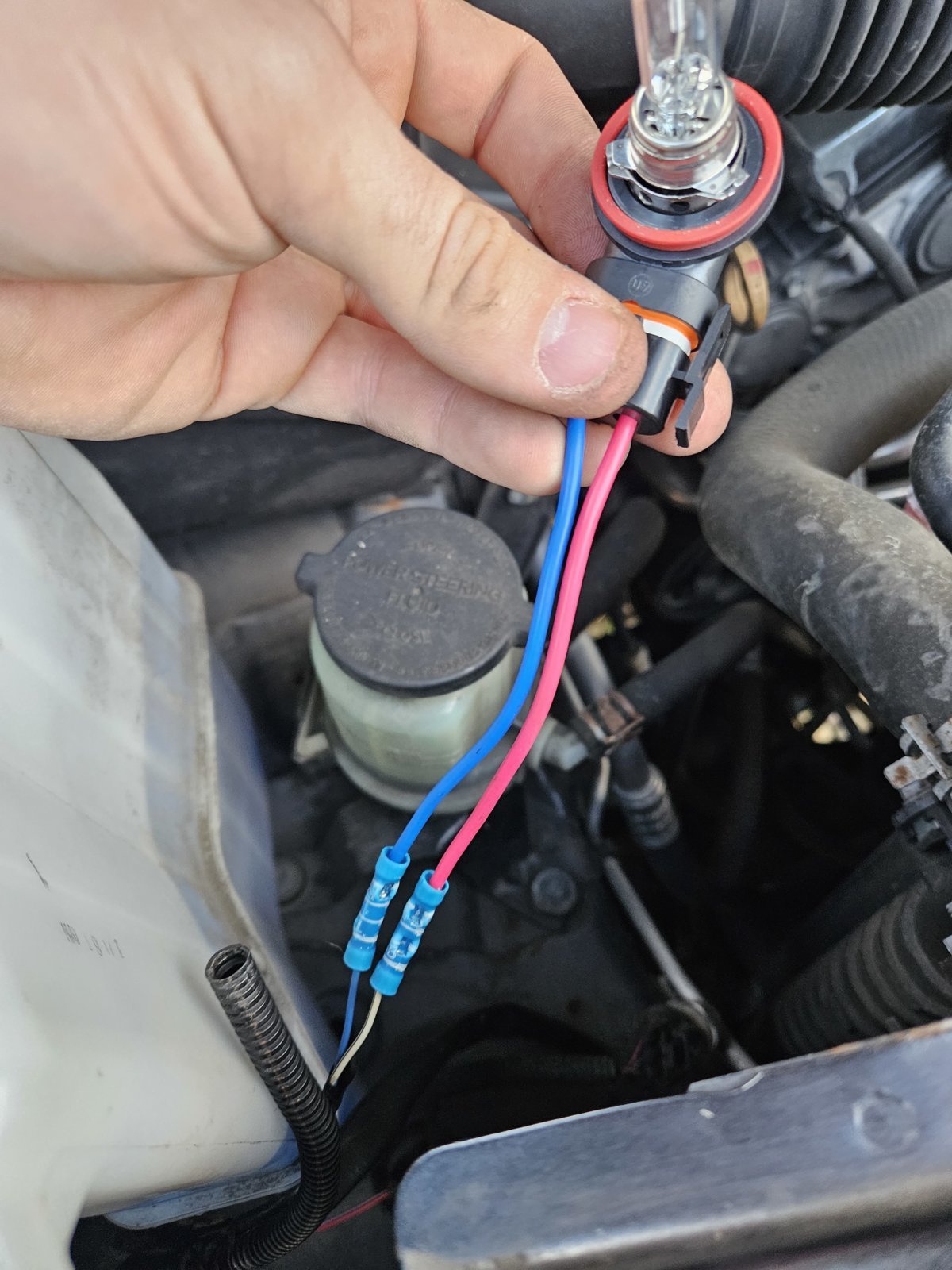

    Am I wired right? I turned the lights on and still didn't turn on.
    I thought blue wire to blue wire and red wire to white wire.
    Edit unwired it and switched the wires and I still don't have a bulb that turns on.

    incandescent lights don't care about polarity
    doesn't look fully seated to me
    remember to seal up those crimp connectors
    got a test light or voltmeter to check for voltage?

    That's what I thought. I'll check the bulb later when I get home.
