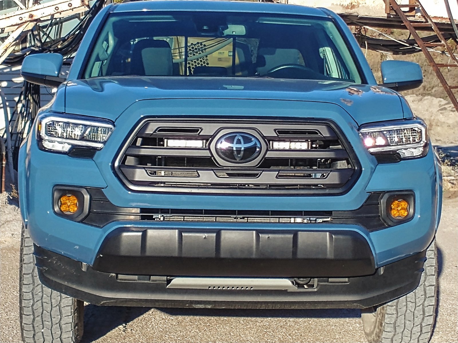

    drom DD
    [​IMG] [​IMG]
    here: https://www.diodedynamics.com/blog/stage-series-the-best-led-light-bar
    go with a brand known for lighting that stands behind their product not one that rebrands cheap lights (they don't last)
    the Aux high thead https://www.tacomaworld.com/threads/the-sae-j581-aux-high-beam-thread.696597/#post-24638990
    the fog thread https://www.tacomaworld.com/threads/the-led-sae-j583-fog-pod-fog-light-review.554813/

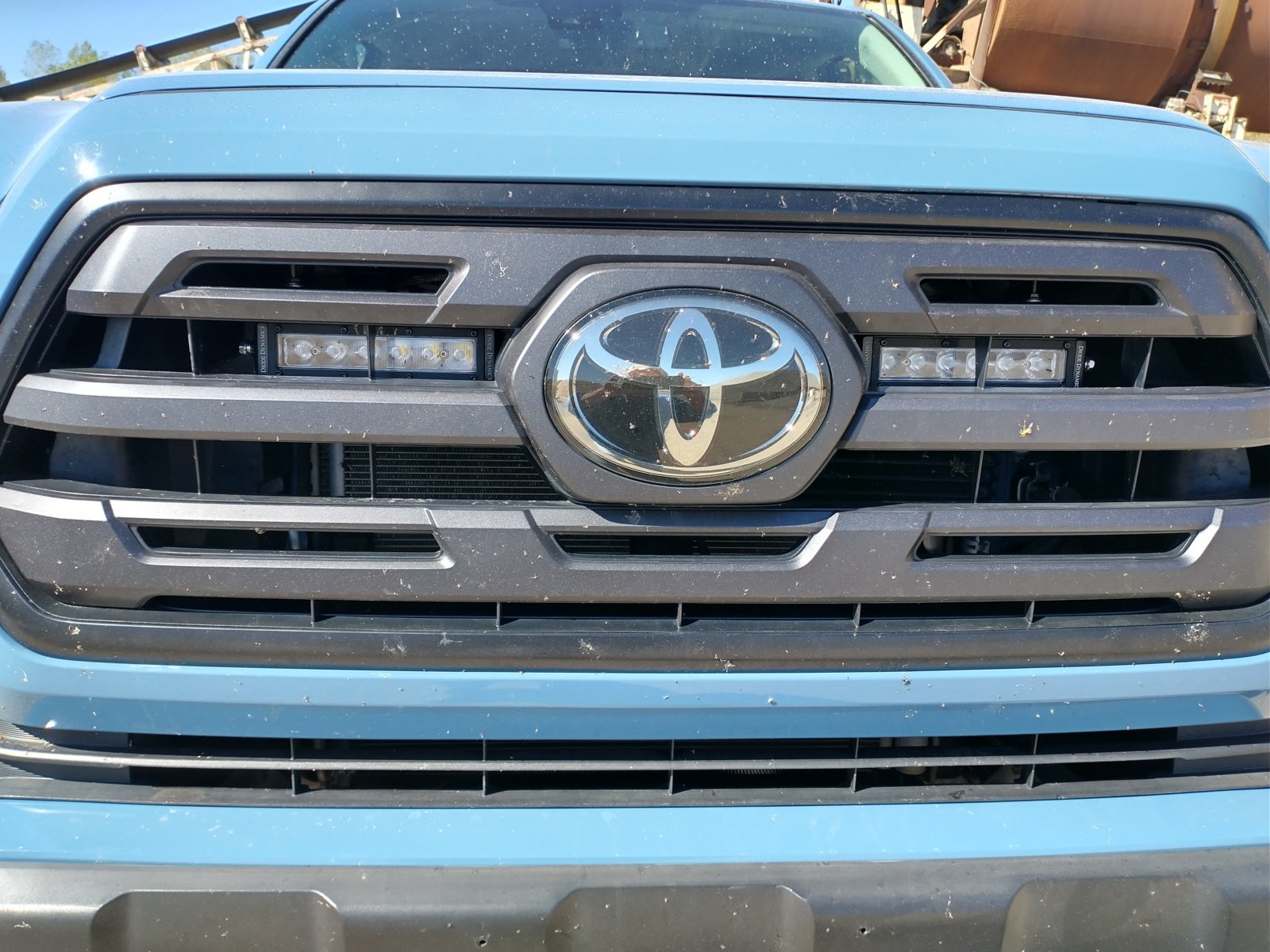

    Two Diode Dynamics 6 inch Stage series light bars in driving pattern hung using a BAMF mount and tied into the high beams on my '19 SR5. No cutting of the grille required. These things are BRIGHT and really light up the road here in deer country. If I'd put them on first before installing the LED headlights I could probably have saved 1400 bucks.:anonymous:
    Not that I have any intention of going back though.IMG_20231017_082922646~2.jpg
