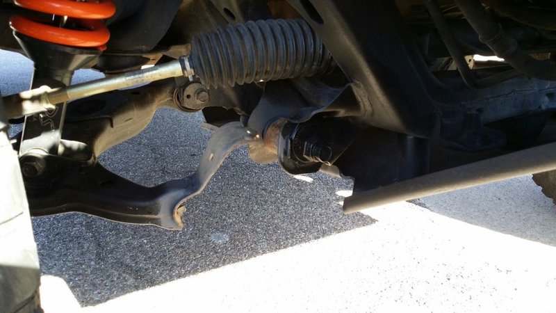

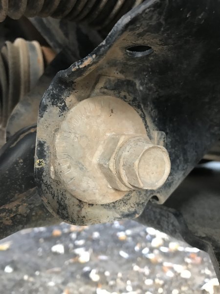

    Working on the truck today before the game... noticed this...
    Ugh, looks like I'll need some new cam tab gussets... My lowers are the originals so maybe it'll be a good excuse to swap them out too... time to save some $$$.

    I highly recommend some stock length lowers!! I broke 2 separate LCAs and was lucky I didn't do more damage each time. @Dirt King Fab makes some very nice beefy LCAs btw! :cool:

    Was leaning towards keeping em OEM, simply for cost reasons... I have yet to be convinced that LCA upgrades are all that beneficial when riding extended/mid travel suspension. Do you disagree?

    Highly! The upgrade to a uniball over a ball joint is a major plus in itself. Not to mention the ease of replacing it in the future. I broke my previous stock LCAs in two different locations, @Kyouto42 did as well similar to one of mine. The way they're welded together, close to the spindle, is scary and there's not a lot of support. The opposite lca to the ones that broke always showed stress cracks at that inner weld as well as the metal surrounding the bushings, which is where mine broke
