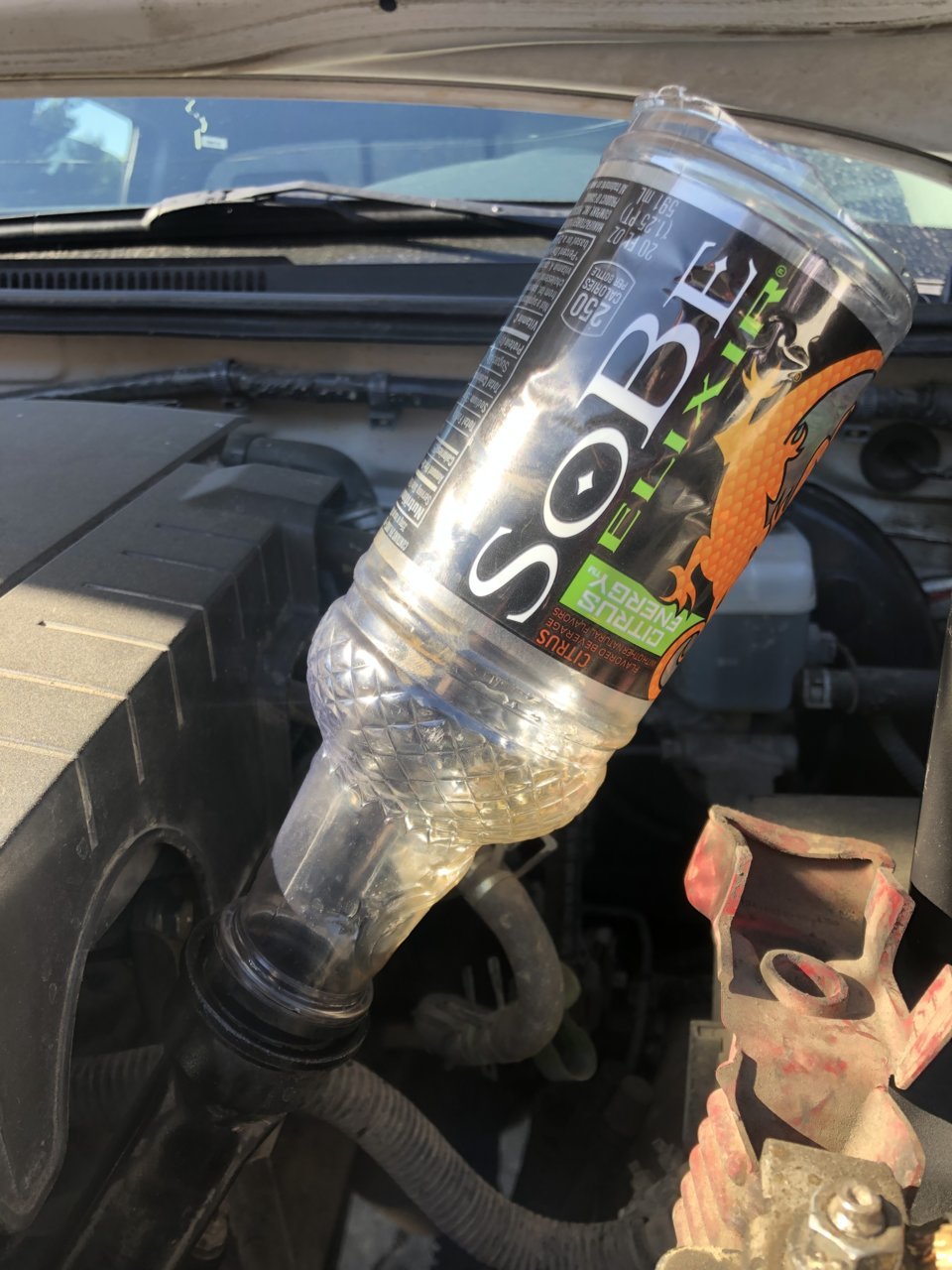

    11592CF4-D3F0-4C85-8F07-8C0ED857A03D.jpg Sobe bottle screws into the filler neck. Solid and you don’t have to hold it

    You can do the same with most motor oil bottles

    Quart Gatorade bottle works too.

    The kind I use have really wide openings and could fit over the entire engine so I can’t do that

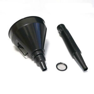

    I bought the $30 Snap-on threaded funnel years ago, and I don't regret it one bit. But I like your MacGyverness. :thumbsup:

    On the topic of bottles.. a Propel 16.9oz bottle is just tall enough to wedge under the oil filter drain tube. Once you stick the tube into the mouth of the bottle, it'll stay put.

    You can purchase a funnel from the auto parts store that screws into the opening.

    A Mobil 1 bottle screws into the fill neck and wedges nicely under the oil filter drain nipple. With some trimming, it'll even hold the 5 quart bottle upside down to get every last drop.
