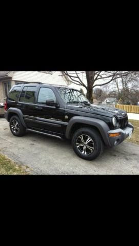

    I came across an opportunity on kijiji.ca .. a set of 5 RTX Arsenic (who names these?) 16" alloy rims, advertised with 235/70R16 Goodyear Wrangler ST's, with about 1 summers worth of use on them for a very decent price, and picked them up.
    When i got them home, i noted that they were mis-represented in the advertising, and were really 225/75/R16's. No real biggie .. at least i hope 29" vs 29.3" diameter difference is no real biggie. The RTX Arsenic rims have a back-spacing of 42mm, and a center-bore size of 73.1. Obviously intended for Jeep products, these were formerly on a 2003 Jeep Liberty.
    I tried to do a test fit this afternoon - but it appears that when i had the dealership put the spare on last month, they failed to put anti-seize on the hub, and it's stuck fast. I whaled away at it with a rubber mallet, with no results. I noted another forum post about this issue, the solution being "kick it loose" .. not really an option for myself, as i've got still dodgy hips after less than successful hip replacement procedures. So, i sprayed the Hell out of it with WD-40, and buttoned everything back up again for now - putting my new rims in the back of the truck to go to a shop for a consult sometime this week.
    Jeep Liberty that they came off of.
    In consulting a tire shop that i patronize, I have a few questions that I hope to resolve prior to an actual installation attempt - one is about the possible need for extended/different lug-nuts, going from steelies to alloys. The other one, is whether i'll need a nominal hub spacer with going from a 6" width rim, to this 7" width rim assembly, and in relation to the 40mm vs 42mm back-spacing. Theoretically, it shouldn't be a big difference.. but i'm not all that knowledgeable in these things when put into practice.
    I have noted successful implementations with both 235/70R16 and 225/75R16 tires on our 5-luggers, with no need for black-box amputation, or rubbing issues - but not on these specific aftermarket rims.
    The whole aim for going this route - was the opportunity knocking, in light of my OEM tire's general condition. I highly doubt that they are going to last out this summer. I would also like to use the OEM steelies to mount snows for next winter - i certainly could have used them this past winter in the land of 5 months of winter, and 7 months of bad snowmobiling... As mine is a Base package Tacoma (Broke Arse, Special Edition) i would like to avoid going the Full Monty with a lift kit, Billies, etc.. at least in the short/medium term.

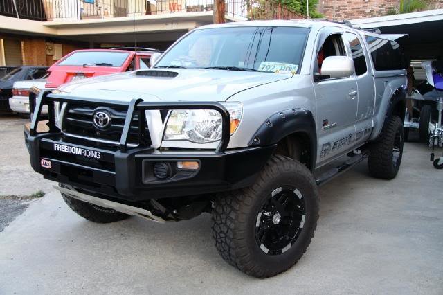

    Apparently my recently installed Bull-bar is pretty much toothless as a passive-aggressive warning to those who would trespass against me, as well as being functionally useless .. those who need to pay mind, aren't.
    .. After the umpteenth time in the past few years of playing the highway commute game, and having some happy asshole try to merge into my front bumper/fender in some sort of perverse squeeze-play.. this morning, I've finally had enough. The bastards can get Pitted into the ditch, for all that i care, from here on out.
    Wanna play games with this, mofo's?
    ARB front *this will seriously fuck you up" off-road bumper, now on order. (Sample photo, only).
