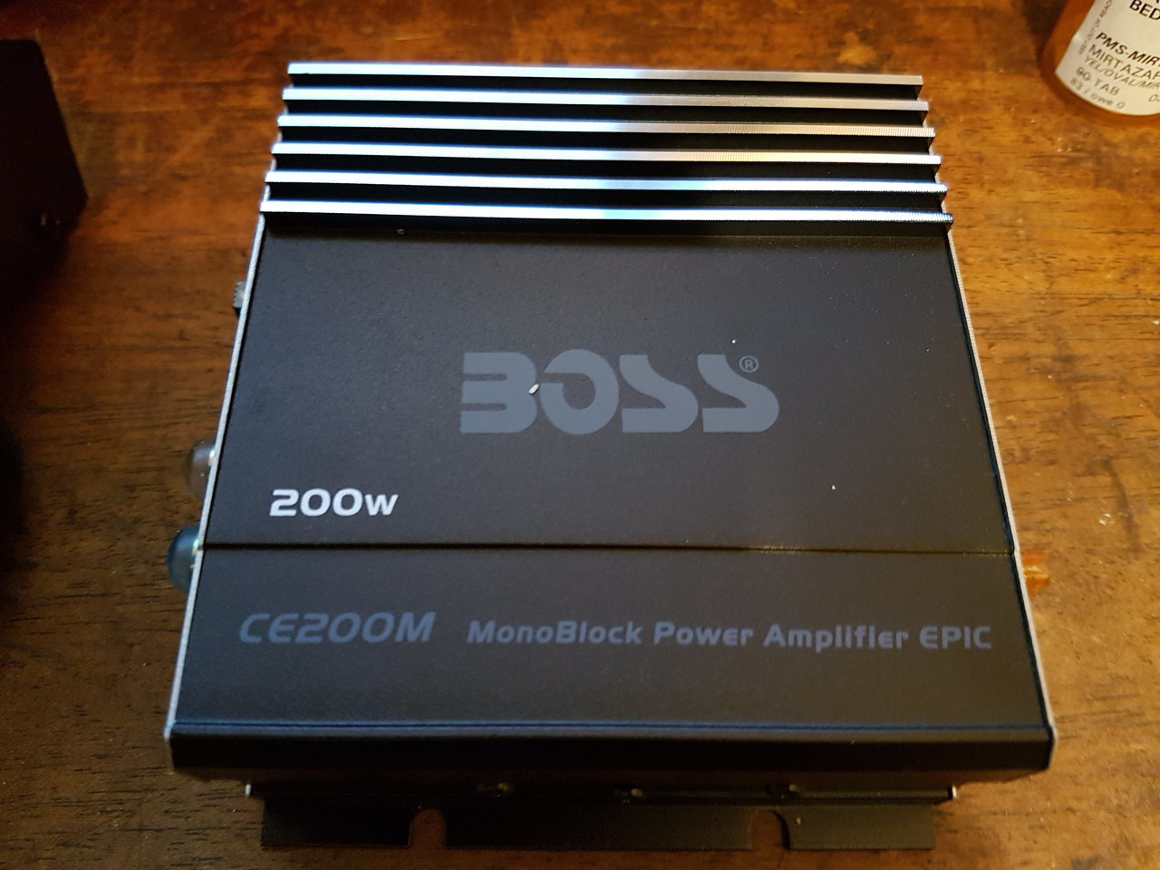

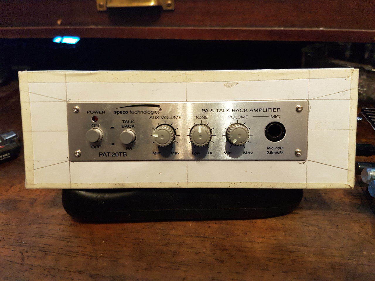

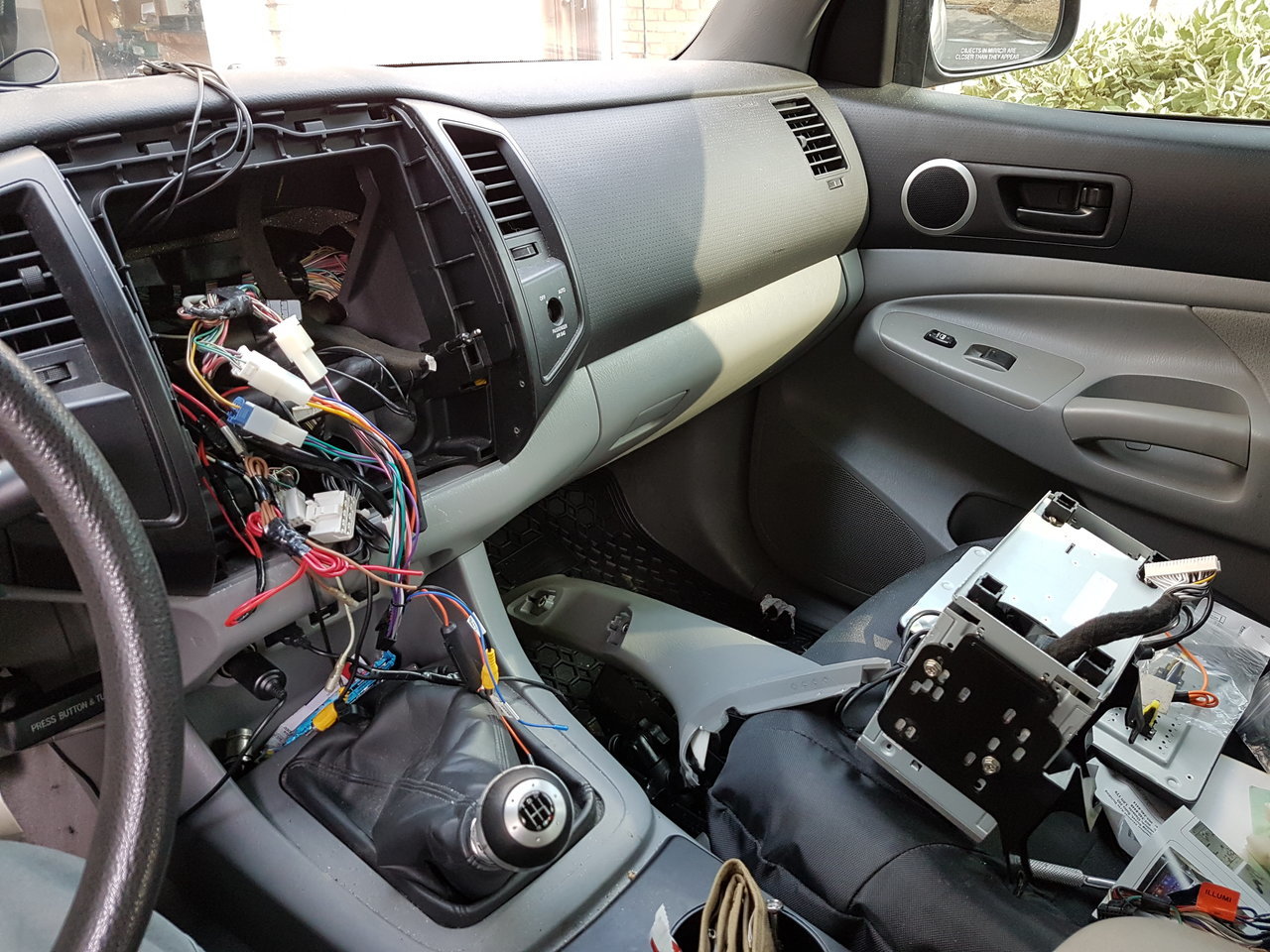

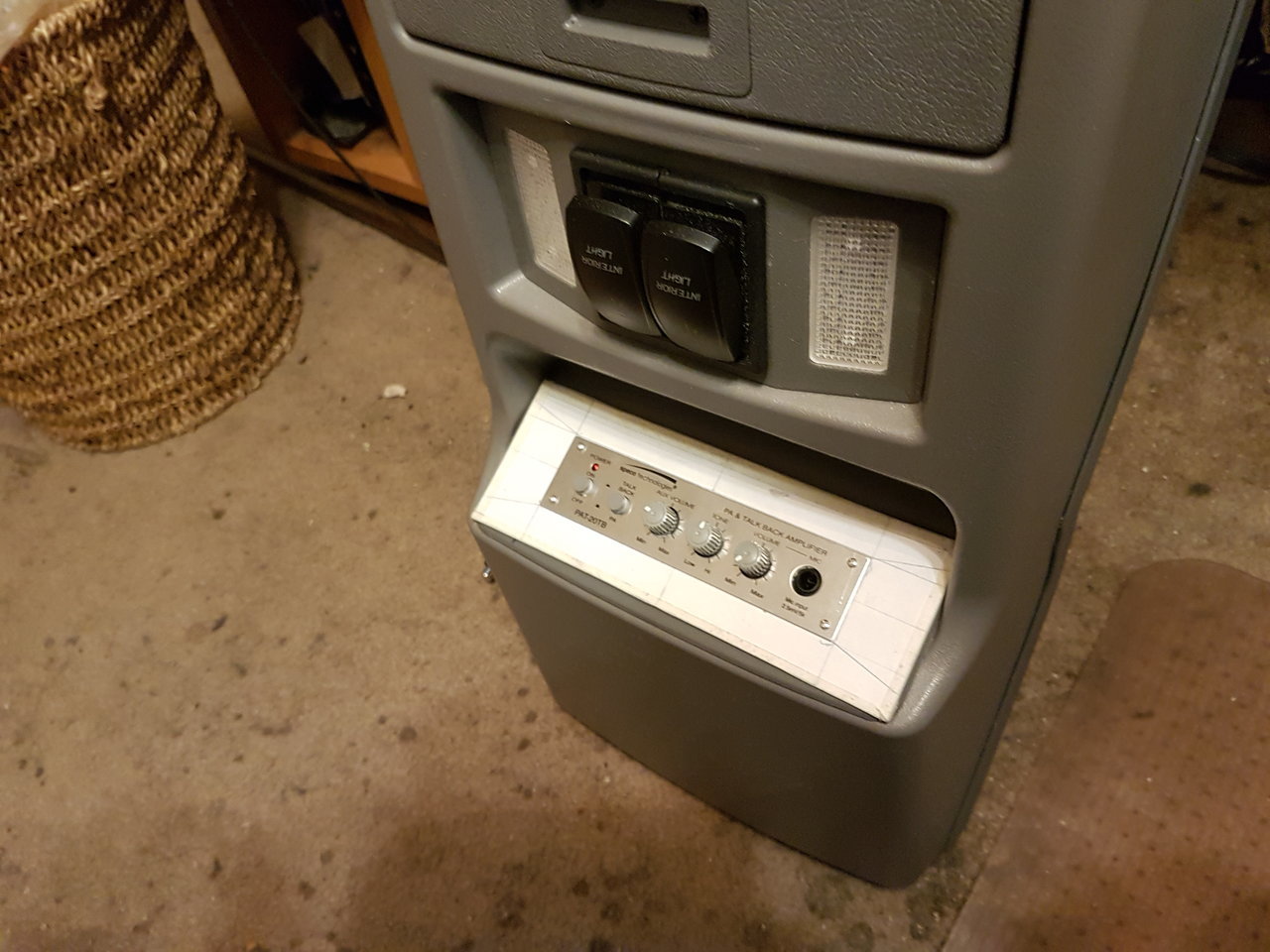

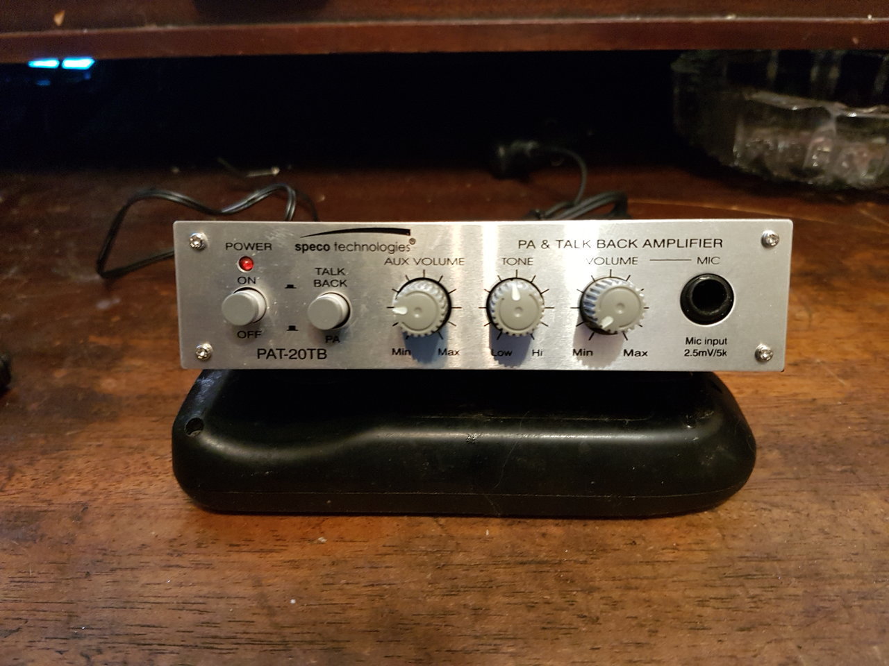

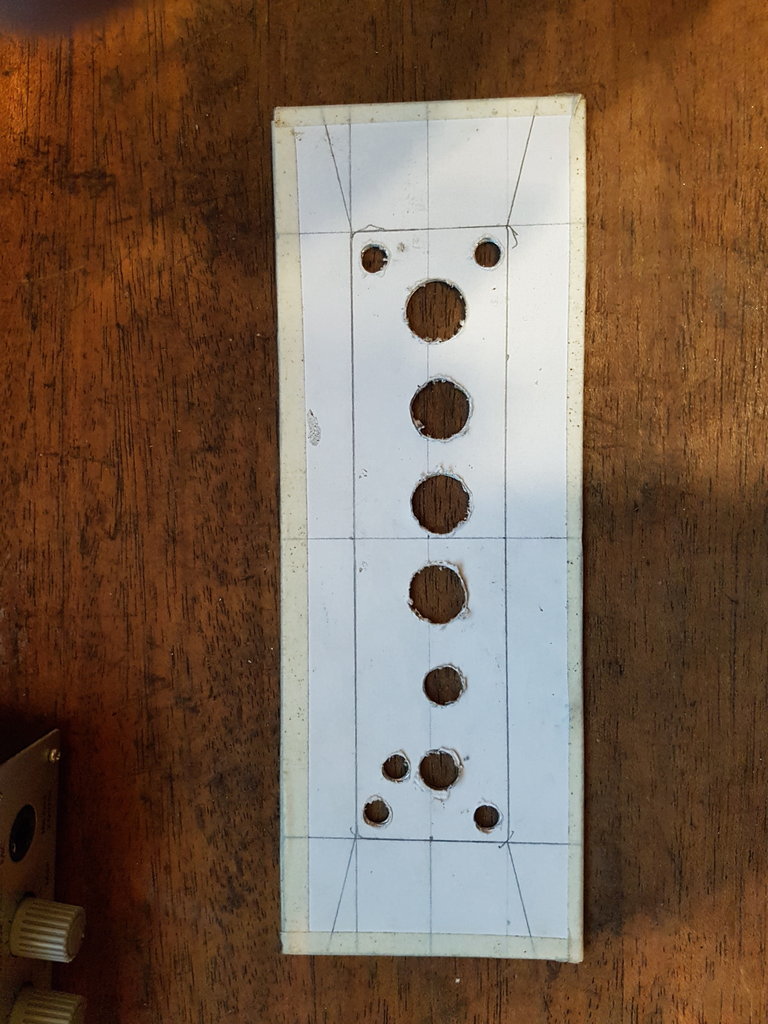

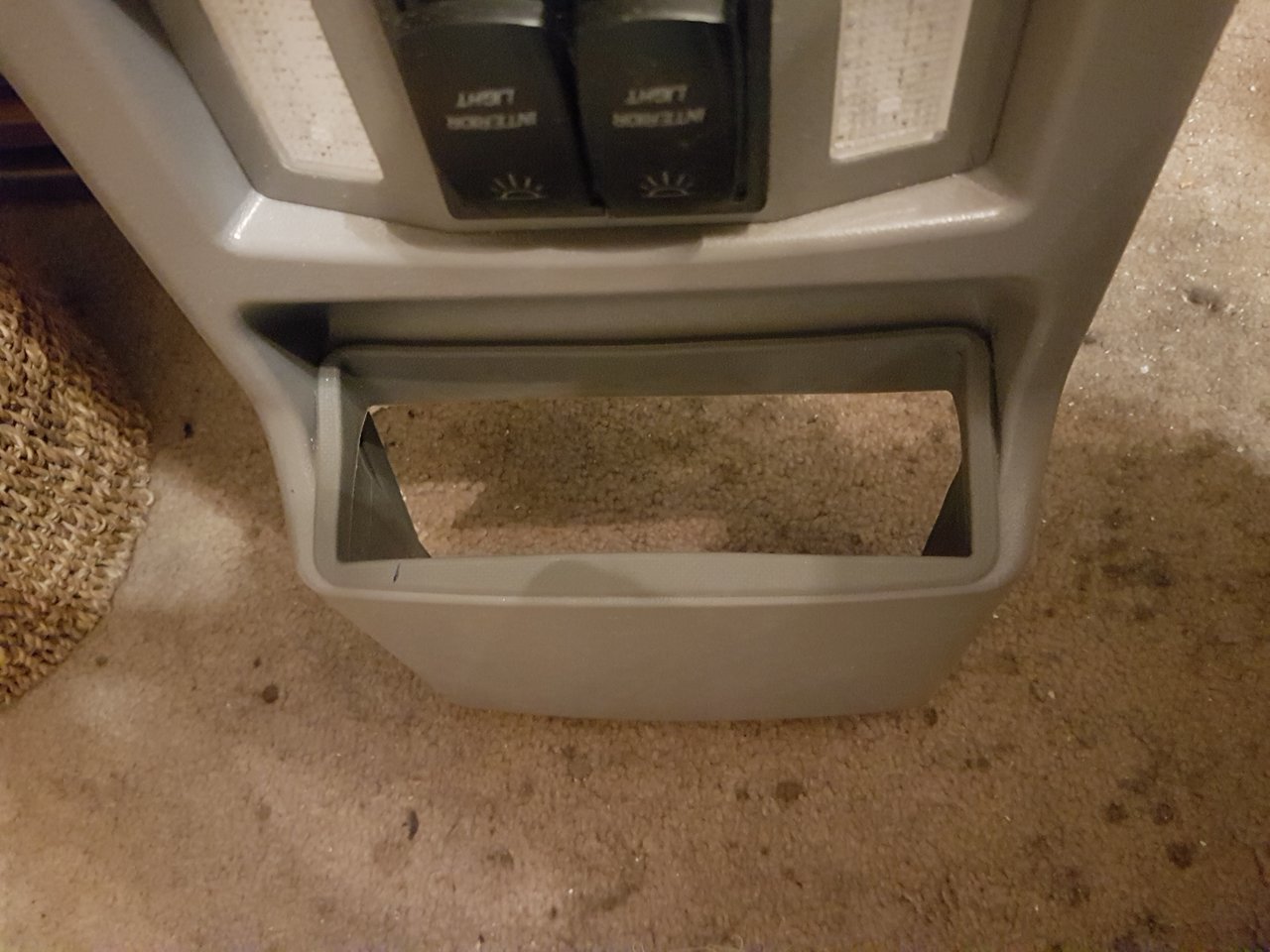

    Now going on to finishing up the various components of the interior .. hopefully before the temperature drops. and the potential for consistently bad weather rolls in with the fall. This also a form of physical therapy to get my busted shoulder mobile again.
    I actually don't foresee using some of these add-ons on a routine basis - it's more of a case of i've always wanted a vehicle with a proper interior setup to my tastes, and this is my opportunity - the one that i am focused on right now, is a 200 watt PA system installed into the overhead console - the added complication is that i'm adding Arduino into the mix, and learning the electronics end as i am going along. I need to get the total electronics package sorted out, before i can form-fit and install the completed overhead console itself. This is very much an exercise in skills and knowledge development.
    I needed to make a simple backing plate, to hold the small PA box in place, into the DIN slot, out of 1/16" aluminium plate.
    I'll post up more, as i make further progress.
