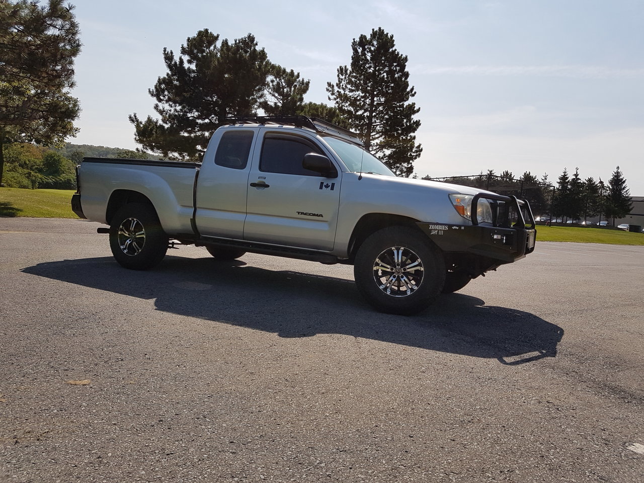

    *boom* - Tires ordered. 4wheelparts have a sale on them, so i am going to be taking a chance on the Pro-Comp AT-Sport 235/85R16's.
    Updated project list .. the original post has fallen more than a few pages back now, and i'm going to be cleaning the thread up some in the next little while, to reflect a project at completion, rather than being a running-build log.
    • RTX Arsenic 16x7 +40 offset aftermarket rims - used - kijiji.ca
    • 225/75R16 Goodyear Wrangler ST tires - used - kijiji.ca
    • ARB Deluxe front bumper - new - 4wheelparts.ca
    • Fab-Four's rear bumper - new - 4wheelparts.ca
    • Weathertech in-channel window visors - new - 4wheelparts.ca
    • Toyota OEM Intermittent windshield wiper module
    • Kenwood DDX-470 with wired in switchable-on rear backup-camera mounted on Prinsu rack
    • MicTuning Toyota pattern switches, additional USB dash ports, LED cabin lights, RAM accessories mounting system, Birddawg Industries Tech Deck, Mirror relocate mounting dash-cam, Tablet-based GPS/OBD2 Monitoring.
    • Extang Trifold Solid Cover - used - kijiji.ca
    • Toyota Accessories OEM cargo bed divider - used - kijiji.ca
    • ReadyLift SST 2.75/1.75" spacer/AAL lift kit
    • Bilstein 4600 front struts/5100 rear shocks
      • Passenger side 4600 - Part No. 24-185066
      • Drivers side 4600 - Part No. 24-185042
      • Rear 5100's - Part No. 24-186728
    • Toyota Accessories OEM access cab running boards
    • Labrak light insert replacements with Rigid style LED driving lights for ARB front bumper
    • Prinsu Design Studios AccessRac roof rack system
    • U-Haul Class 4 trailer hitch and wiring
    • Rear Steelcraft tail light guards
    • KC Hilites 6" Slimline Halogen driving lights
    • Toyota Campaign replacement Catalytic converter and mid-pipe assembly.
    • Magnaflow 22" 2.5" i/o muffler - p/n 12586
    • LCE 'Street Performance' OEM-length Header
    • Full exhaust replacement (except catalytic and mid-pipe assembly just replaced in October 2016, under Toyota Service Bulletin replacement program) done.
    • 35% window tinting D&P front side, 20% 3 rear windows.
    • CoverKing Black Tactical series seat-covers.
    • T-Rex Grilles 20936B Horizontal Aluminum Black Finish Billet Grille Insert with '85-90 Land Cruiser 'Toyota' grille badging in Amazon-sourced aftermarket Grille Surround
    • BAMF light-bar bracket to mount KC's inside of grille
    • Prinsu replacement front air-dam with 40" Lightbar cutout
    • Front wheel-well black-box and rear mudflap delete done
    • Environmental control knob substitution with Ebay "cheap mod of the month" done
    • Aluminium and Leather 5-speed shifter mod substitution, with aluminium shifter-shaft sleeving mod done
    • Salvage 2014 Toyota Tacoma SR5 4x4 3rd member with 4.10 gearing
    • Detroit Locker Toyota Tacoma 8 Inch Rear TrueTrac - 913A541
    • Pro-Comp AT-Sport 235/85R16's
    • REPLACEMENT for Kenwood, "Joying" Brand 10" Android head-unit.
    Imminent, or future maintenance-based mods/changes in works:
    • Blue Sea 6-circuit fuse block - Received 18 January 2017
    • Material to re-wrap interior door arm-rests - Received 24 January 2017
    • Outback Accessories Roof Console for Toyota Hilux 2005-2015 - Received 28 January 2017 - mods ongoing, including a built in PA system.
    • Morimoto 40" LED Lightbar with yellow fog inserts - Received 30 January 2017
    • Uxcell sound deadener insulation ordered 29 June 2017 - to do truck roof.

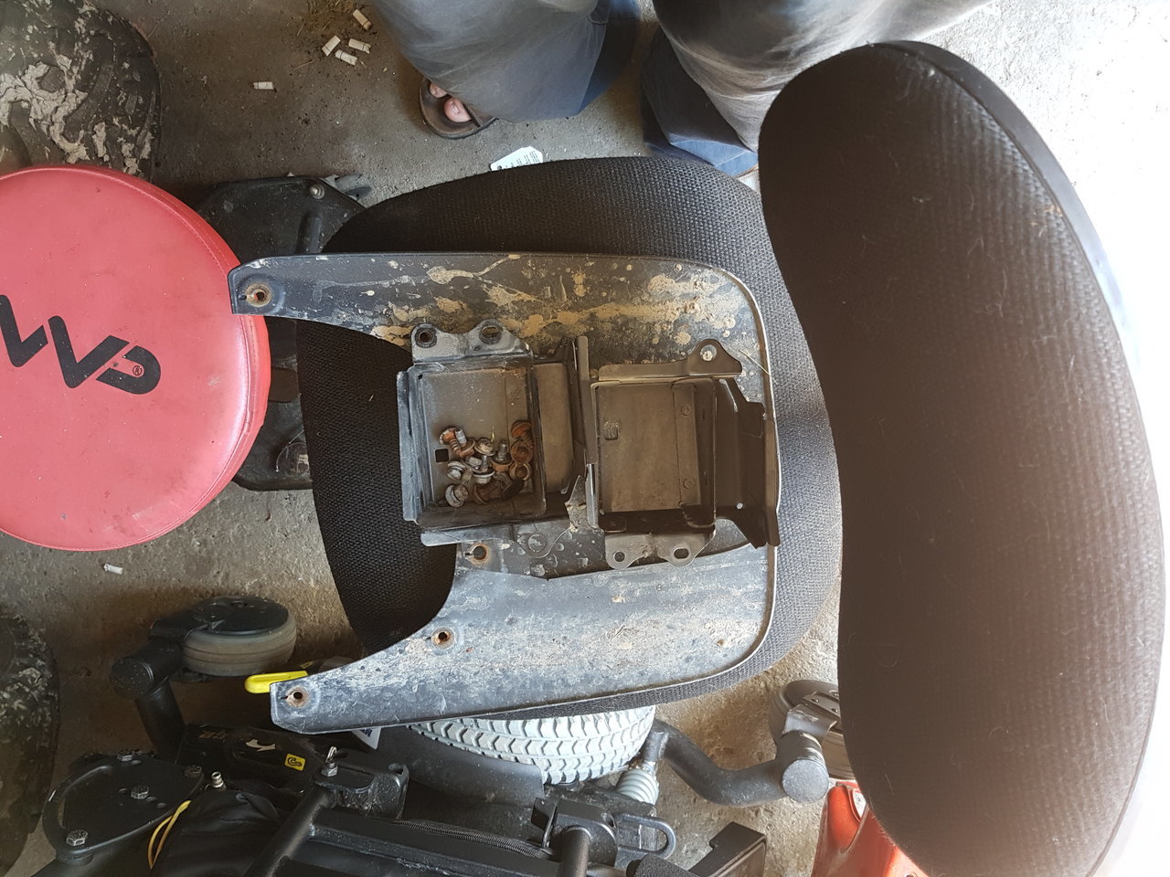

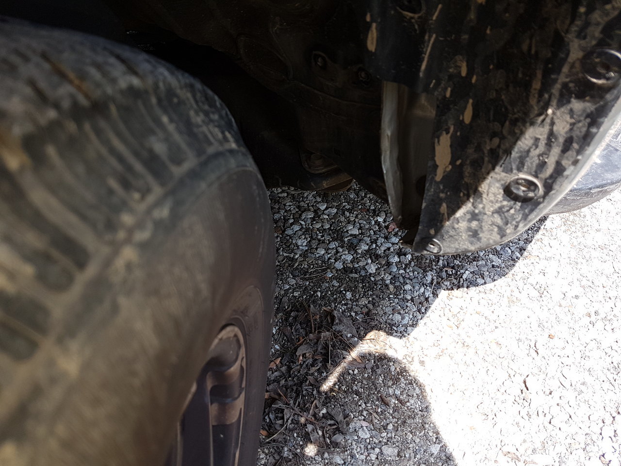

    So, I've only owned the truck for 6.5 years, and i only got around to this now.
    Consuming approximately a whole 20 minutes of time, the fender-well black-box delete and removal of rear mud guards was done, in prep for future work and tire-upsizing. The Rocker panels of both fenders were absolutely stuffed by rotting vegetative matter (see first photo of debris on ground) - prime conditions to induce corrosion in that little hidey-hole. I need to get some tin yet, and bash up a few patch plates to cover up those voids.

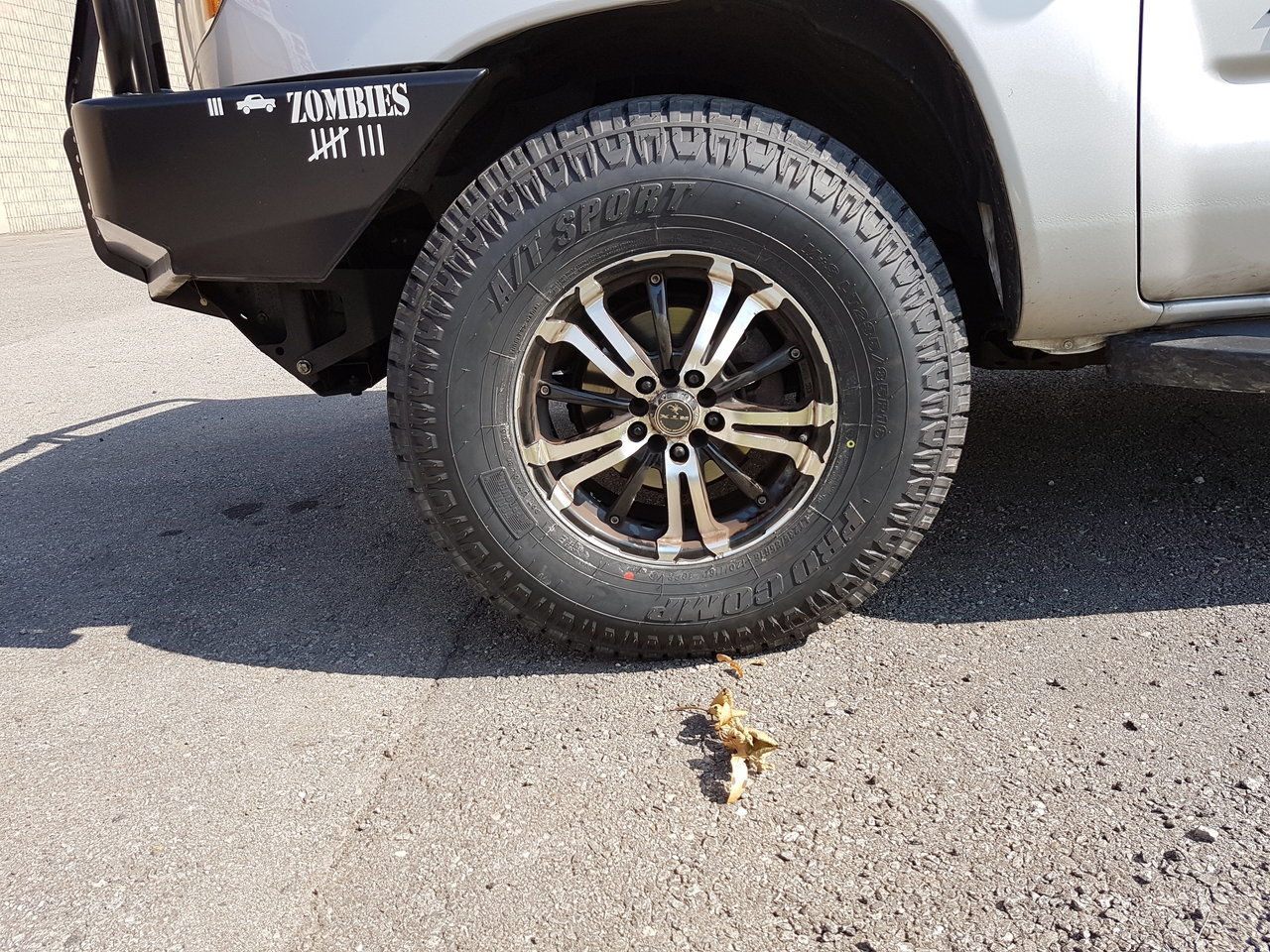

    Fresh out of 4wheelparts ... 235/85r16 (31.7") with the 4.10 differential re-gear and Eaton Detroit TruTrac LSD on the 2010 5-lug.. no spacers, no rubbing. My 1.5" spacers and fender flares will go unused.
    After starting into this project as a stock truck in Winter 2014 .. i'm now fully done on this truck's mechanicals and external changes. Well and truly happy with the end-results. Just the interior/wiring to finish off.
