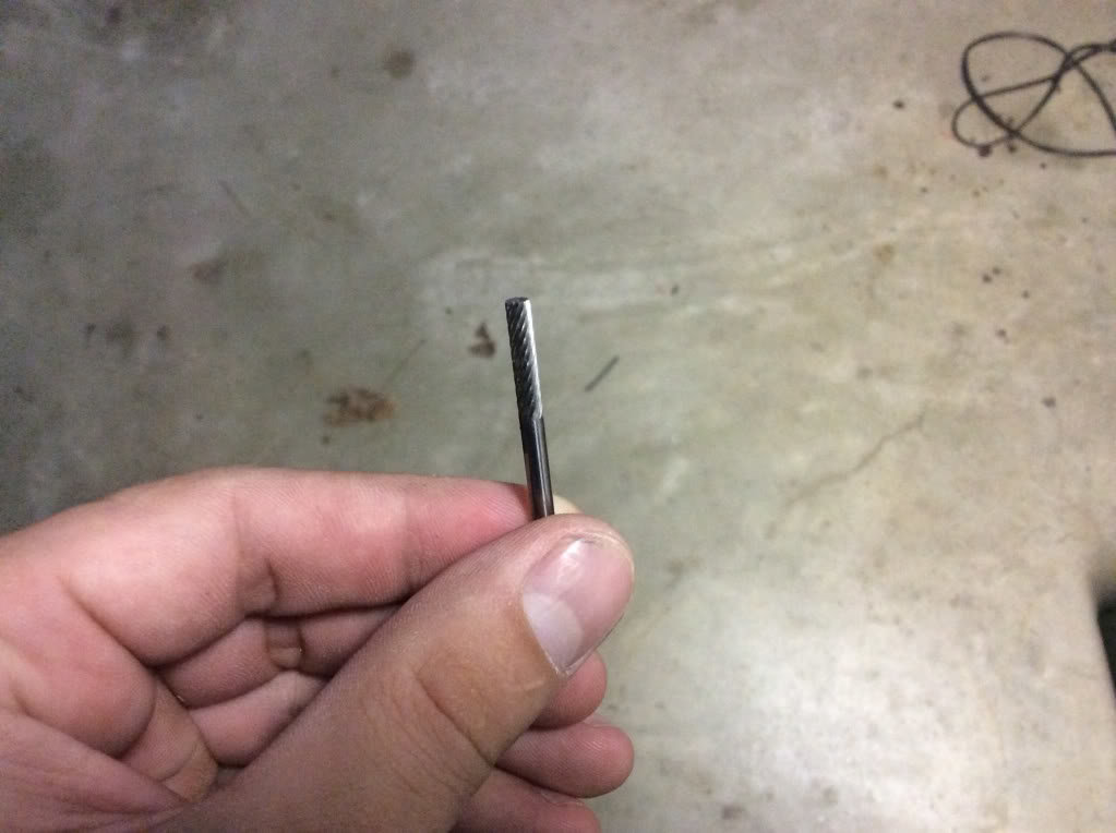

    I put that grill in a few months ago. What I did was carefully marked the edges with a silver sharpie and then used a dremel with this bit to cut it out.
    fbff815391170806386b57b5c45c0f33_zps1742_aa7cd05bedbc7a7bdca47170eee96346f0778504.jpg
    It was actually really easy. Now the shaping of the grille was a PITA.

    dremel with flex attachment and bit shown above worked like a charm for me
